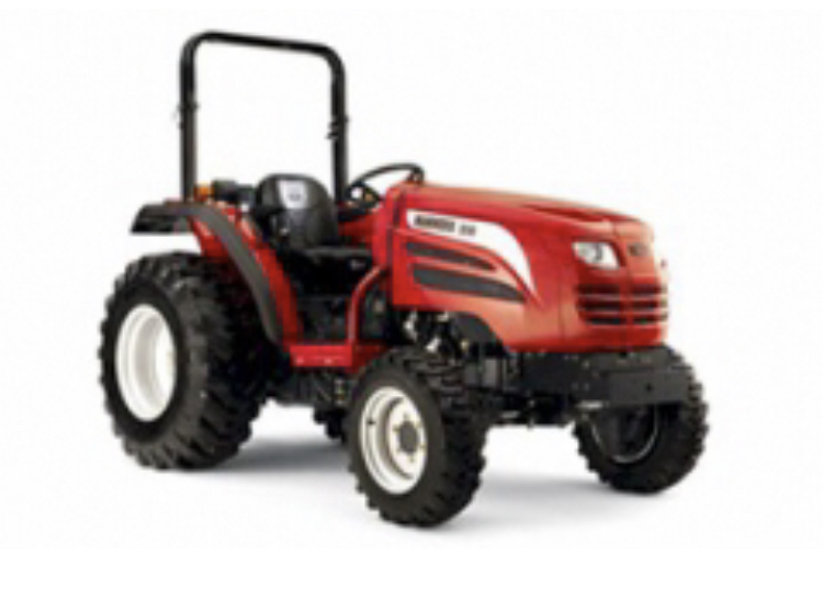

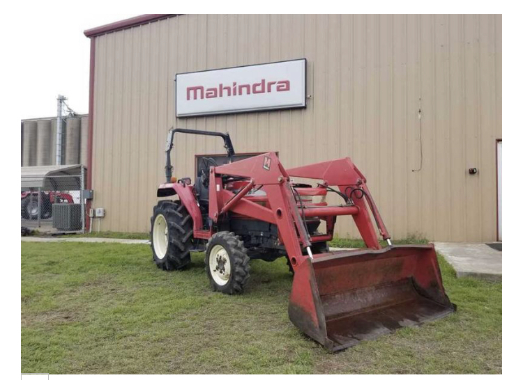

A easy way to tell the difference between the early and late is the sheet metal and grill. The “late” had a swooping rounded nose grill while the early were very boxy. Early also had a yellowish/tan rim while the late had silver. I have a 2005 late model with 1300hrs. It’s been an awesome tractor, no complaints.
Early:
Late:
