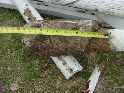

Thirty five dollar a gallon sealant doesn't work worth a hoot when the leak is because of a flat spot on the wheel that landed in just the right place to let the air out over night.
Folks ask why I'm going through all this just so I can drill into rock. Here's a shot of one of the old posts we took out.

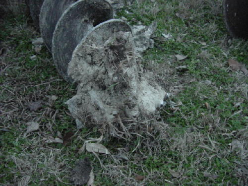

I shortened the arm and tried the new auger.
It didn't work as good as the old one did. This fence line has more clay before hitting rock and the new bit ain't worth a flip going through clay.
It was also a lot harder to align for the hole. It also had a tendancy to wander.
I'm sure it'll be great in the hard stuff.

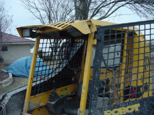

Here's the weights and arm after yours truly did a boo boo.

Here's Iris after the boo boo.

Yup, that Iris gave it up to protect me. She took the hit and I didn't, could've been a fatal it'd landed perfectly wrong.
One of the advantages of the skid steer is if you know your alignment is off a tad you can angle the auger to adjust as you go down.
I was next to an old post hole and the bit wandered into it. I did a quick adjustment to angle back to the new hole and the weight accented my adjustment.
I over adjusted to compensate for that. If I hadn't shortened the arm it wouldn't have happened. If I'd put in a safety pin it wouldn't have happened. But I did and I didn't and it did.

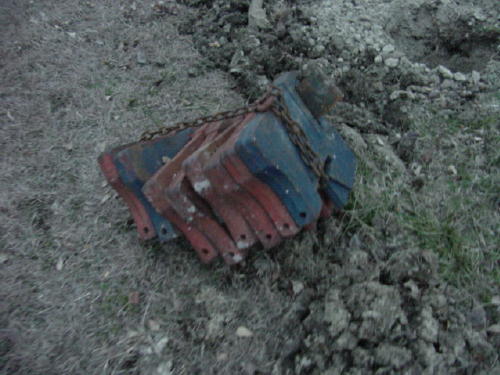

Here's the auger when I finally gave up and went back to the original one.
