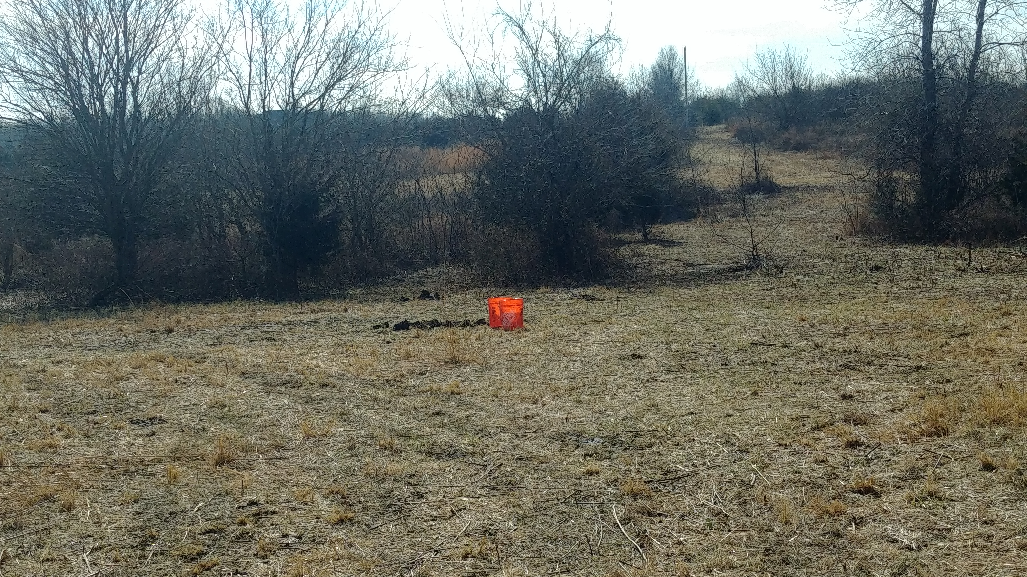

Hillbilly perc test completed to satisfy my own curiosity. It drains pretty good, between 4 and 7 inches per hour. I did some looking at the local regs for septic, you can install your own system but the county has to certify you, which may or may not involve testing. So this is probably best handled by a local plumber rather than me.

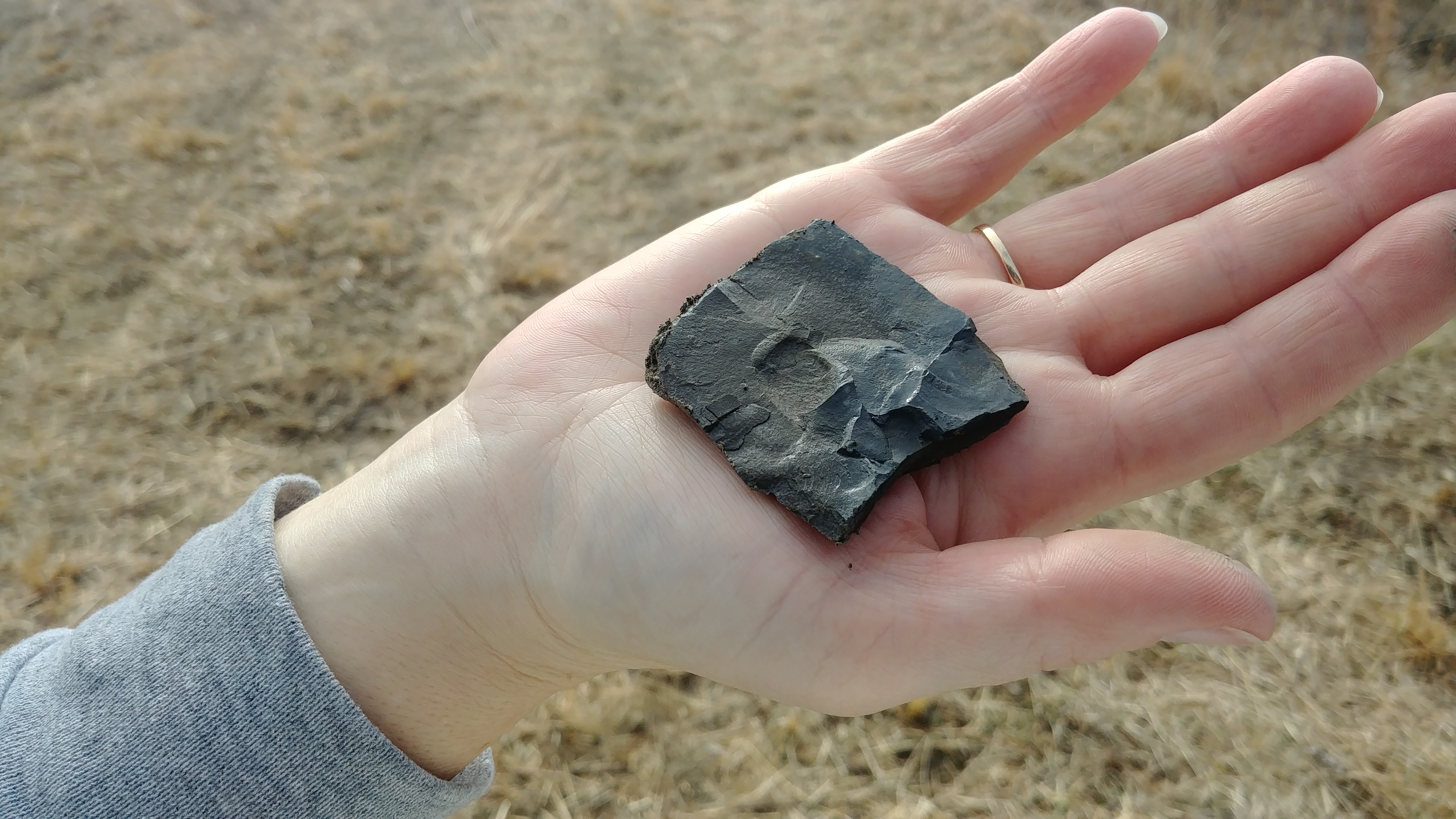

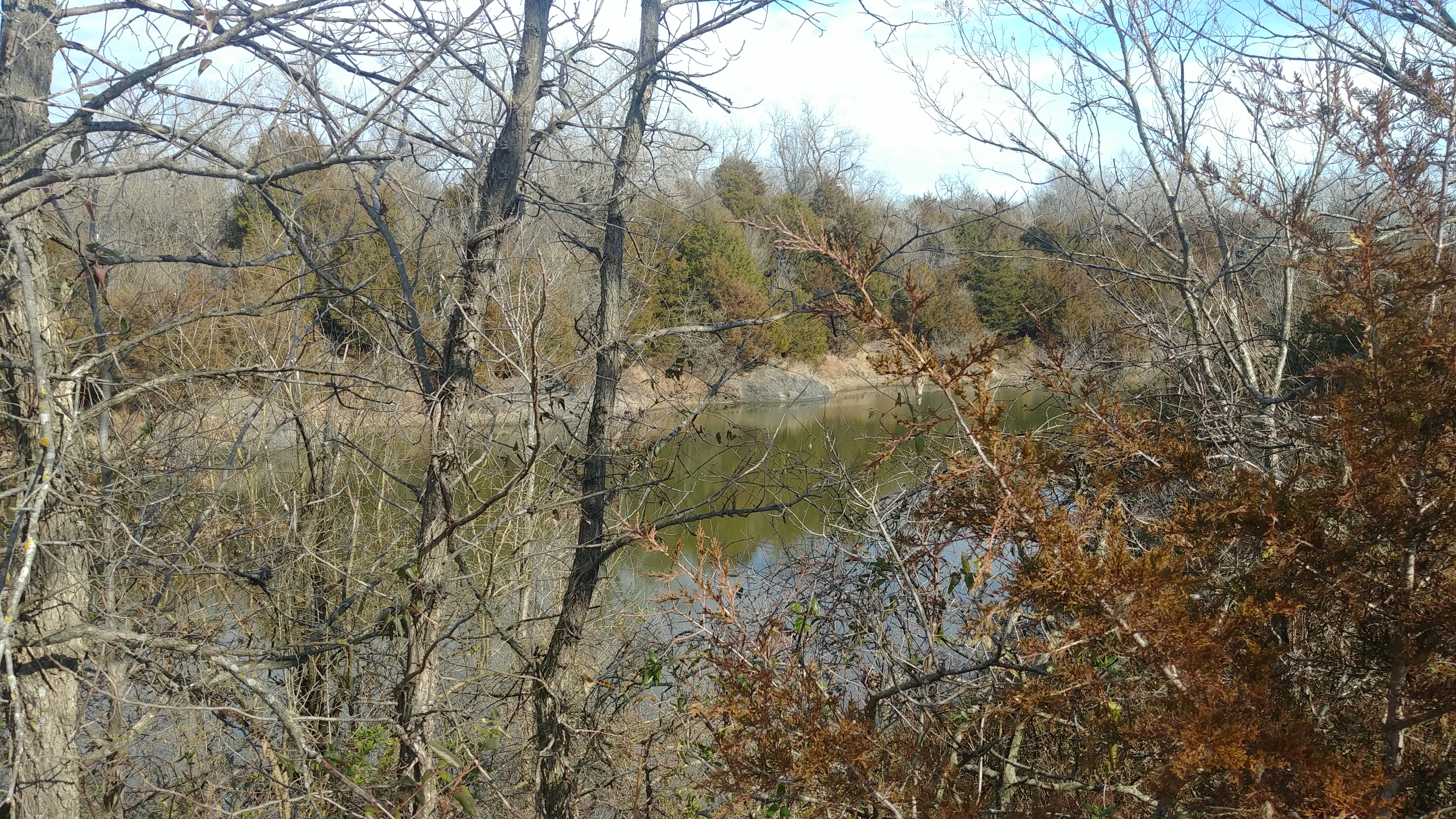

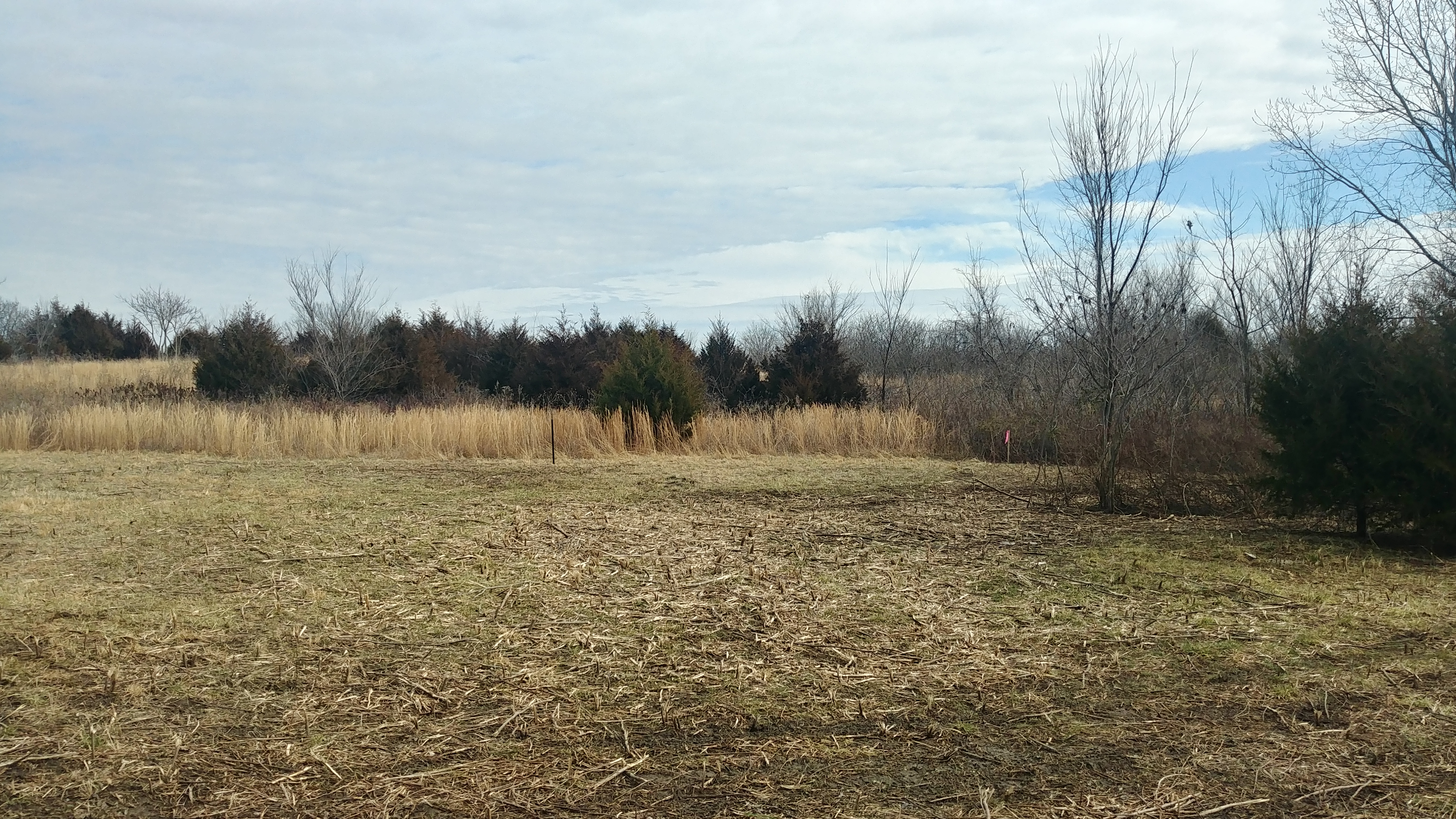

In the process of doing a little digging, we do have some stray coal mixed in with the dirt. The top about 8 inches of soil is decent and loamy then you start to hit clay mixed with some of the coal shaving below that. It was all fairly easy to dig in with just a hand shovel. This bodes well for the later projects of moving dirt. It may come down to needing to bring my buddy in with a dozer, but I am going to attempt it at least. We re-aligned the proposed house footprint a little bit while we were there as well, which will give us a larger back yard. About 50 feet now before it drops down to the water.

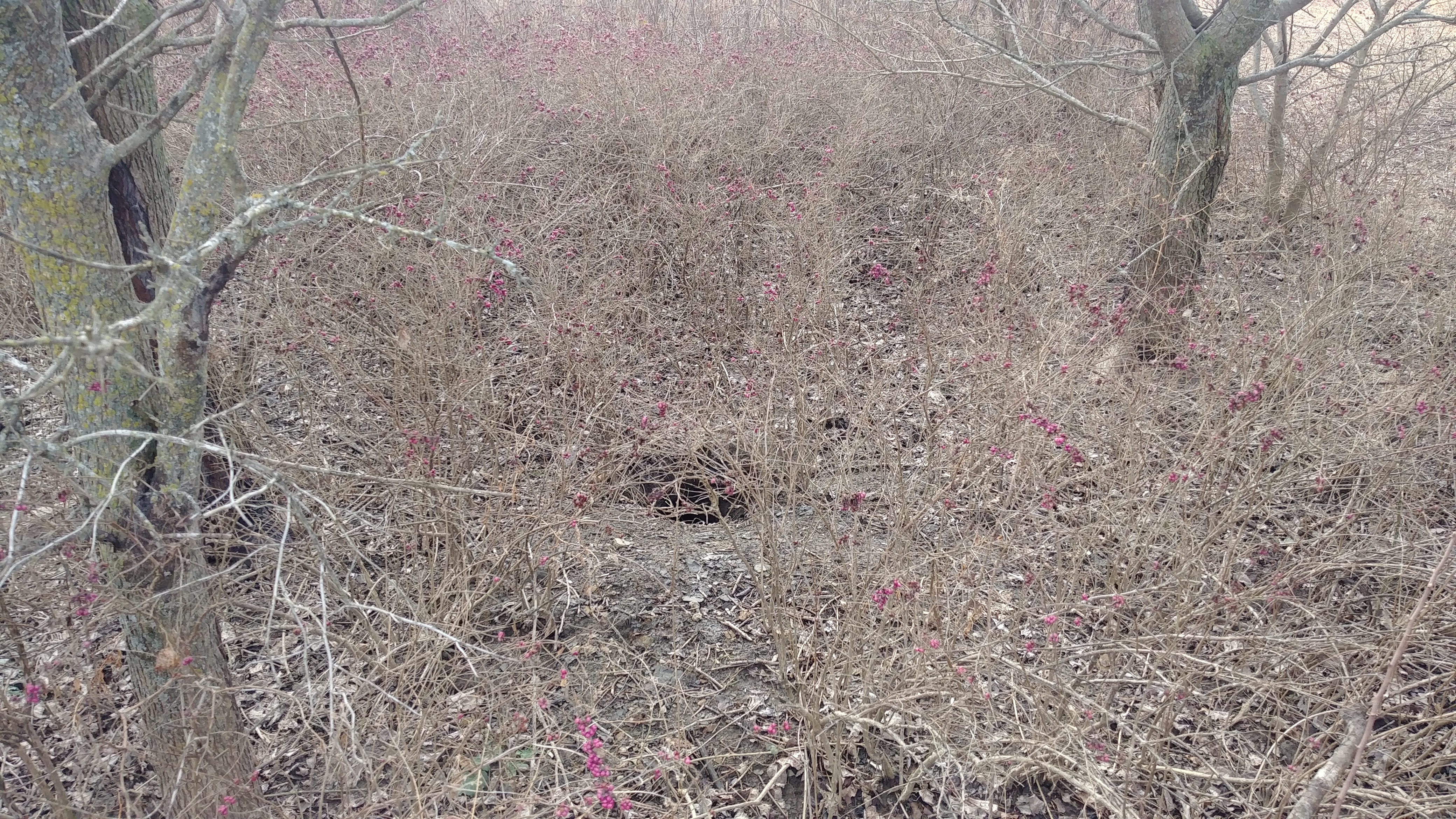

This photo is what the lot was like and what half is still like. I've identified some of the plants, weeds, trees, whatever. There is a lot of Sumac, blackberry, and multi-flora rose mixed in with native grasses. There is also quite a few vines mixed in among the larger trees. I'm not sure what kind those are yet. One grove of trees had what appeared to be nightshade growing under it and a huge hole dug by an animal. I don't know what dug the hole. Fox, rabbit, badger? :laughing:

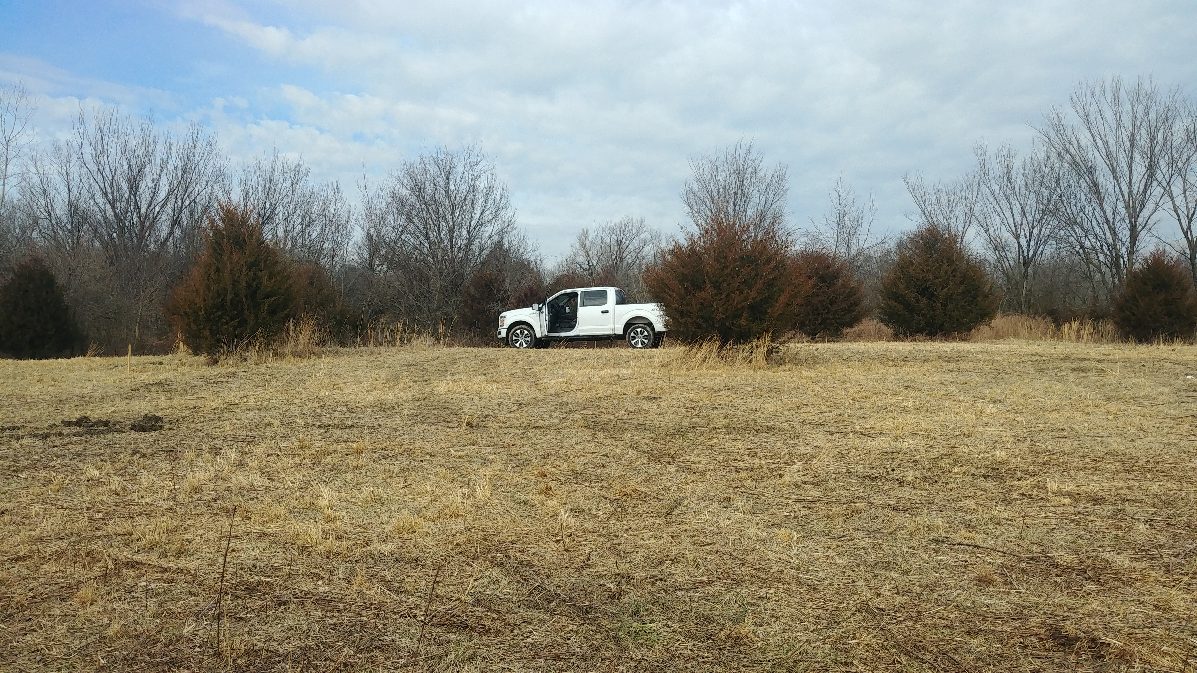

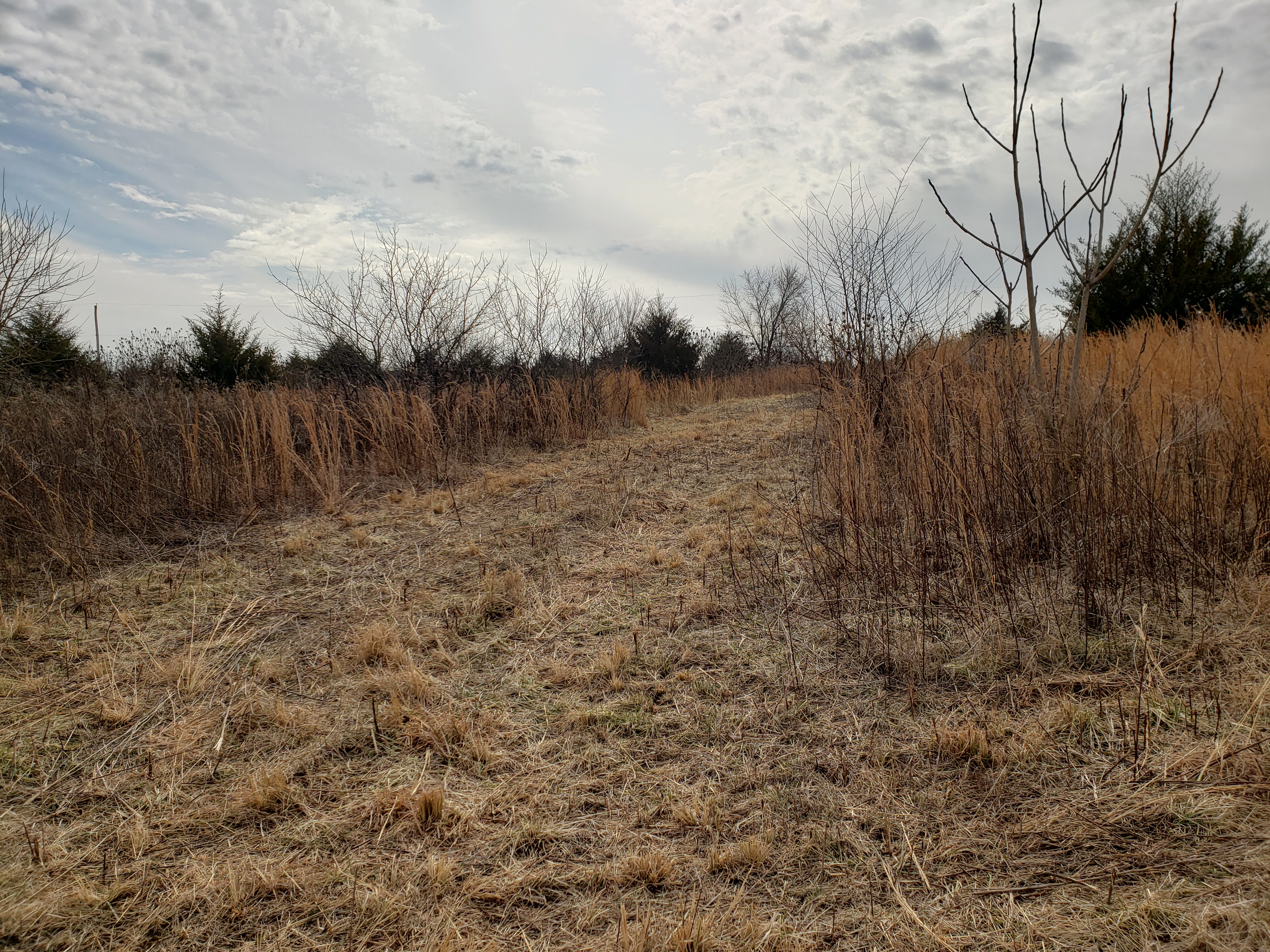

Few more pics of the proposed house site, I'm parked in the kitchen. Then where we are doing to run our driveway. I have about 8 cedar trees and a couple other small trees that I will need to be yanking out. That should be fun. I have some ideas on how to accomplish that without the need of bigger equipment. I'll make sure to do video in case it all goes bad.
