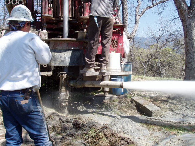

You just gotta keep the water flow up enough to carry out the fines. I got a lot of education on drilling rock when they drilled my well through 245' of solid granite. The rig would hammer hard through the solid stuff then spit gravel when it chuffed through the strata that held water. It was an amazing day that turned our primitive camp site into a homesite!
Just curious, how much is one of those drills?
Here's one of my favorite days ever:
