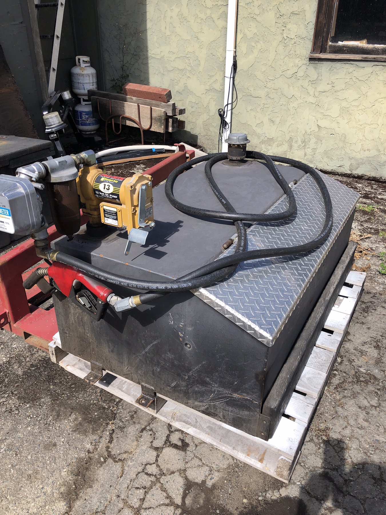

I overfilled my previous tractor once or twice using cans, then an electric pump with hose. For the past 10+ years now I use a dedicated transfer tank with electric pump and auto shutoff nozzle.

I have about $150 invested in my diesel fuel system but do not have an auto shutoff nozzle. Not needed in my situation as I can see/hear the level as it reaches full. It is a 50 gal reefer tank mounted on a wooden frame that I can lift on and off the truck. I can use off road diesel and save $.50/gal. It uses a cheap 12v transfer pump rated for diesel.
I use this little pump for my gas powered stuff. It works very well and it has auto shutoff. Works with gas and diesel. If I was younger, it is what I would use but I do not like lugging 5 gal containers of diesel around. I use more diesel than gas. The only downside is you need spare batteries but I have used it all year and still on the original set. It is slower than the 12v system but still better than using fuel cans with spouts. I hate those things!!!!

I am looking for something to replace gas cans so your post interested me. I read the reviews and decided not to risk it. Many people were not happy with their unit. You must have received one of the good ones!!
I've been pretty happy with mine - although it is not "exactly" the one I linked in the last post. I found mine on Ebay a few years back. It's small enough to manipulate down ramps from the bed of my truck when full. It beats the heck out of using 5gal cans with spouts. These things can run from the $200 range to much higher. I see no real difference in them except getting ripped off :)
At $200 I thought ... so what ... it can't be any worse than what I had before.
Edited to add: I think this is way overkill for regular lawn equipment. I only use this for the tractor to eliminate having to lift/slosh/spill the diesel.
