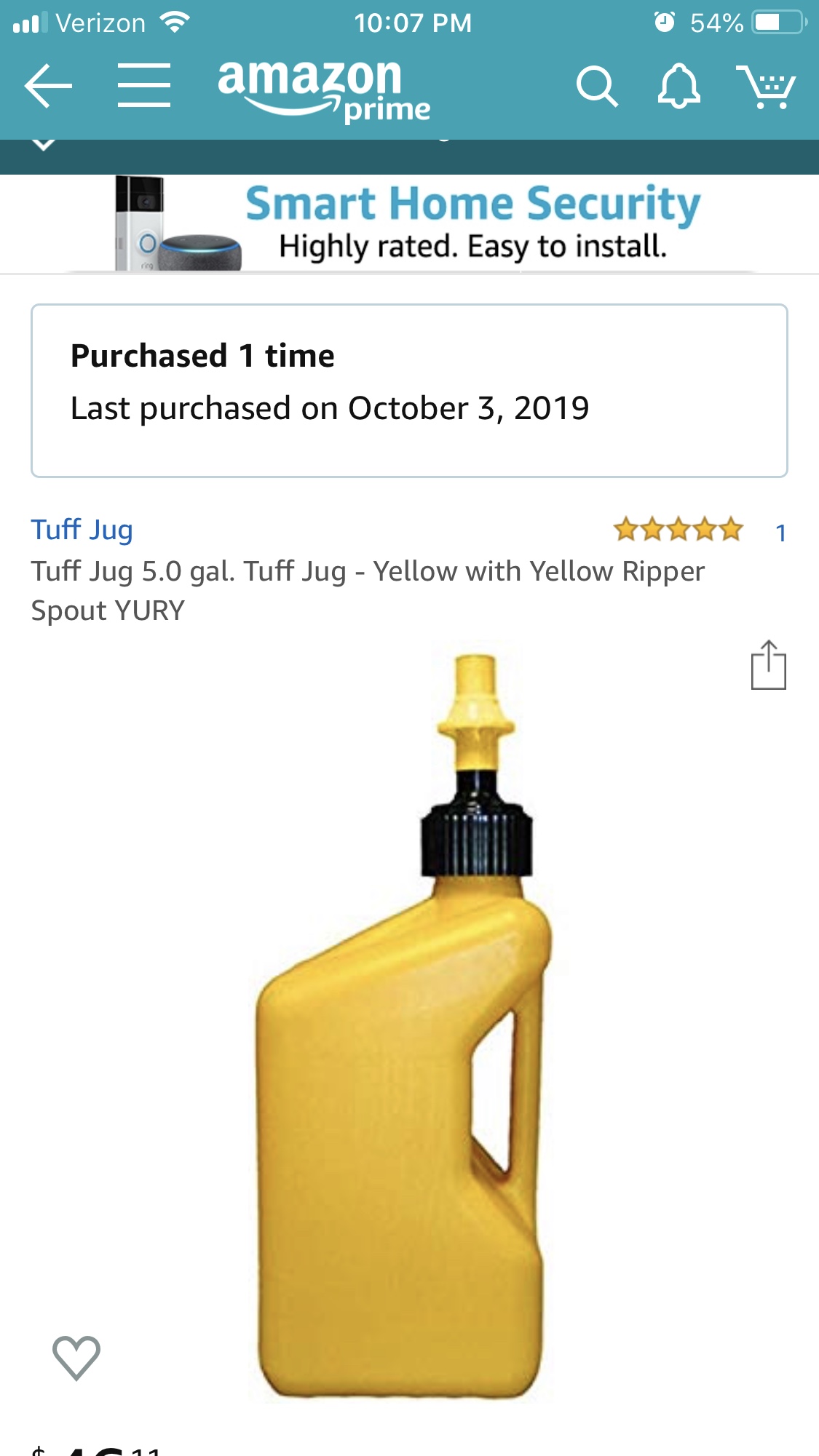

I receive my new B2650 tomorrow, and ordered one of these fuel cans. The nozzle fits the filler neck on the tractor, so I should be able to tip the can upside down and stick it in the filler. It won’t let fuel out till the nozzle is depressed.
Dump 5 gallons in 38 seconds...

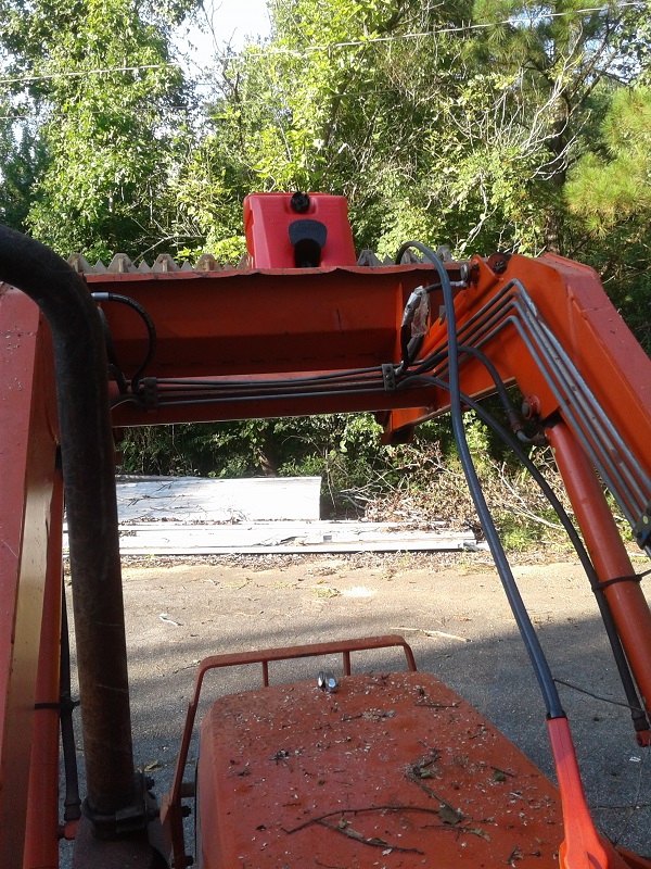

I find these threads on how to fill your tractor tank amusing.
Most of us have FEL's.
For small quantities Jim's method seems the way to go. I've been doing similar for years. Although I use a longer hose. And sometimes a 14 gal fuel transfer tank.
I use a WW11 Jerry can rescued from a rubbish dump many years ago. I use a shaker to which I have replaced the outlet tube with a 6' length of tubing originally intended for an indoor fishtank.
Fill the jerrycan next time I'm fueling up the car, place the full jerrycan in the bucket of the FEL. place the shaker in the jerrycan and run the tube to the tractor fueltank which in my case is behind and under the seat. Raise the FEL so that the inlet of the shaker is above the level of the fueltank. Start shaking. Go inside for a coffee. Minimum lifting; maximum relaxation.
