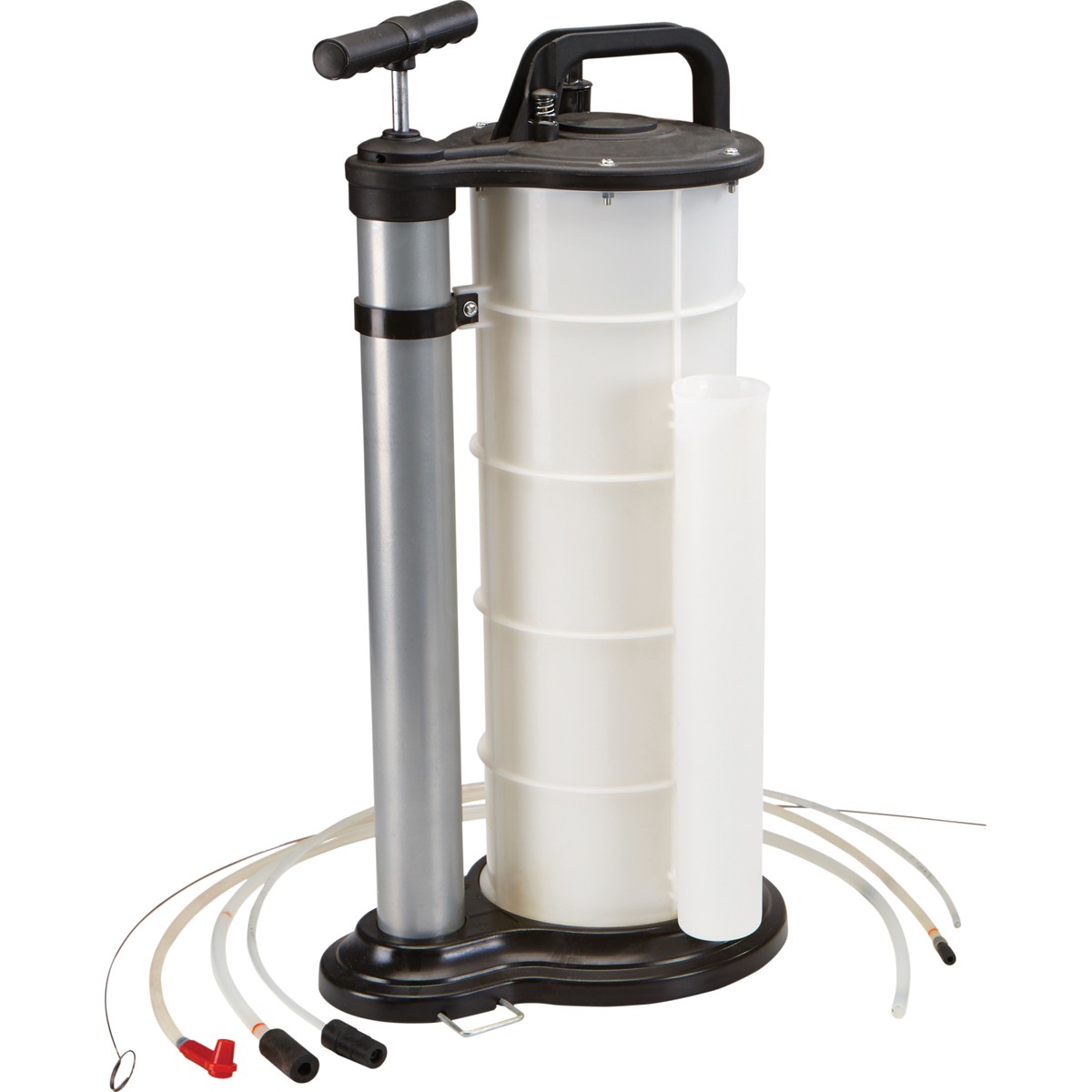

Mine is made by "Alemite" but for the purpose of this discussion I use something similar to this one. (since you're all posting HF links I searched and this is nearest). 2.3 gal. Manual Fluid Extractor :thumbsup:
So useful for so many tasks. Sucks oil from your engine up through the dipstick tube. Just get your engine nice and warm so the oil flows easily.
In the mower gearbox you can angle the tube into the corner and gets nearly the last drop.
Small engines where you get dribbles by tipping oil or draining across the chassism the mess is prevented by sucking out of the fill tube.
They even store the oil until you can get around to disposing of it.
Different diameter tubes for different jobs. Good, also, for vacuuming the water from the bottom of your fuel tank.
:2cents:
