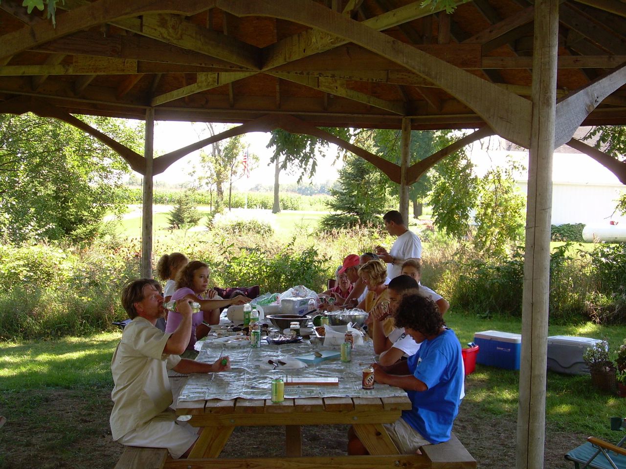

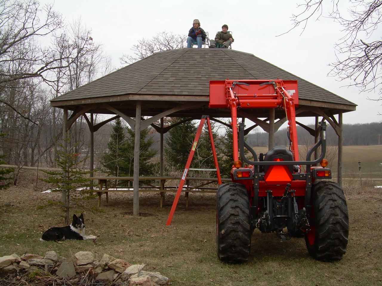

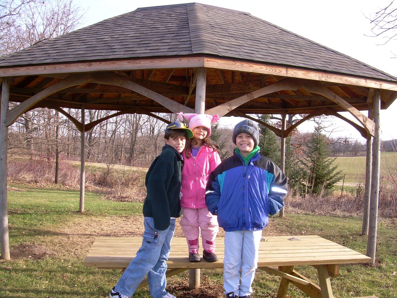

I built this gazebo from tamarack logs and scrounged building materials four years ago, it took 5X longer than anticipated due largely to the "natural" logs; nothing can be plumbed or squared :rolleyes: I am a carpenter by trade and it just drove me nuts...... I would never go that route again but for aesthetic reasons. 500.00 sounds cheap to save all that grief.
Hey Davitk, by the looks of your gazebo you have clearly demonstrated your carpentry skills in overcoming the challenges presented by the tamarack logs. Good work and a nice looking project that will surely provide you and your family years of enjoyment.
There you go Kossetx, see what you can do with natural logs.

Davitk, Very nice indeed! You understand what I was saying about square, and I'm not as good a carpenter as you.
I've decided to use the native post and build I'm gouing to build smaller the first time. 20X24 or 20X30. I can always add on or build another later.
Thanks for those pics and thanks to all who replied.
