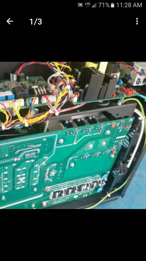

It looks like I see a problem in the first picture. To the right are heat sinks with electrolytic capacitors in front. If the tops are buldged they're bad. Replace same values, same polarity. (Super important)
Take close up pictures before removing, board probably is screen printed once removed. View attachment 639441
Huh? There wasn't any problem with the unit. Just documenting some things at the time for future reference.

Sorry. I didn't read the entire thread. Just trying to be helpful in that electrolytic caps don't like heat. I thought this may help someone, something to keep in mind. An inexpensive repair for an expensive board.
