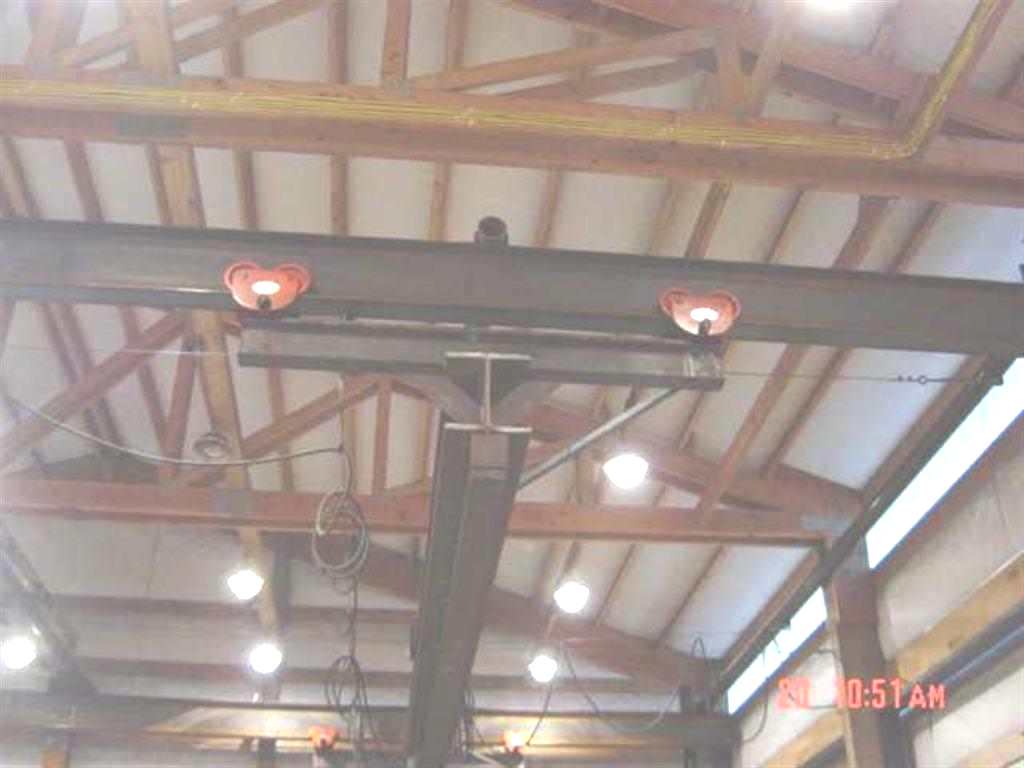

His Tees would be easy to hang if he welds on straight pieces of thin bar steel as mounting tabs. I hung my rolling bridge crane by welding tabs to the top web - worked real well. Much easier to weld to the vertical web that he has.
I had to make the 20' beams be closer to 23' so i had to have welded on a short piece with thick steel gussets on both sides of the web and top and bottom as well. Not ideal but it works. But for short pieces, you will spend more on gussets than getting a good used beam.
But I also did not trust my amateur welding for something above my head like that.

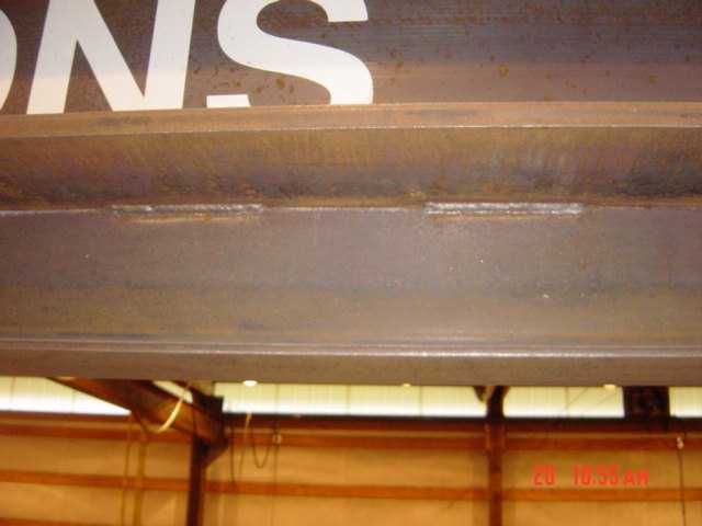

I ripped a 12" x 31.8 # S-Shape for the trolley to run on for my crane, I skip welded (6 on 12) it to a 12" x 87 # WF, for a 24 feet span. I used a tractor torch to rip the S-Shape.
Very nice job!!... But that is a little over kill for an elk/deer, :laughing:. Thanks for the post, KC :D :D :D

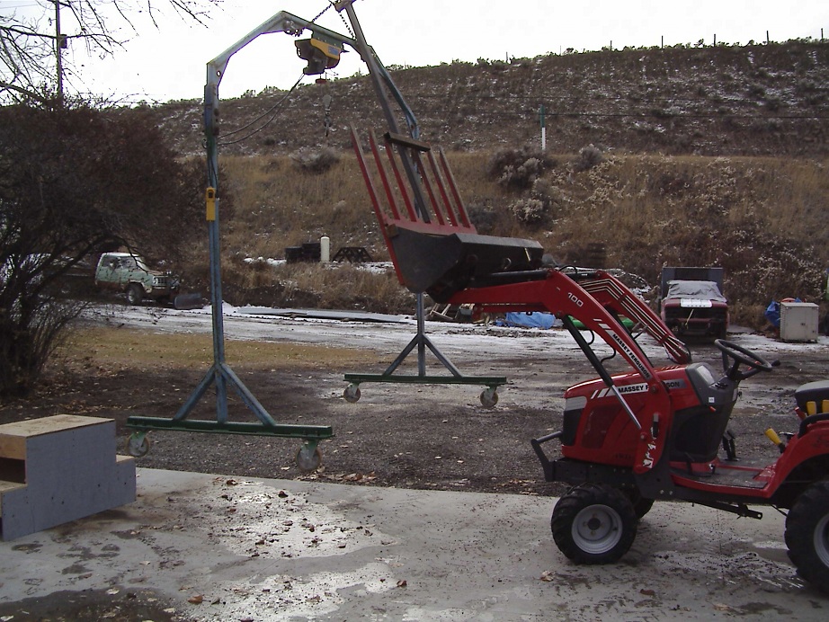

You might be surprised! That crane is only engineered for one ton. The rails are the weak spot between the post. The center of the span beam is the strongest point. Things like this happen when you use scrap material.
There are a lot of factors in building and working with cranes, spans, and radius can bite you if you are not careful! ;)
