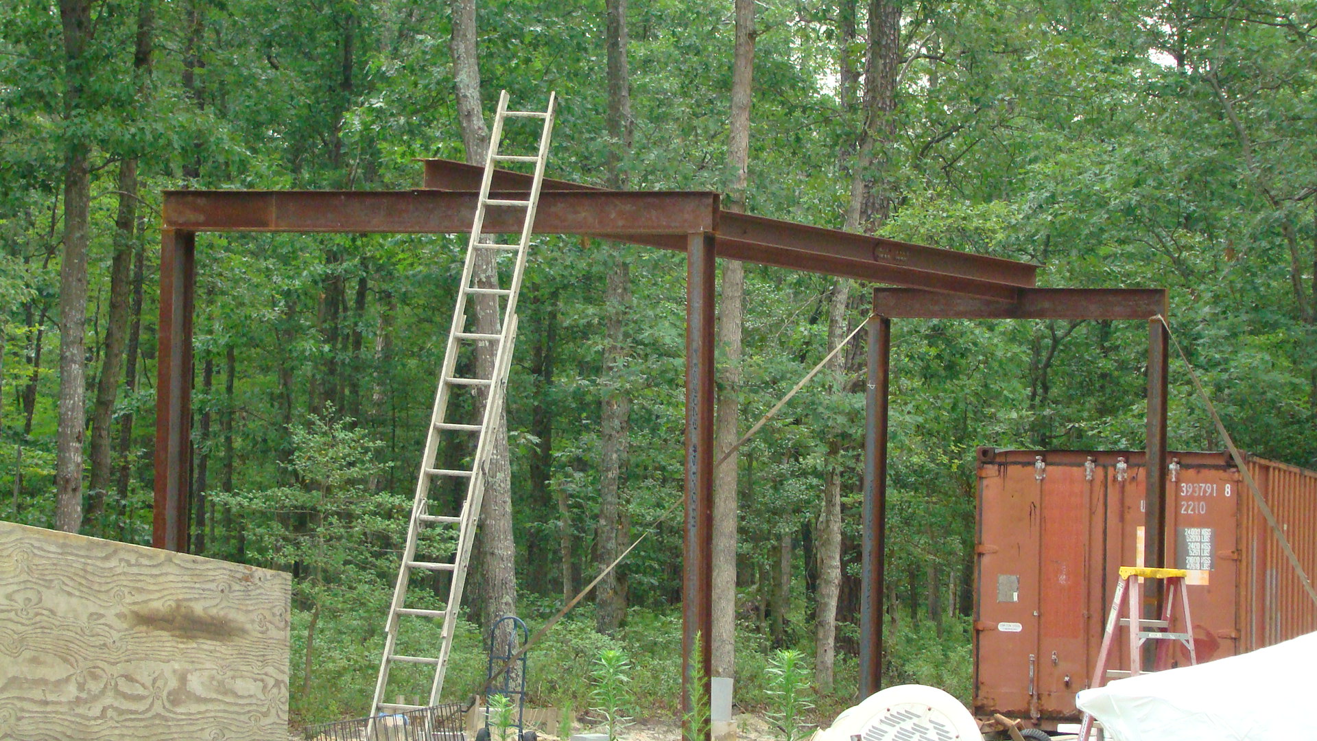

My 2x4 wood trusses are 2ft OC. I might even add some additional strength to the trusses if it looks like they need it. I have been thinking more about the 2ft WF beams I have, think I am going to cut them up and use them instead of the 2x2x1/4" angle at the top of the tee sections.
I may be missing something, but I do not see a failure due to hanging a elk/deer. I have hung animals on the trussess by only laying a 4x4 lumber accross the top of two trusses.
For my 15ft tee section inlcluding mounting tee brackets/threaded rod + 4x4 lumber spanning 20ft + HF trolley + HF chain hoist = 275 lbs. This is going to span 11 2x4 wood trussess that are 2ft OC. Now looking back, kind of wished I did not even post about this, :confused2:. Thanks for the post, KC :D :D :D
Don't get all down in the dumps over this. I'm always doing projects and most of them I do with stuff I already have on hand. Some times people do get a little excited when you are talking about overhead beams that will be used to move material around. There are dangers in everything you do and you have to ask yourself if what you are planing to do pushes the limit a little too close for comfort. I have no doubt that what you are planing will lift a 100 or 200 lb animal without problem. Heck just throwing a 1/2 nylon rope over one of the truss would do that. The danger is, what's to say one day someone comes in and sees this nice beam with a 1 ton chain fall hanging from the ceiling and decides to lift the front end of his truck.
The problem comes into play and red flags start to fly when you start talking about hanging a 1 ton hoist on a beam that has been made out of 4 or 5 pieces of material that has been cut and welded to a length that will span 24'. On the surface that sounds a little shaky so you shouldn't get flustered when some folks let you know there may be a better way to do it.
Having said all that you and only you know your talents and the limits of your abilities and the intended use of this project. Are there better ways to do what you want done....probably. Is there a chance something awful, death even could happen to you or someone else you know if things go bad a few years down the road....maybe. You are the one that has to make that choice.
I'm laughing at myself right now as I remember a project I did not too long ago and the frustration I endured when I went to the world wide web for some basic information about welding beams and fish plates. I got shunned from the miller and hobart sites and one or two of the site know it all made it their mission to poke fun at me anytime I responded to or started a new thread and it got to the point I don't even go there anymore.
I had several pieces of W19 beam that I got for free from where my son works and I wanted to put it in my pole barn to put a roller dolly with a 1/2 ton chain fall on. I never intended to use it for much more than unloading a truck maybe 300 or 400 lbs max or raising the front end of my lawn mower to sharpen my blades, nothing major. I just wanted to have it so I could pick up stuff at the front door and roll it to the back of the building. Holy crap! you would have thought I was planing to lift little kittens and hoist them over a pack of hungry wolves or something.
The point is, I wasted almost 3 weeks of my life going back and forth with these board know it all engineers that all said the thing if I built it would crumble and fall under it's own weight until I just said to heck with it and went on and built the thing so I could start my building. It hasn't fell down yet and it didn't fall when the last hurricane blew over a giant oak tree that hit the building and slid down one of the post that holds up the beam. In fact if the beam had not been there it is likely the tree would have knocked out the whole front wall rather that just half of it when it fell.
If you have to use what you have I wouldn't be worried about cutting the beam with your torch, if you were going to cut a 40' beam and piece it back together then I would worry about it warping but the amount you are going to get with these short pieces is not going to amount to that much to worry about. The biggest problem I see is the weight you are going to be hanging from the truss but even that spaced out along the 24' wouldn't amount to much unless the for some reason the roof system happened to get loaded beyond it rated capacity by a big snow or ice storm.

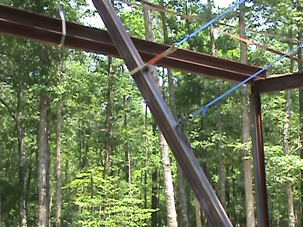

Hehehe yeah boy, that was a doozy. He even followed me over to the Hobart site and started right back up where he left off at Miller. The sad part is the old fart probably knows a heck of a lot about this stuff but rather than offer up suggestions he likes to scold people that may just drop in looking for a little help. The old boy probably would have had a heart attack if he had seen the way I had to get that iron up and the beam sitting on top of it all. To be honest I still can't believe it myself, that I got that big heavy beam up there with the setup I came up with. But.....a man has to do what he has to do sometimes to keep the ball rolling. :laughing:
