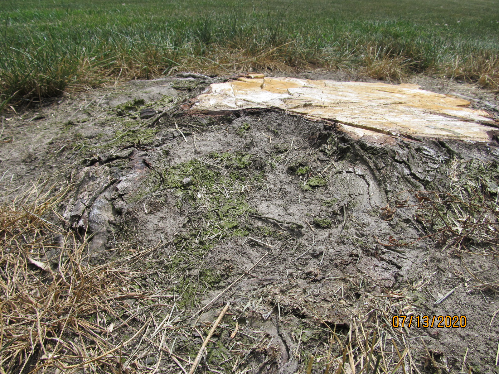

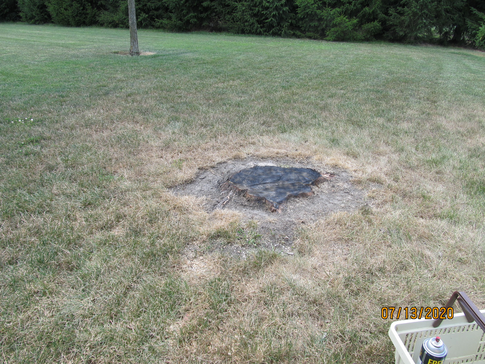

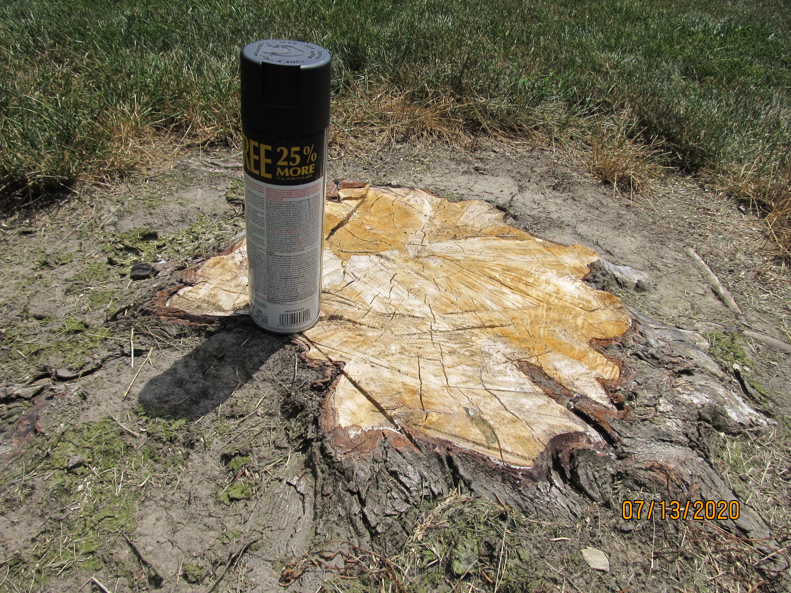

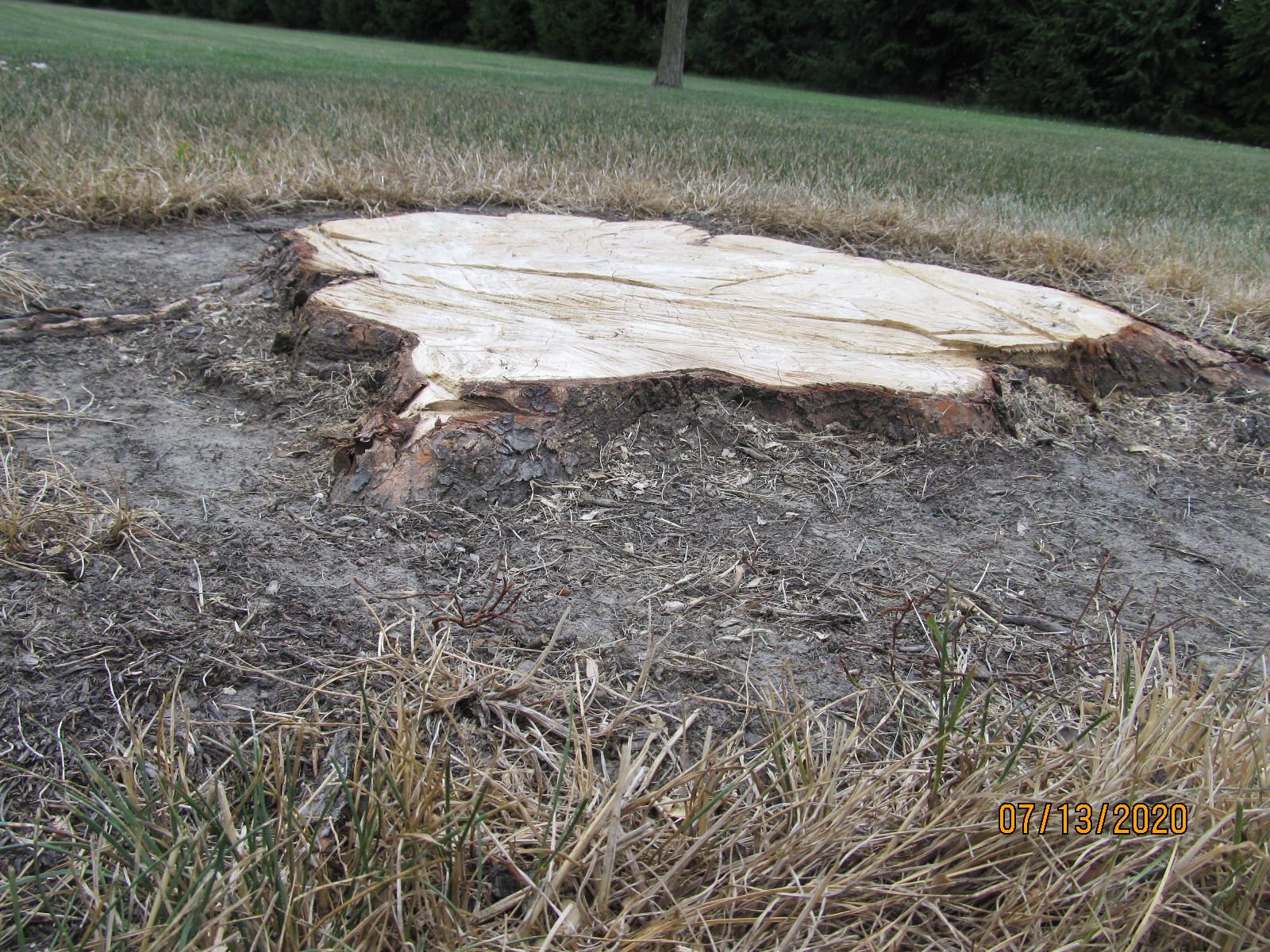

Easy way to get rid of tree stumps in the yard. Just cut it flatter-than-flat to the ground, keep saw out of the dirt and coat stump with Roundup to kill it. Paint stump black so it's not so obvious to the eye and a year later burn it with a hardwood fire and a leaf blower. Low to the ground means I can mow over it with my 7' pull type mower right now.

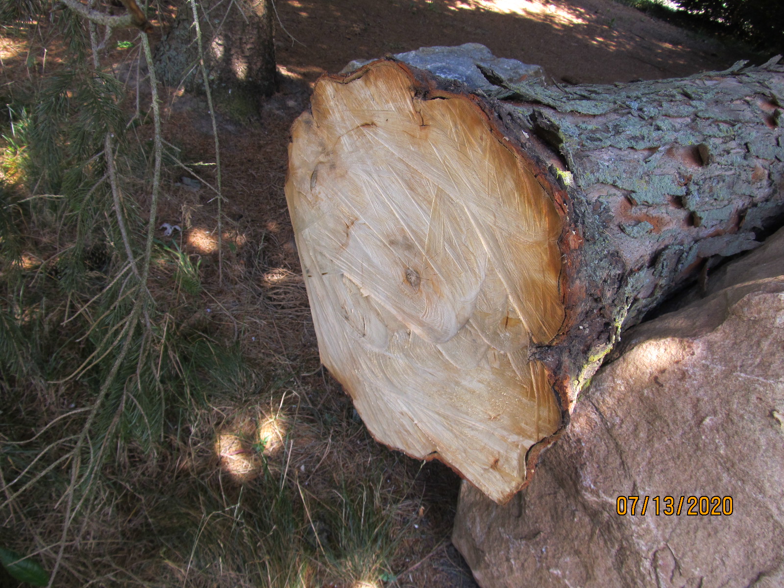

Here are some pics. The trunk piece shows that I cut a kerf around the outside first and then kept nibbling till I got to the center. Need sharp saw.
Below is a stump cut last year that will be burned when or if it ever rains again.

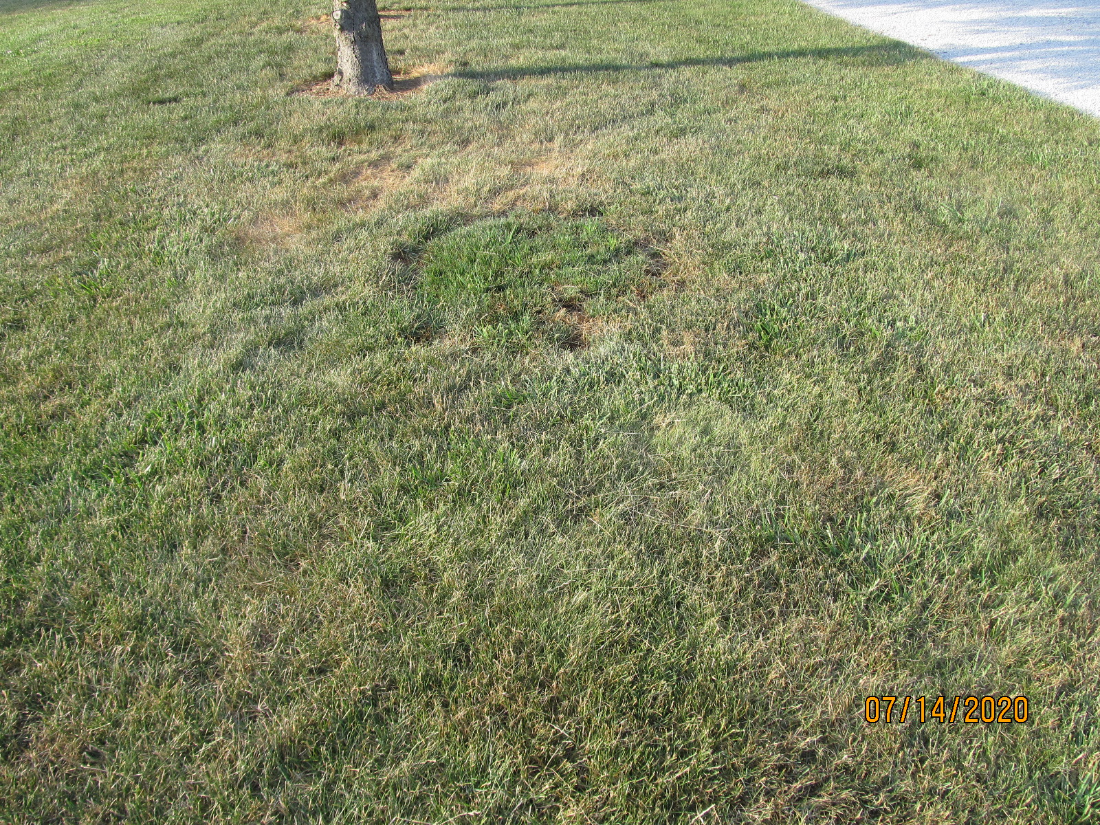

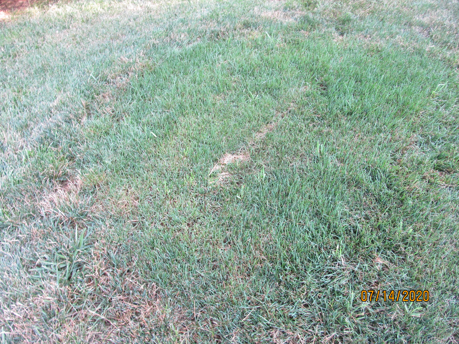

When I burn, I start the fire and push coals to the outside of the stump. Hit the center with a leafblower and it burns plenty deep into the ground. No backhoe mess, just blow cinders and ash out, fill with dirt and seed. Close enough for gov't work.
These are from similar efforts this spring. The second pic was a 16" or bigger soft maple.

Good work. Yeah, you either have to cut them very low like that or leave them up so that you don't hit them with equipment. Just have to coat around outer edge with herbicide where the cambium is. I've never burned them. They eventually rot out.

I've been doing that for quite a while. What I'm finding though is that over time, the ground settles or washes away with rains, making the stump 'rise' up out of the ground. I've had to cut several down a second or third time. Lately I've been drilling hole in them to help promote rot.

I bought a DR Stump Grinder a few years ago, and have eliminated scores of stumps with it. If the stump is about 6" tall you can grind it down below ground level, shovel the dirt and chips back into the hole and that one's gone.
