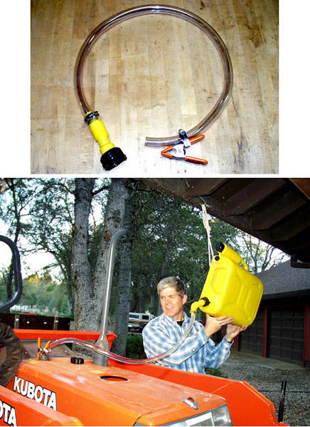

I keep a rag stashed between the fuel door and the fuel cap. I whip it out and spread it on the hood in front of the fuel door. Then I bring the 5 gallon container up onto the hood and sit it there. After opening, I insert a kero siphon bought at TSC to transfer the fuel from container to tank. You squease it a few times to get it going. Lift it up when tank is full and let drain down.
Remove container, put tank cap back on, put rag back in place and close the fuel door.
Works for me. Don't have to stand, holding a 40+# container of fuel in the air. I only pour from the container when its level is too low for the siphon to work.

Here are some options for tightwads, such as myself:
1. Get a fuel transfer pump such as this:Northern Industrial Tools Lever Action Drum Pump |Barrel + Hand Pumps | Northern Tool + Equipment There are other choices, such as the crank type. Get a drum of a size you are comfortable with. Attach hose, insert pump into drum, fill drum, pump into tractor. However, if you are using gas, you need to use an anti-static hose.
2. Get a small step ladder. Get multiple fuel cans. Fill cans only to 4 gal. to minimize spillage when you tip to pour. Stick a funnel in the tank, so you can't miss. Climb ladder & pour. I fuel my airplane this way and have for 10 years, no problems.
3. For the gravity system, use a block & tackle or chain hoist to raise the can or drum, whatever, above you tractor tank.
