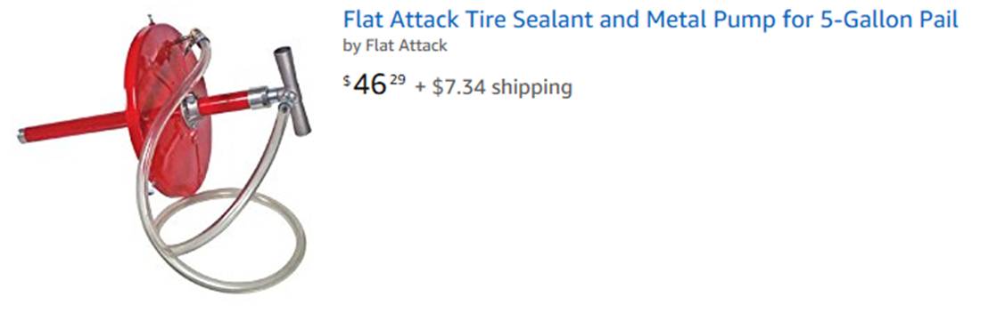

I really like these pumps for transferring heavy fluids. Kind of pricey but they pump 8 oz per stroke and make fast work of moving a lot of oil. They are advertised for tire sealant but also do well with oil.

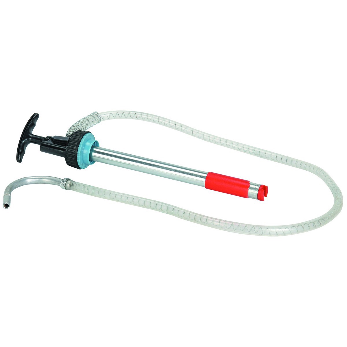

I just did my hydraulic oil a few weeks ago, 17 gallons, I have a hand pump that goes into the spout on five gallon buckets, works really nice. This one is from harbor freight and looks just like the one I bought from a local farm store.
5 Gallon Oil Pump
