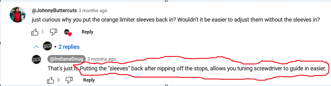

Airbiscuit,
Thanks for the video. I've seen another that the person made no effort to preserve and reinstall the plugs after shaving the limiter tabs. Interesting.
   / Echo 2511T is an amazing saw! #129
In the comments
   / Echo 2511T is an amazing saw! #130
Yeah, I tossed the limiters and wish now I hadn’t. It is kind of a pain to get to the screws with the saw running. Not a huge deal but annoying nonetheless.
