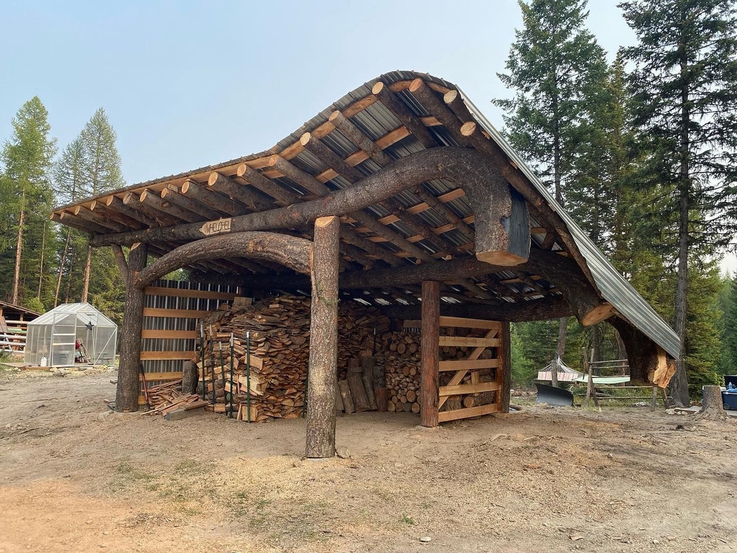

I saw this photo on another site. Cool use of cull trees for a firewood shed.
Eddie, I found your next project. Do you have any of these trees at your Tyler place?

Pretty cool, but I wouldn’t trust that in a strong wind storm.
