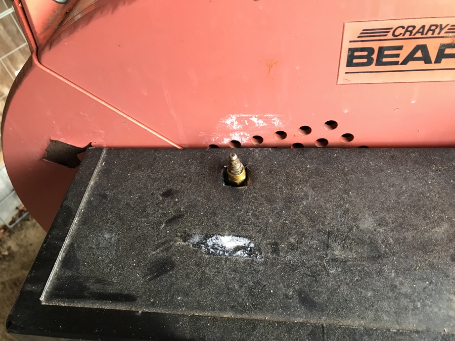

Are you speaking of the manual when you say it's not detailed? Yes, you are right about that. As I recall, it's mainly about the trailer model and gives almost no info on the three-point model, among other issues.
I found greasing to a bit of an issue. The front bearing on the flywheel shaft is hidden under the belt guard, which is a pain to get off. So I cut a small hole in the top of the guard and extended the grease fitting with some pipe fittings:

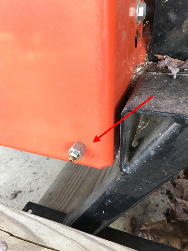

I also had trouble getting to fitting on the end of the lower shaft -- the hole provided in the frame is too small for any grease gun I could find. So I extended that one with some hose to a spot on the side of the frame:

I found the hose and fittings for the lower one, and adapters, at GreaseExtensionHoses.com -- not cheap, but having the right parts made it easy. The fittings on mine are 6mm, not an easy size to find around here.

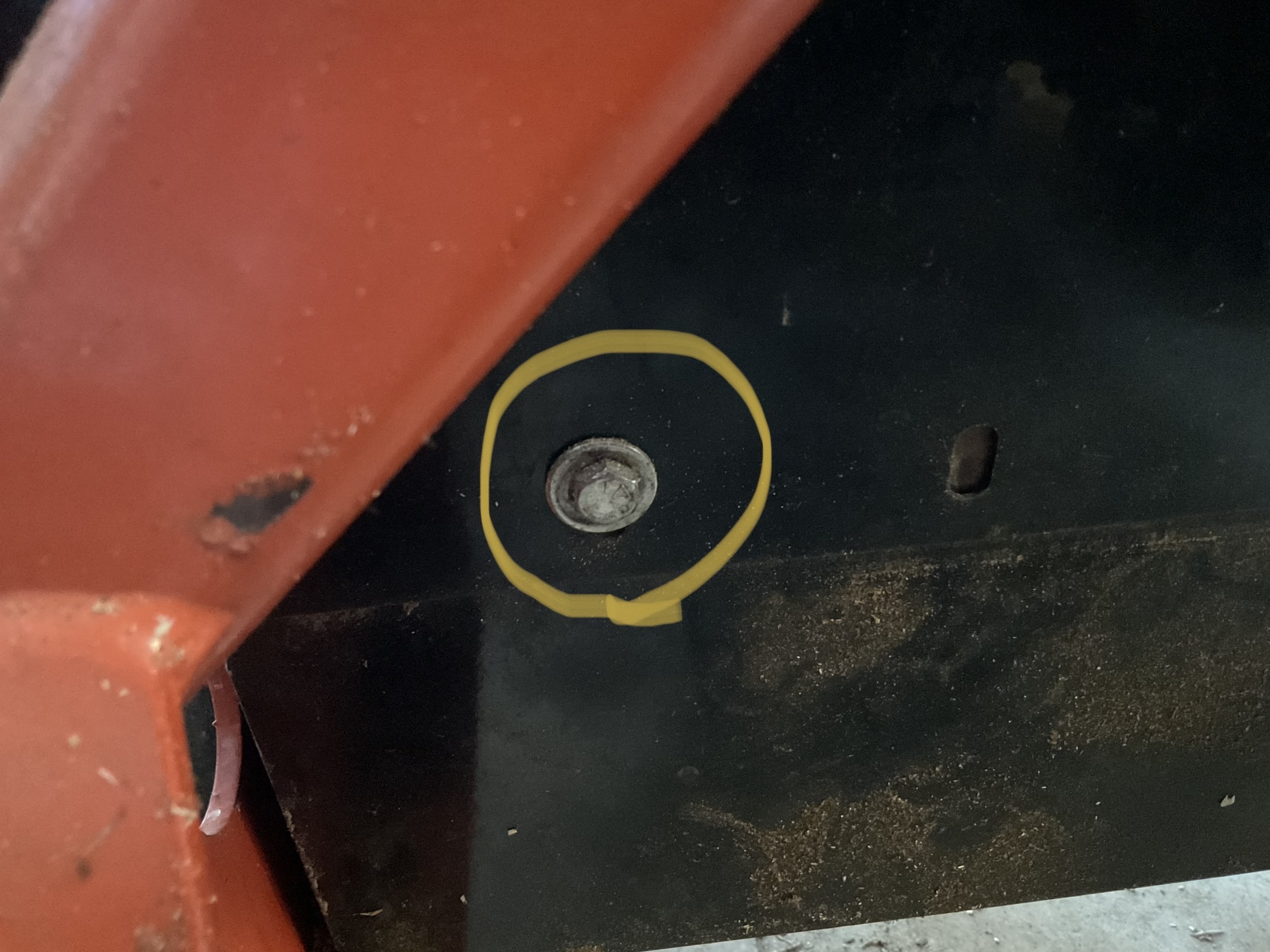

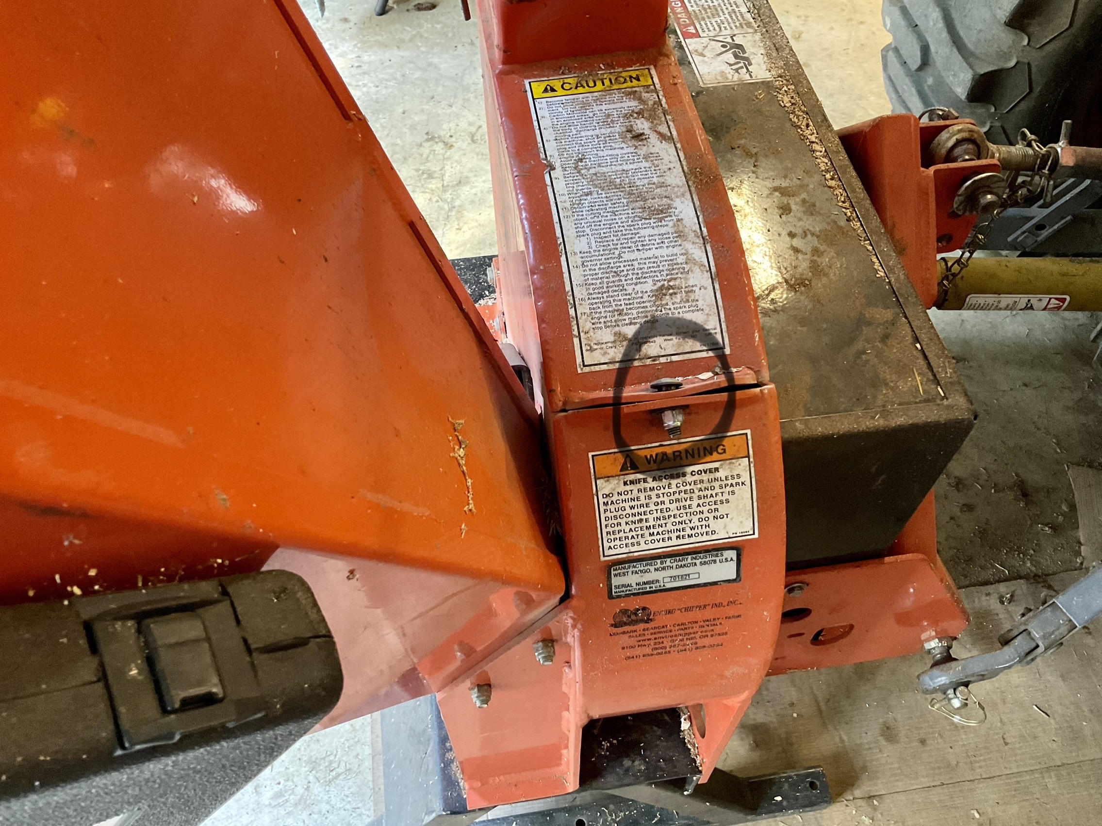

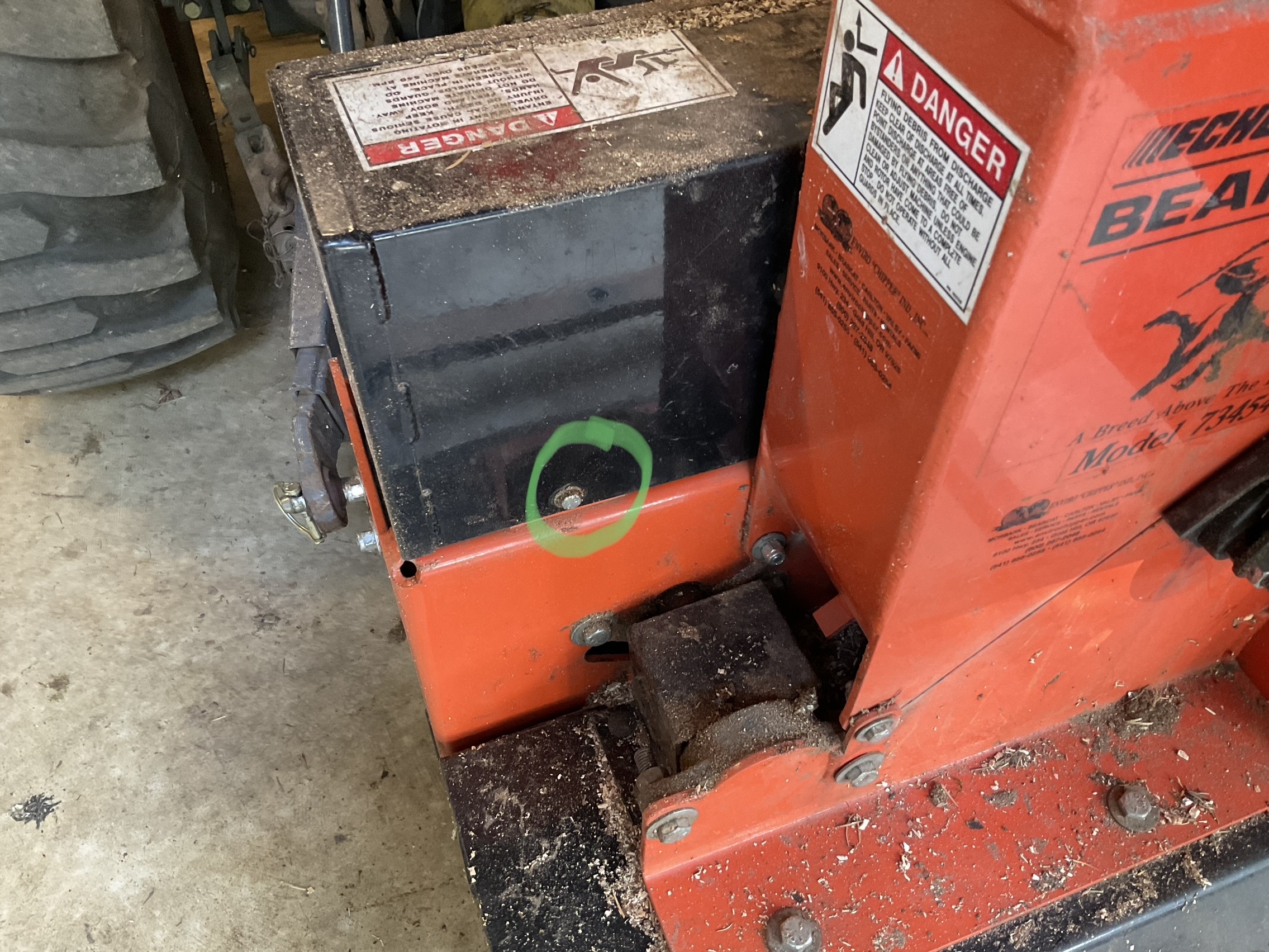

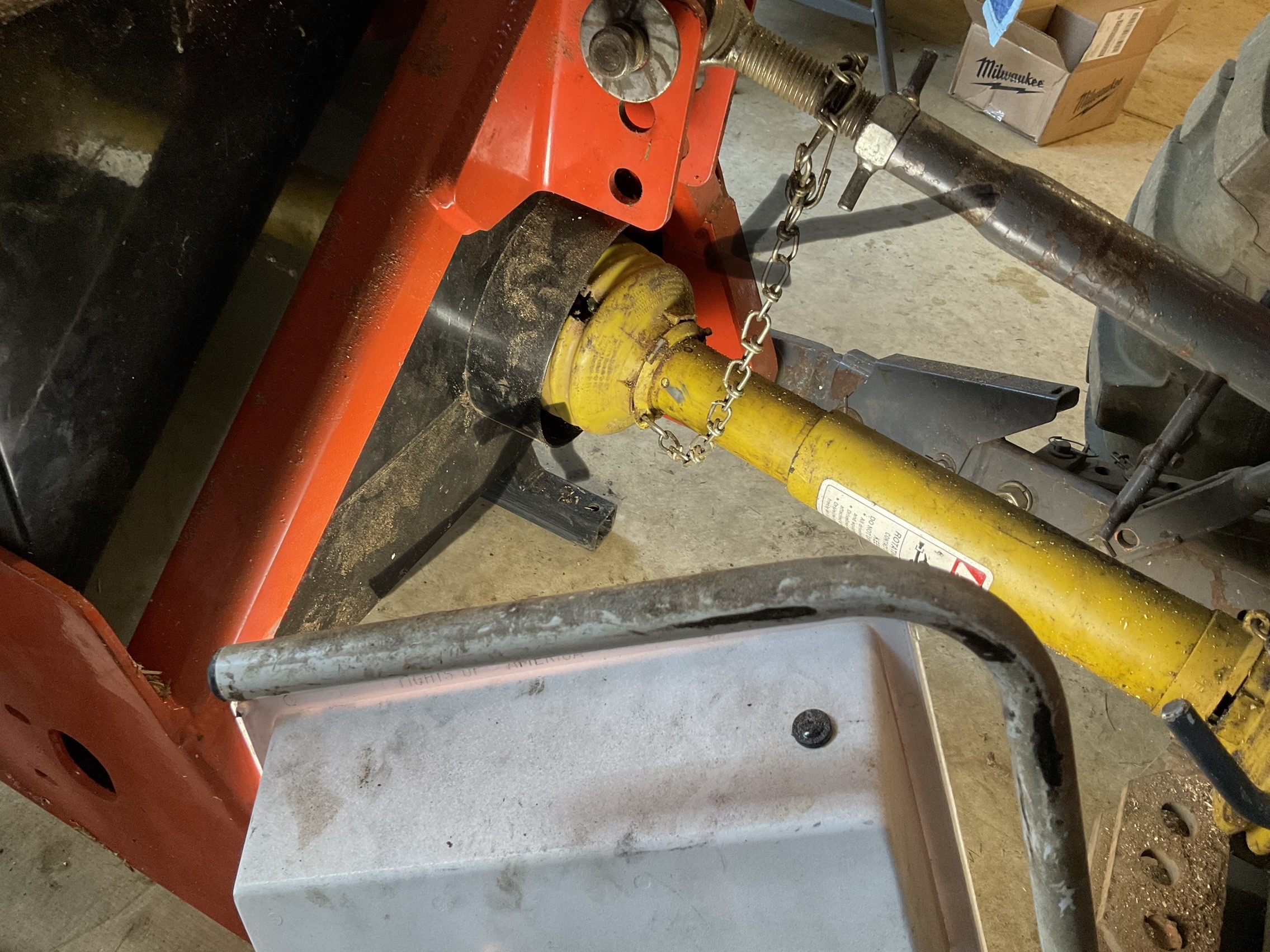

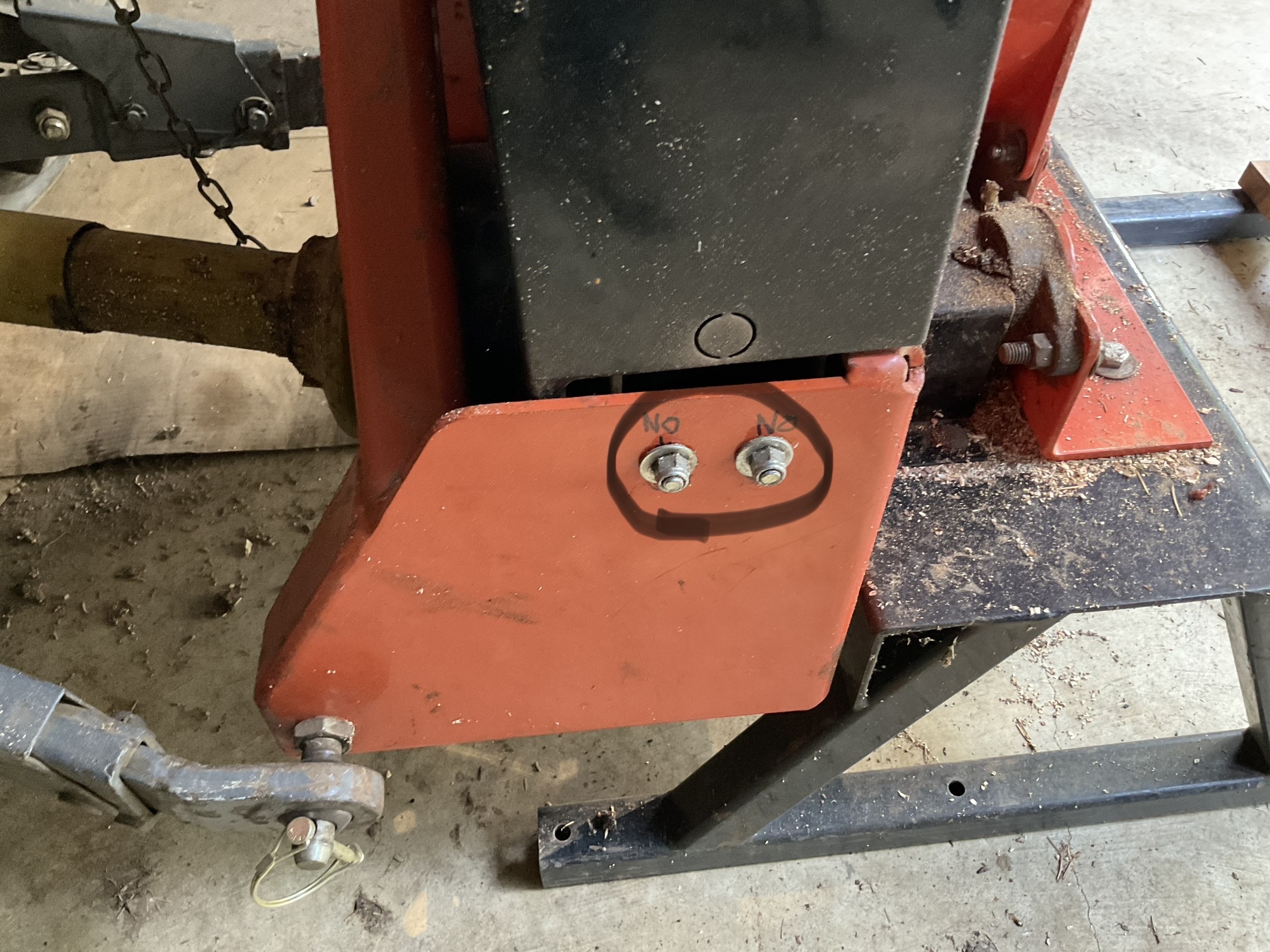

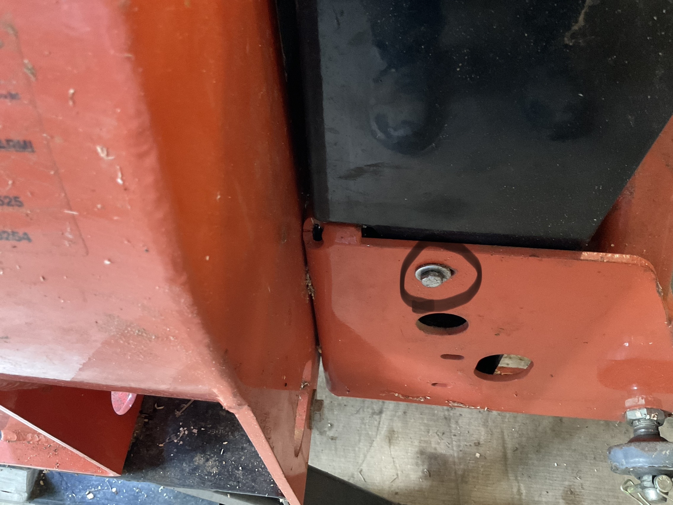

Pictures below show which bolts need to be removed to access drive belts. PTO shaft can stays on the chipper but has to be removed from the tractor and then separated so that collar can be slid down to access two bolts inside the ring by the
PTO shaft.
