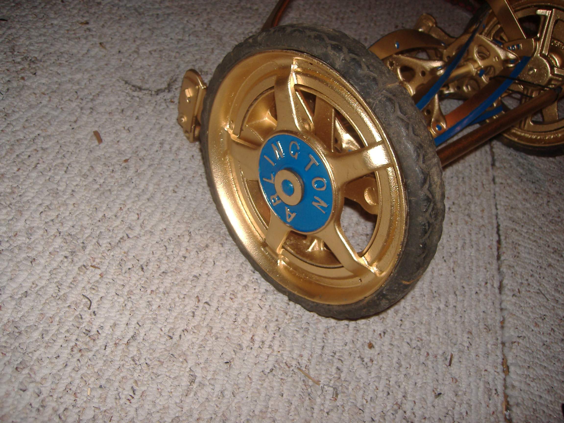

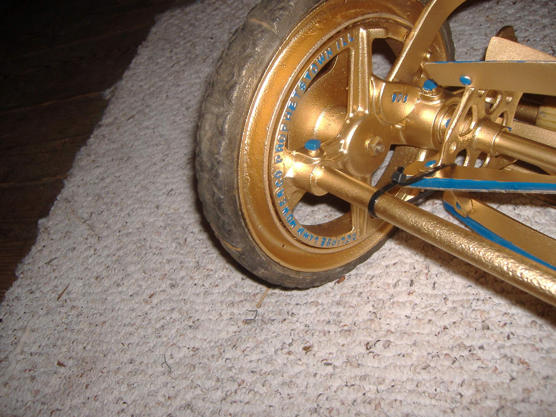

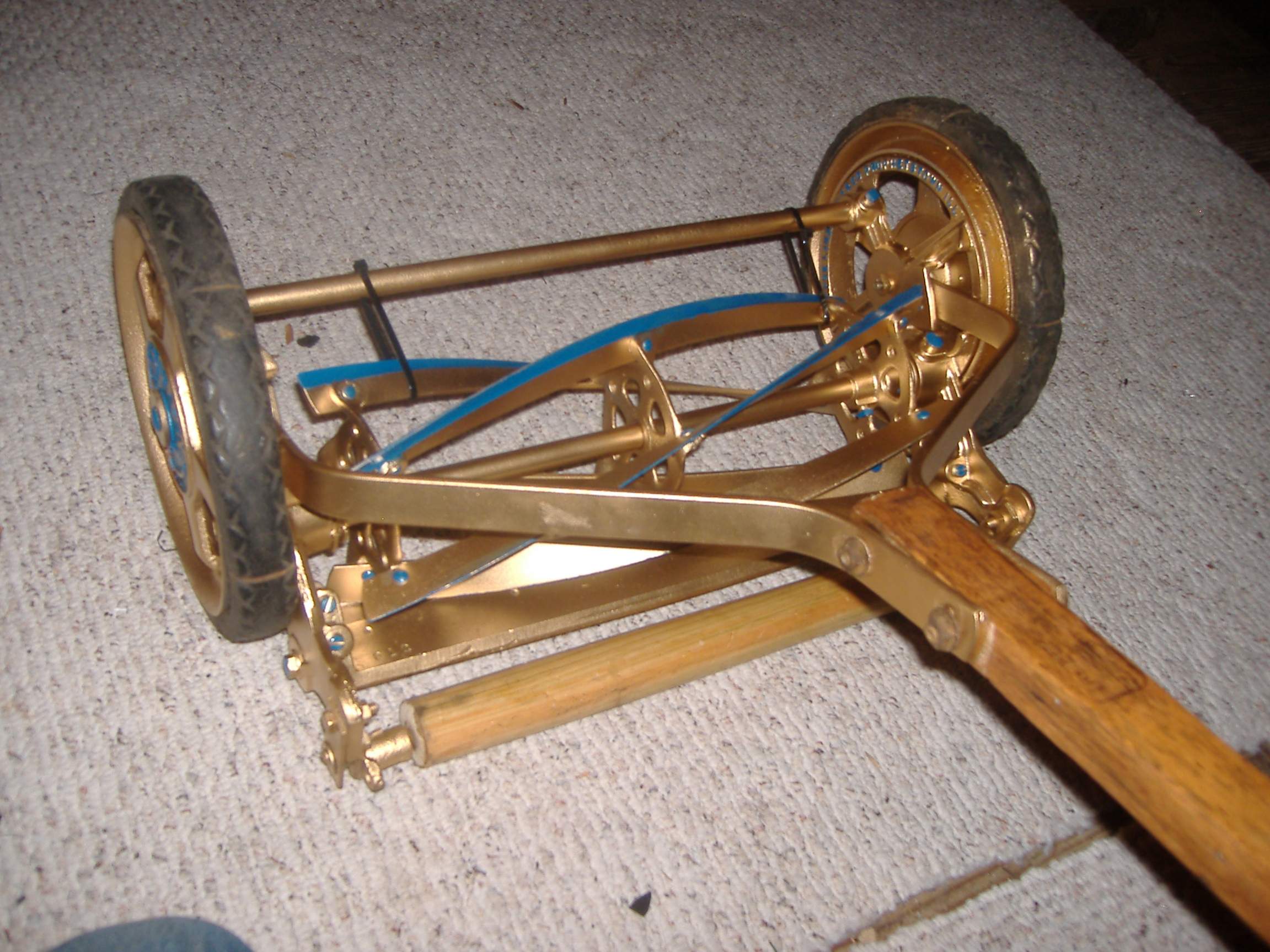

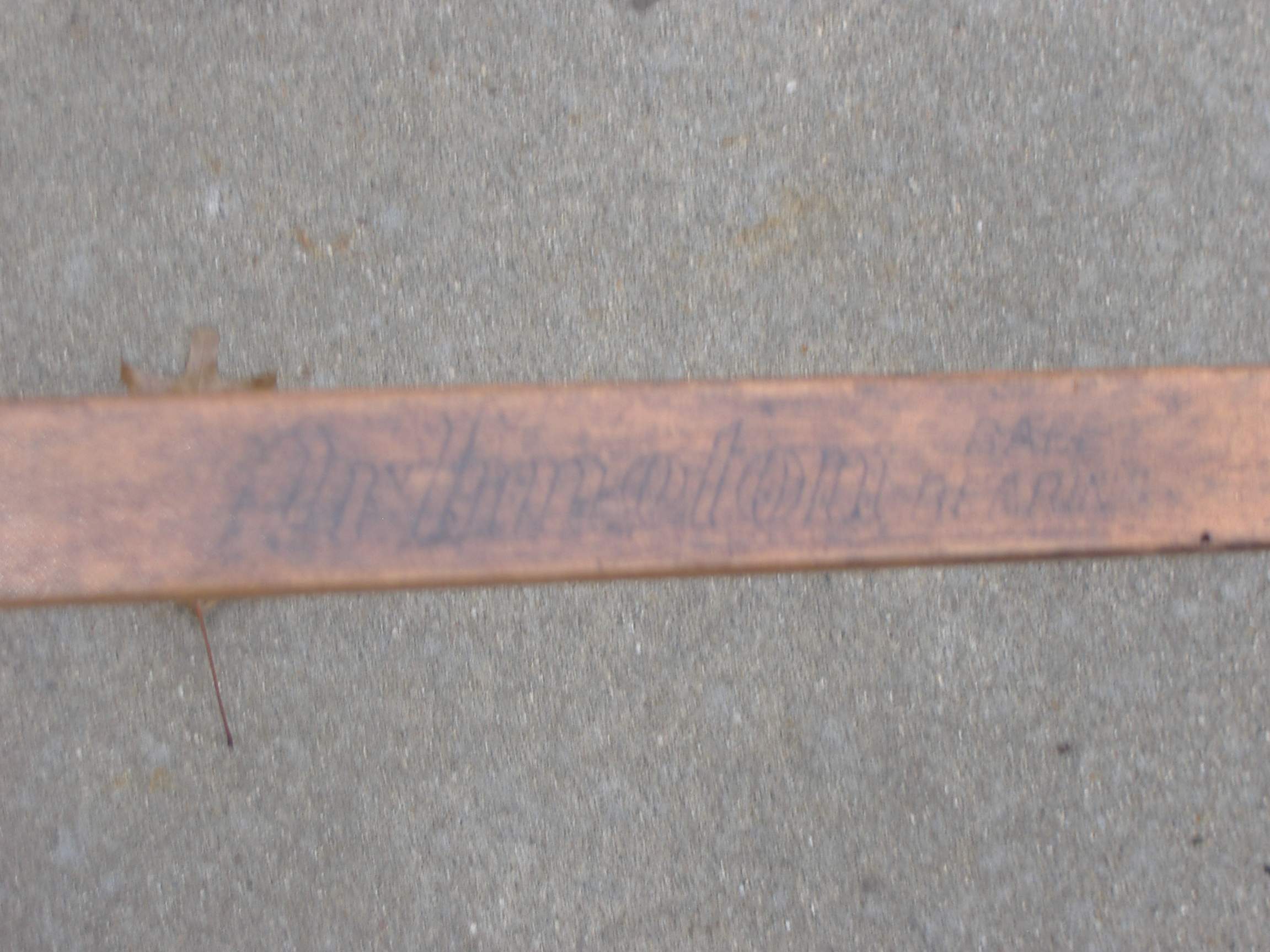

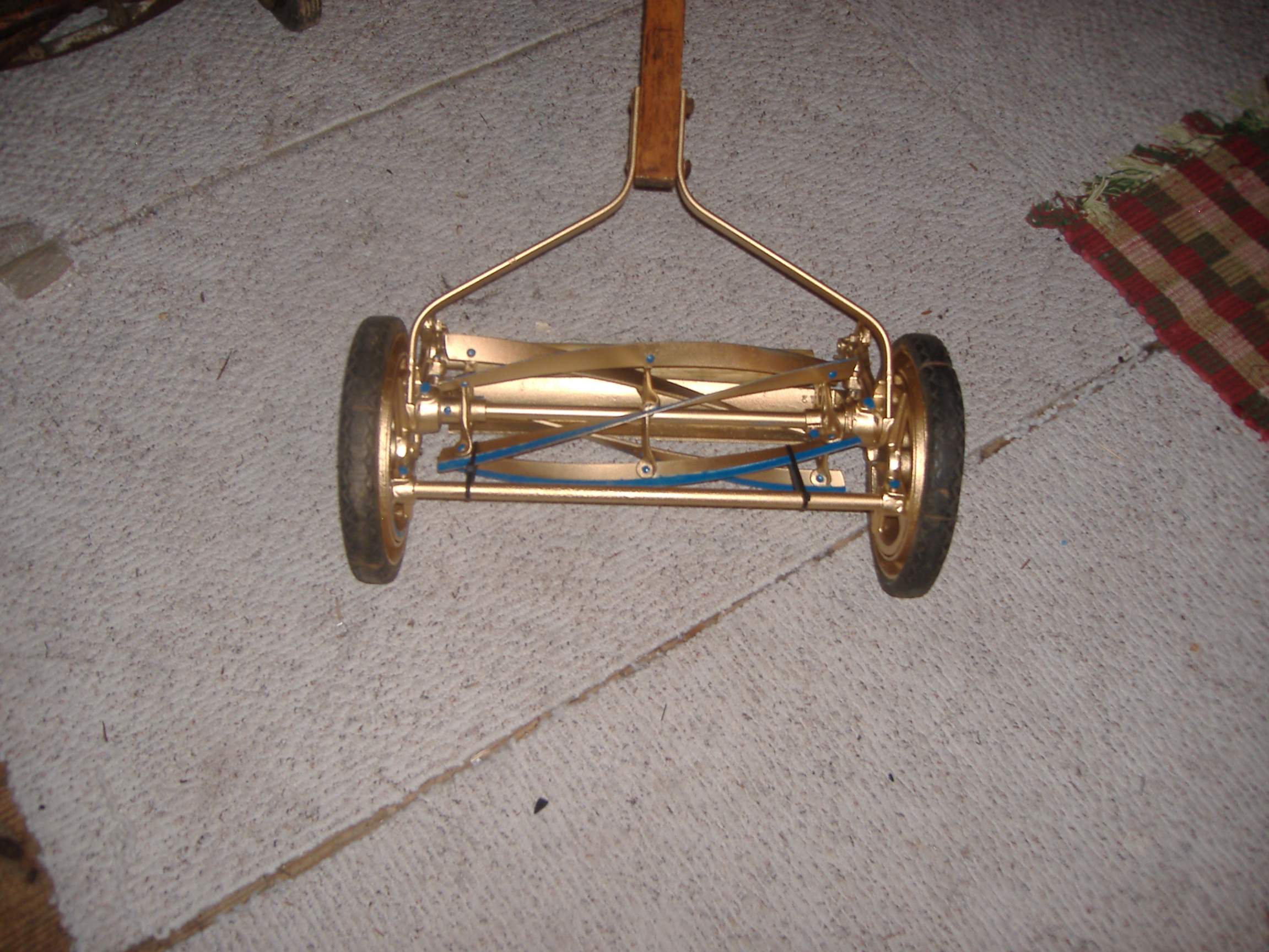

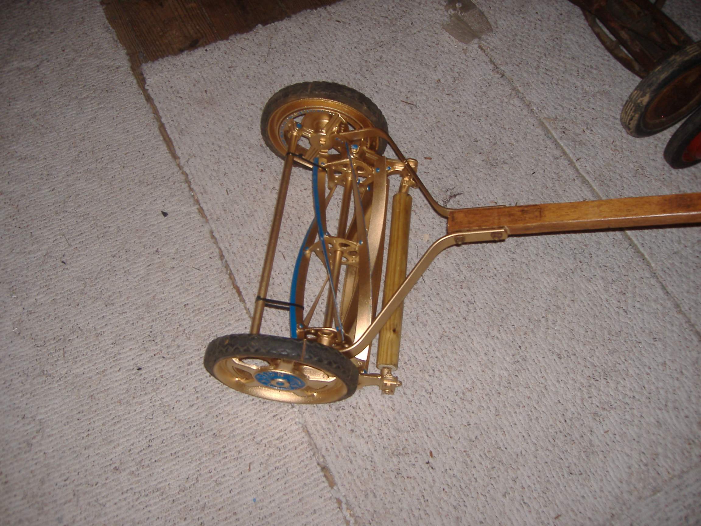

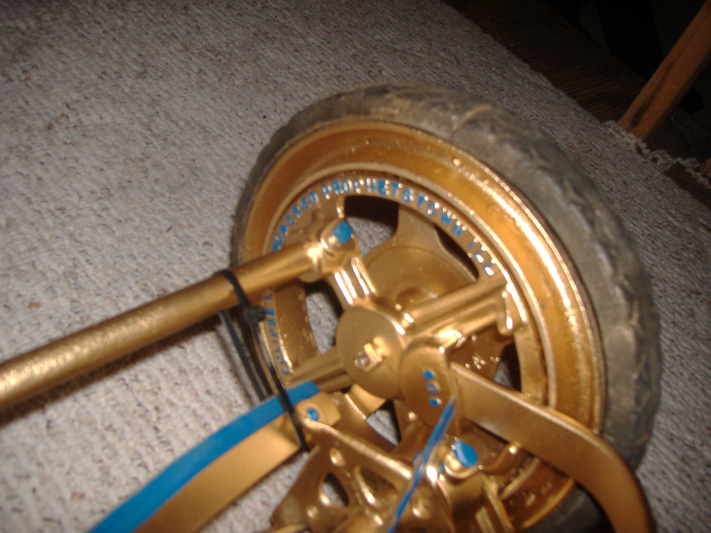

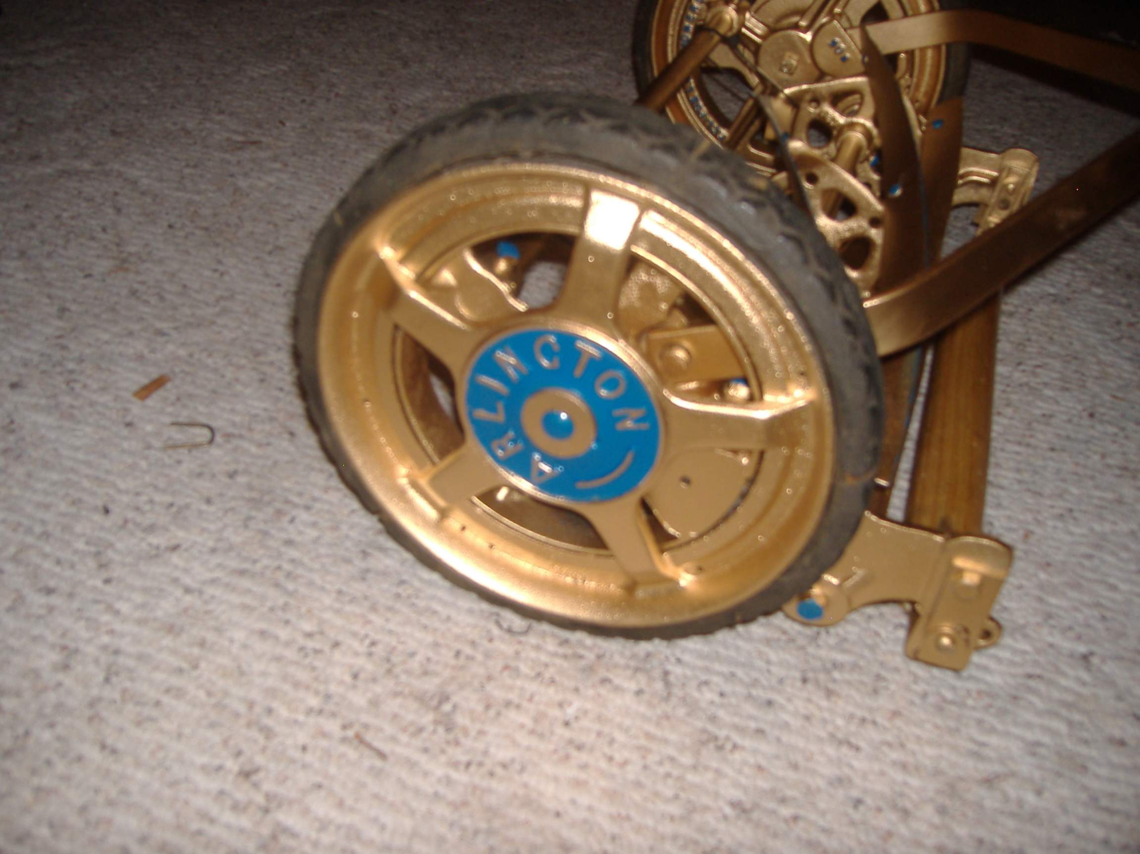

I finnally got back on TractorByNet today and found you had replied to my post. The bad news is just before I read this I had just painted the Arlingon blue and gold.:mad: It looks pretty sharp although.:confused2: Thanks for the infornmation:D I will post a picture of it soon.
/ Eclipse Arlington Reel Mower

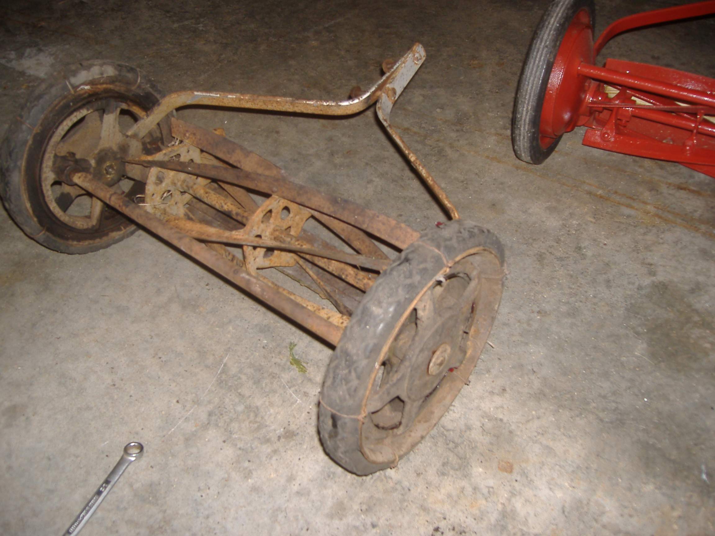

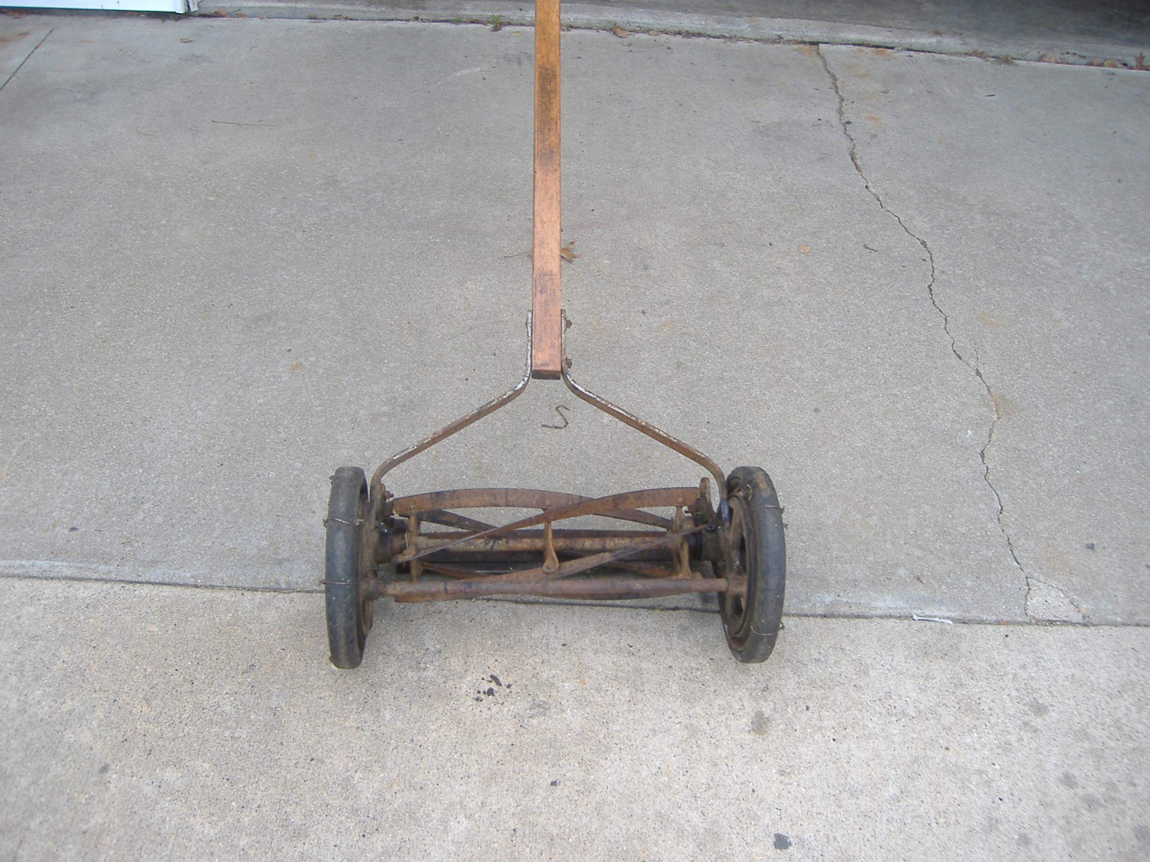

Here are some before and after pictures.
