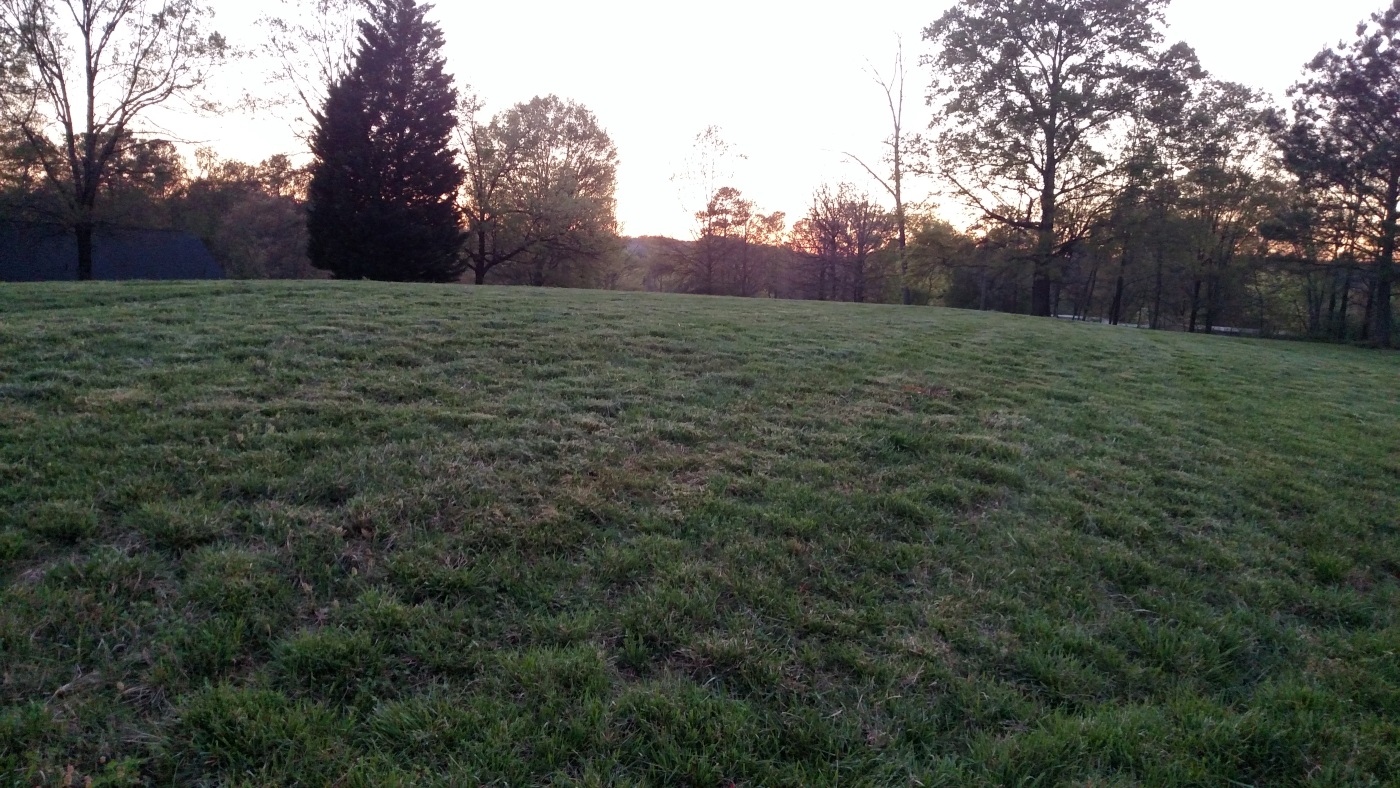

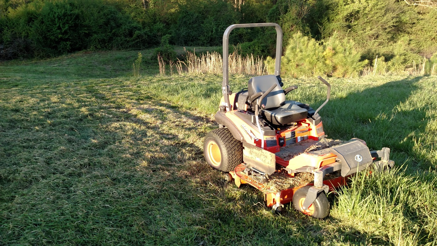

I wanted a ZTR for my 5.5 acres and dad's 8. I read and read and almost let reviews and people talk me out of a 72" deck and diesel but that was what I wanted. After several demos I purchased a left over ZD326H a month ago. This evening I got the mower up to dad's and cut his pasture. Was a little concerned about power, the brochures for the mower say 26hp but based on cross referencing the sticker on the engine it has 24.5hp and 70lbft of torque.
The mower did awesome. As you can see the grass was a little over grown but it had plenty of power to get the job done in one pass with a 4" blade height. Now I wont try to claim I was able to run full stick but I didn't have to creep either.
The only complaint I can even come up with is the tires. I came home and ordered a set of R4 type tires and if that isn't enough I will fill them with water. The stock tires just slide and spin to easily.
And with 9.7 hours it only took 8.2 gallons to fill it back up.

How much did you mow that was that tall? If most of the 9.7 hours was that deep id say your doing pretty good for fuel. With that much area to cover id say the 72" was a good call. Most gas engines would have probably burned closer to 15 gallons although I'm not sure about the FI models. The 22hp Briggs in my turd cadet burned ~1.25 gallons per hour. Personally i would have mowed that deep stuff with a brush hog. I now see why kubota uses the single double v belt to power the side spindles.
   / Ecstatic with the purchase - ZD326H 72" deck
Mowed roughly 6 acres that tall, took less than two hours, the other 7.7 hours was spent cutting a more reasonable height of grass.

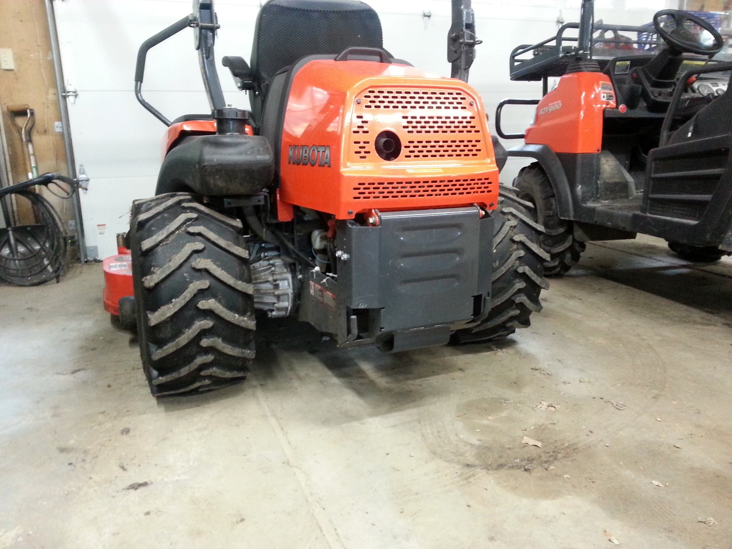

I have a ZD323 with a 60 inch deck cutting four acres, mostly field grass and in low areas where water easily ponds. The ZD just cuts right through the tall grass without issue but in the soft soil the turf tires became slicks. I install R4's and never got stuck again.
Looking good! I have a ZD326. It's a power house. I'm very curious about the r4 tires. Can you post pic of them when you install?! (0:
Here is a ZD323 60 inch with R4's

I have a ZD323 with a 60 inch deck cutting four acres, mostly field grass and in low areas where water easily ponds. The ZD just cuts right through the tall grass without issue but in the soft soil the turf tires became slicks. I install R4's and never got stuck again. Here is a ZD323 60 inch with R4's <img src="http://www.tractorbynet.com/forums/attachment.php?attachmentid=466932"/>
Man that's awesome! Aren't those R1's? I thought R4 was industrial tread.
Does the cleats tear the grass up when turning? I really love the look of the tires on the ZD!
