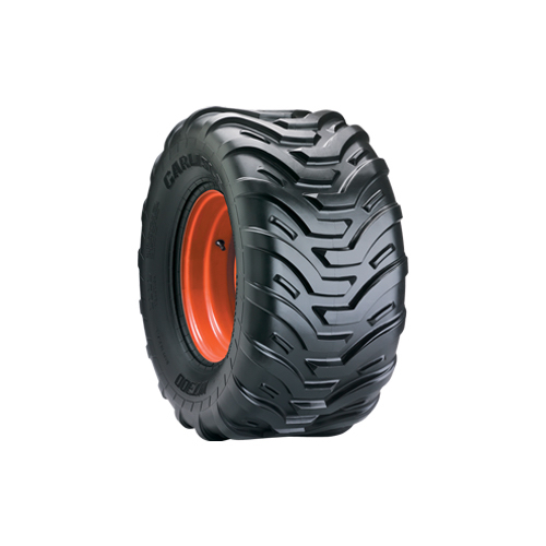

Here's a pic of the WT300. Interesting tire.

I took delivery of a new ZD326 last week to replace a ZG222 that was a little small for what I was asking of it. Needless to say I stuck the zd326 twice in areas that the ZG222 would mow through with no issues. After doing some research over the weekend I ordered a set of the WT300 tires and they arrived today. I'll get them mounted up tomorrow and post some pics soon. I hope the tires will give the new machine the same terrain capabilities as the lighter zg222 it replaced.
Other than getting stuck and spinning a lot the ZD326 is a heck of a machine and should last me for many years.

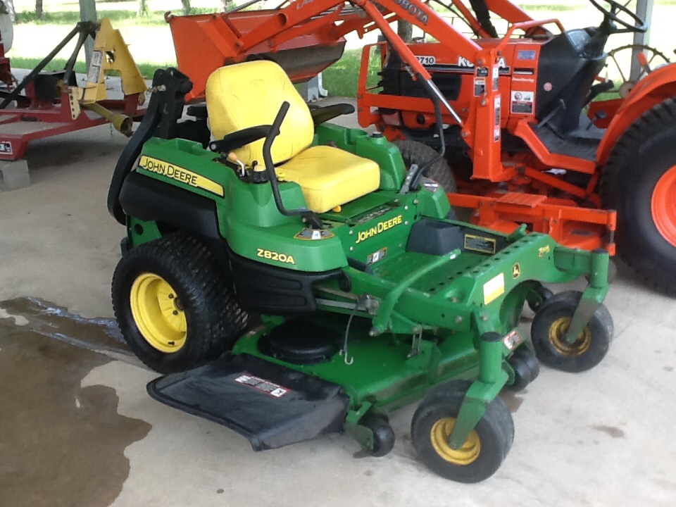

I have a John Deere Z820A and I'm intrigued with the WT300 tires. My tires are 24x12 and after several internet searches can't find them in that size. Anyone else using that size?

Good info to have regarding the gearbox, I'll keep a check on that. I took delivery of a new ZD326 last week to replace a ZG222 that was a little small for what I was asking of it. Needless to say I stuck the zd326 twice in areas that the ZG222 would mow through with no issues. After doing some research over the weekend I ordered a set of the WT300 tires and they arrived today. I'll get them mounted up tomorrow and post some pics soon. I hope the tires will give the new machine the same terrain capabilities as the lighter zg222 it replaced. Other than getting stuck and spinning a lot the ZD326 is a heck of a machine and should last me for many years.
Looking forward to your photos. What kinda of terrain are you getting stuck on? I only have gotten my ZD stuck when I got too close to mud on along a creek bed.
Also what kinda of grass are you mowing? Lawns or field grass? Very curious how bad the new tires chew up the yard. (0:
