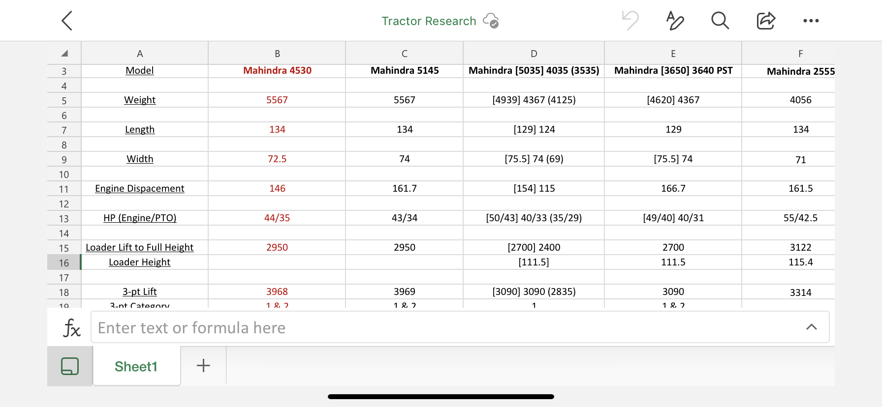

Our Ford 3000 & MF 135 have had good long lives but are ready to be replaced. We have a 5ft bushhog, disc, cultivator, box blade, drag, and several homemade scoops for digging trees with skid steer quick attach fel. (FIL is selling skid steer but I’m keeping some parts)
I’d love a 40-50+hp tractor, but that’s pushing my budget and I’d need all new bigger implements with no money left to buy them. Father has a Mahindra 4530 fel which is a tank if I need it occasionally.
Tasks include: bushhogging fields and trails, grading 1,500ft gravel drive, planting a couple acres of corn, beans, watermelons, okra, squash, etc…, moving large potted trees, digging and planting trees for small orchard, raking limbs, landscaping, turning compost piles, moving mulch.
I’m thinking 30-35hp (minimum 25 @PTO), fel with as much lift as possible, 4wd. 5ft implements need to cover the tires, or at least come really close. Prefer: power shuttle/gst or hst, but could do dry clutched shuttle, ease of attaching implements, industrial tires.
JD and Mahindra are 5 miles away. Most other dealers are within 30 miles.
I’m struggling to find enough HP and tractor weight without going to 6ft width. Any guidance on specific models to look for is much appreciated.
I’d like to keep it under ~15k but could push that a bit for the right deal. Does this sound reasonable? Thanks

The Deere is going to be similar to the Ford 3000 in terms of size and weight but it will have somewhat more power. Like the Ford, it will be a little larger than the Massey-Ferguson. The Deere is also a Tier 2 machine, so no particular filters or catalysts. The Kubota L4060, LS XR4140, and Mahindra 3550 are all Tier 4 "emissions" machines.
$14k for a 2WD 5105 with a loader is a good price as long as it is not in terrible shape or have 10,000 hours. It has at least as many "creature comforts" as your existing tractors, so if you were able to do your work with the Ford 3000 or the MF 135, you would be able to do it with the Deere.
