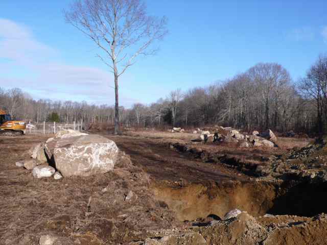

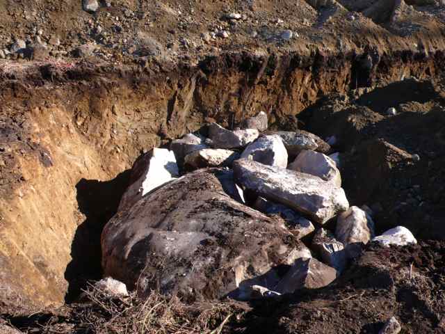

Update and a few more pics. Have been able to speed up the digging and the logistics, aka where to pile stuff. By end of today should be half done with driveway. Essentially I box a trench at 8ft deep and 15ft wide and drop/push the rocks in. The largest one went in yesterday...see pics. This CX130B excavator is using about 6 gallons diesel for 7hr day on mostly low revs.........Gary

If someone told me they didn't have time to do something because they had to go home and bury rocks, I'd think they were pullin' my leg. Obviously, in your case, that ain't true. You have got to be the only person I ever knew who buried rocks. I'm sure there are others, but you are brave enough to post pictures.;):laughing:

What's the trick to packing fill dirt around the boulders to keep the driveway from settling again and again over the next few years? Seems like it would be difficult to get a solid pack that wouldn't settle after rains.
