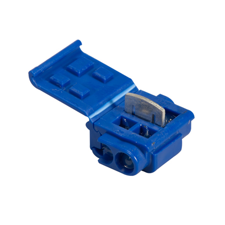

if it is using taps, I'd rewire. also, might pay to add something mor ethan the (possibly) 14awg plain flat ribbon trailer wire under there they may be using.
or at least double it up..

   / Electric brake problems
soundguy
Umm, what's a tap?:eek:
