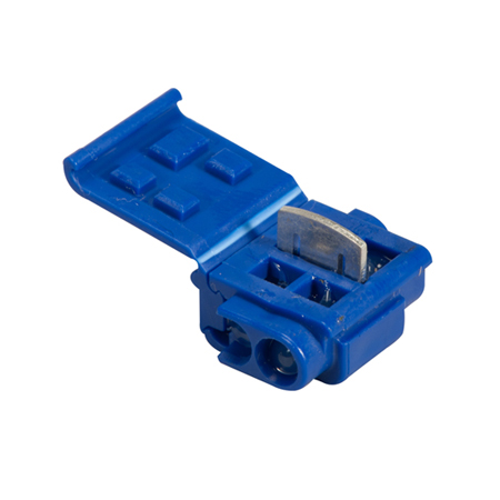

if it is using taps, I'd rewire. also, might pay to add something mor ethan the (possibly) 14awg plain flat ribbon trailer wire under there they may be using.

Umm, what's a tap?:eek:
Wire Tap-In Squeeze Connectors (10-Pack) - RadioShack.com
or any similar style of 't' style or 'y' style 1 in, 2 out, or 1 continous/1 extra out , 'crimp' style connector.
I see them ALL the time under trailers. my big tex had them and they were the prime cause of one sod eof my brakes not working.. I stripped them all out and went with a solder connector, heat shrink, grommets for wires, and liquid connector sealer.

OK, I do have those I didn't know what they were called.
   / Electric brake problems #14
there are even 'cehaper' ones that don't work as well either..
i'm not fond of these for under-trailer work...

Brakes should never be grounded to any point on the trailer if you expect them to work correctly. You should always connect the ground wire from the magnet to the ground wire in the 6 or 7 wire cable (depending on what you have) and through the plug to the tow vehicle and ground it there. All connections should be soldered and made water tight with adhesive shrink tube or covered with liquid electrical tape. Moisture is your enemy and needs to be sealed out. Any time you depend on a connection to the trailer's frame to carry the ground, you have the potential (likelihood) that corrosion will reduce the ability to carry the required amperage at that location. Plus, if you are grounded to the axle, you are relying on your suspension's moving parts to provide the ground. The magnet needs to be supplied not only the proper voltage, but also the proper amperage. Most, but not all factory wiring jobs are substandard. In many cases, it is easiest and best to get a 6 or 7 wire trailer cable and start over. Trailer electrical problems usually show up when you are least able to fix them, like at night. I'd much rather rewire in my shop than on the road in the rain or snow.
   / Electric brake problems #16
Like oliver..., I'm more comfortable not relying on a steel/copper connection for a ground due to rust. When I rewired my trailer I ran a 12 gauge copper wire loop with all the other wires around the trailer and spliced into it where I needed and silver soldered the connection and covered with elec tape. This is in effect two 12 gauge wires for ground. For non-grounding connections sometimes I will use wire nuts filled with silicone rubber.

seriously though, when someone says scotchlocks up here we all think of the no-strip taps like posted in the pics, but it looks like according to 3m there are a bunch of connectors that fall under the scotchlock trade name.
