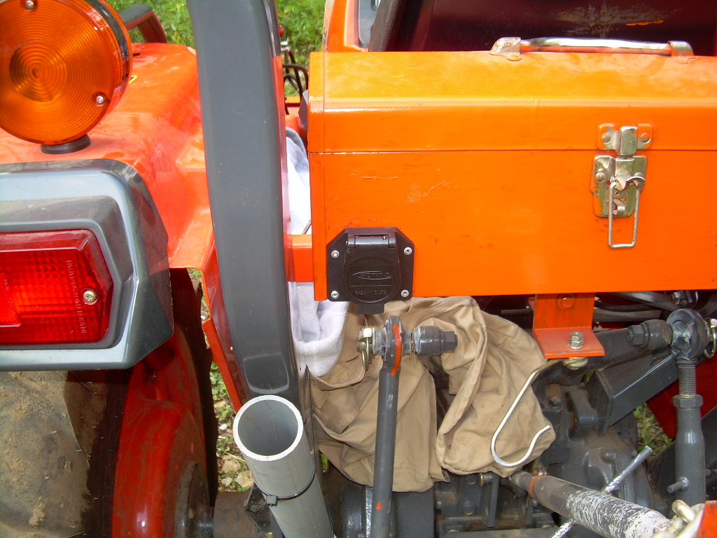

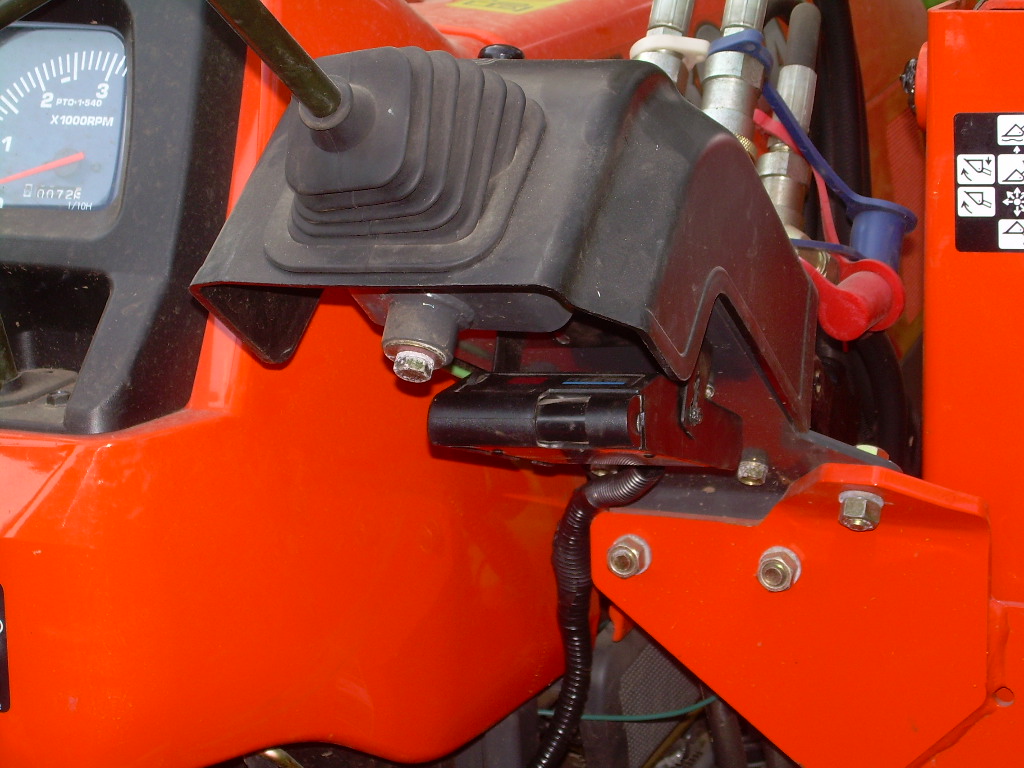

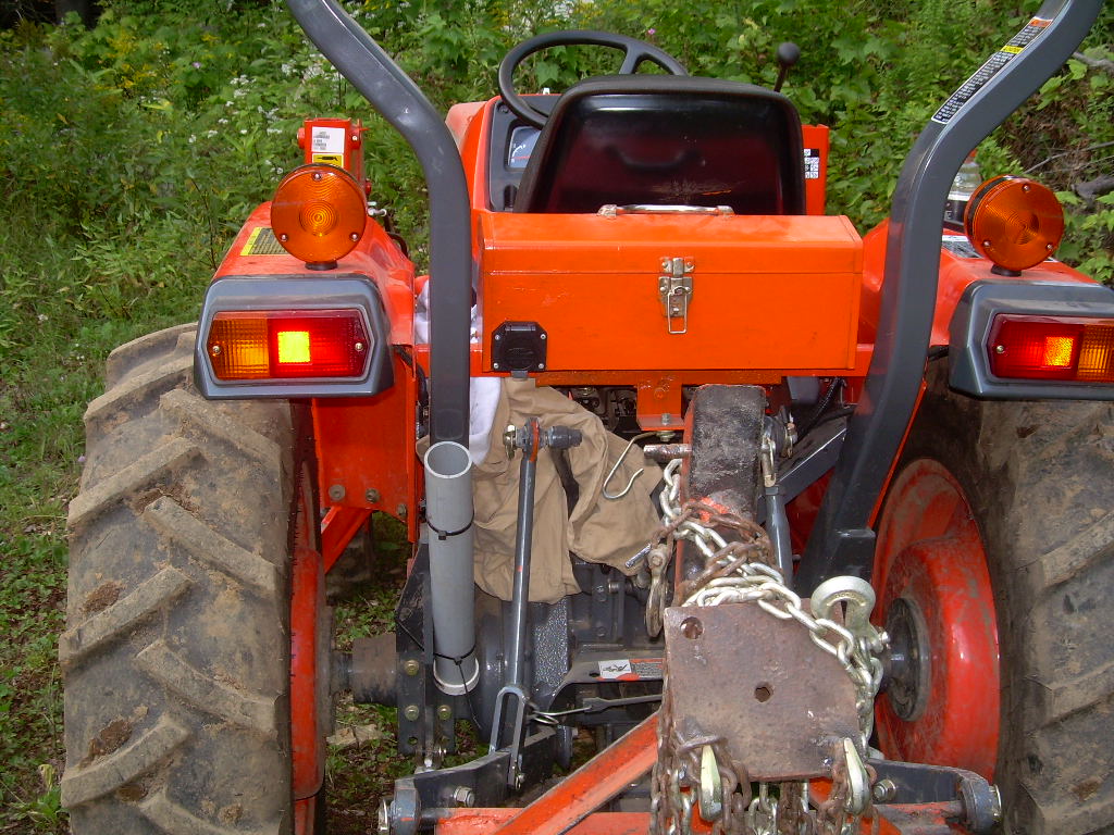

I have a new 3500Lb axle on order for my 4x8 utility trailer with electric brakes. I have had too many close calls hauling firewood down my mountain. I had a draw-tite brake controller sitting around that I salvaged about 2 years ago. There is a beautiful spot for mounting it under the control valve for the loader. I used a momentary push-button switch on the inside of the fender to activate the controller. I looked around for a while to find a mounting spot for the 7-way receptacle, but finally decided that I liked it in the toolbox, out of the weather.
I thought about using a rear brake light switch from a motorcycle, but I didn't want the controller on whenever I set the parking brake, or when on flat ground. Hopefully, I can just adjust for a little drag & thumb the switch when I need it.
I just need the new axle to get here & I will be able to move some of the wood that I have in piles all over the woods.

I've never seen an electric trailer brake controller on a tractor. I would assume that, because of the slower speeds that tractors travel, most people don't feel they need trailer brakes. But as you said, I can sure see how it would be a big advantage (maybe even a life saver) at times. And they may be more common than I've thought; just that I've not seen it before. I think it's a good idea anyway.
   / Electric brakes on my tractor-Finally! #3
Unique mod..... looks very professional... good work.... hmm...maybe I need one??

Very cool, but doesn't your tractor's tail lights come on when you hit the brakes? (ie brake lights)
If they do, why not just tie them to that circuit and you don't need the button
No existing brake lights on the tractor. Just signal lights & running lights. Also, by design, brake controllers are just to be used for operational brakes, not for emergency/parking brakes. So every time I set my parking brake with the trailer attached, the electric brakes would be on, drawing current.
