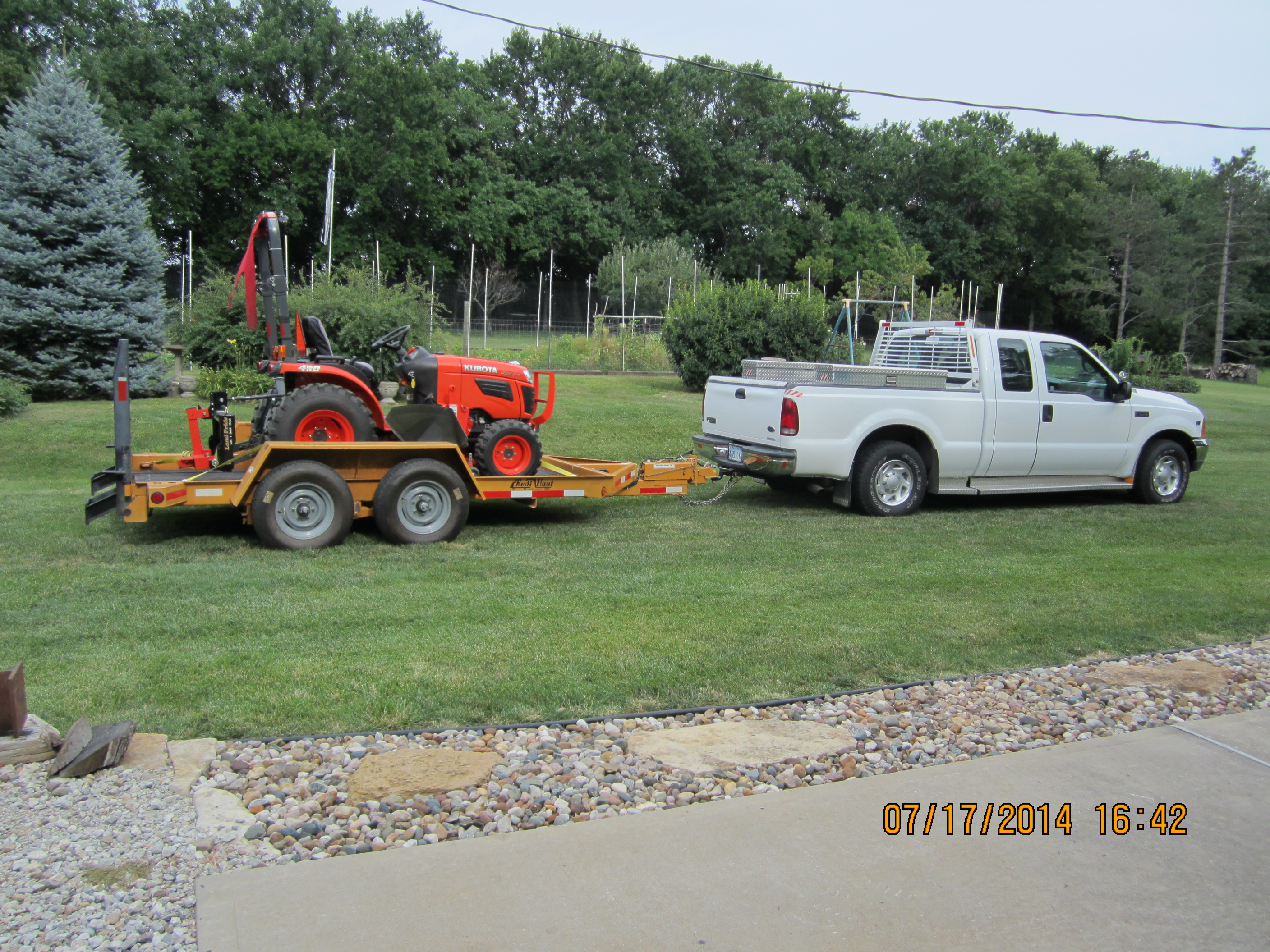

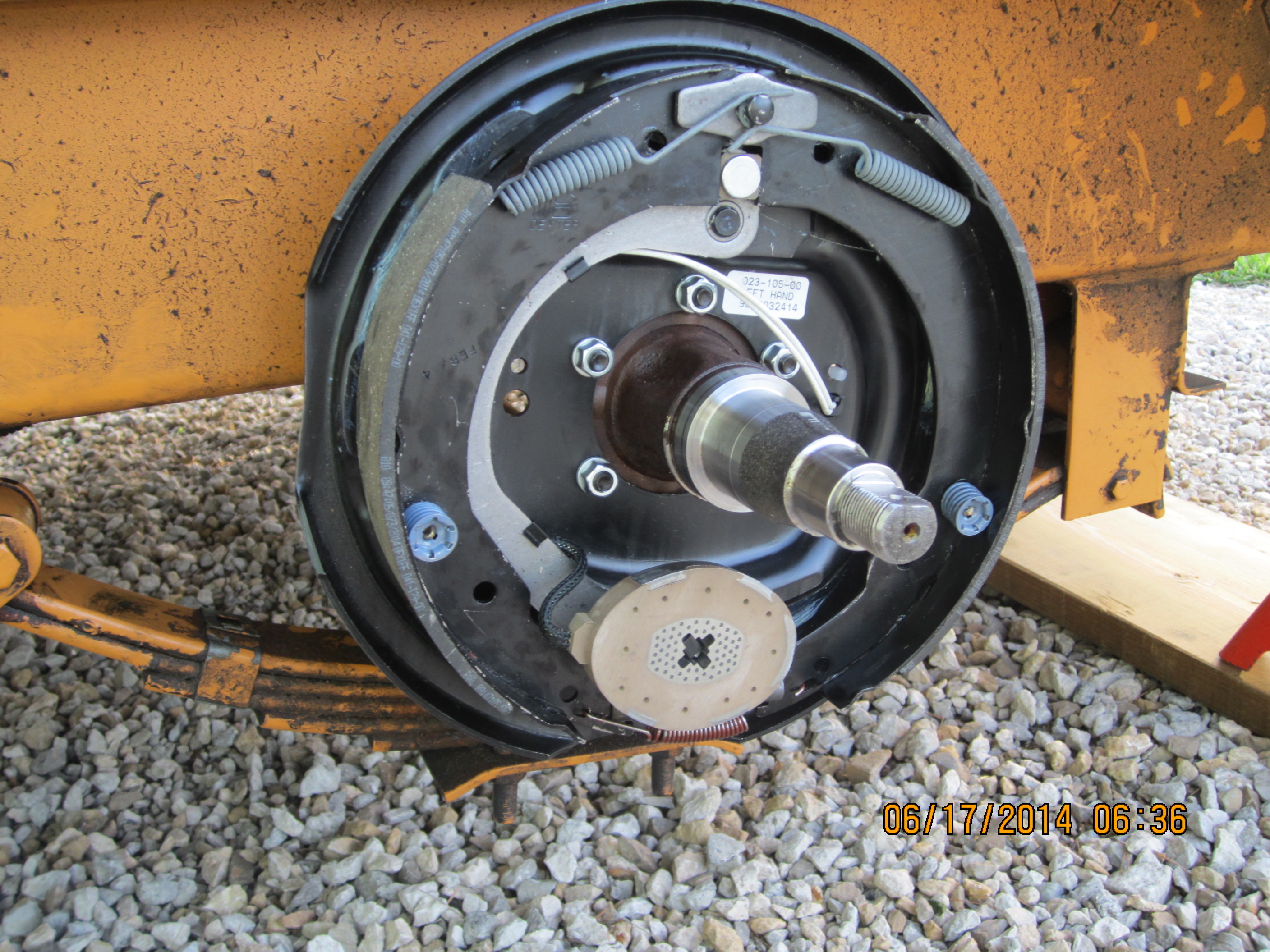

I have 4 wheel electric brakes and would not be without them!!
Also have a Reese Controller from Walmart that works great and is adjustable, amount of brake pressure and speed they apply.
