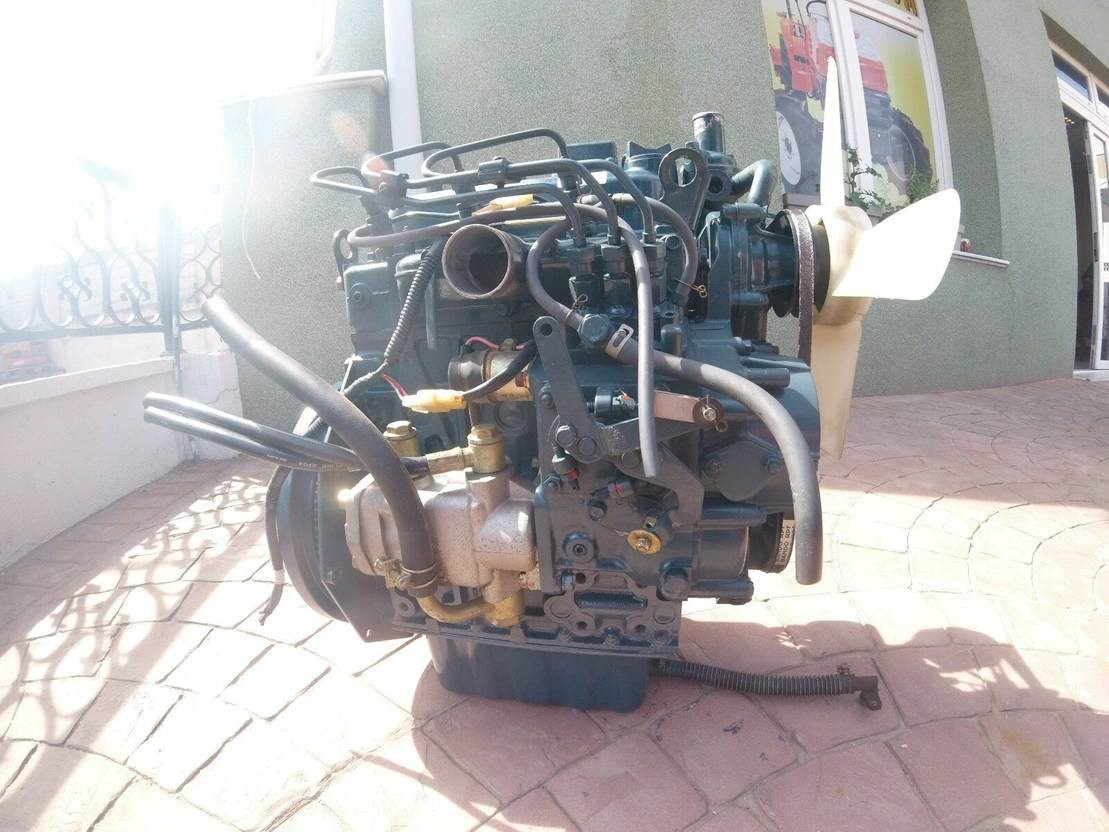

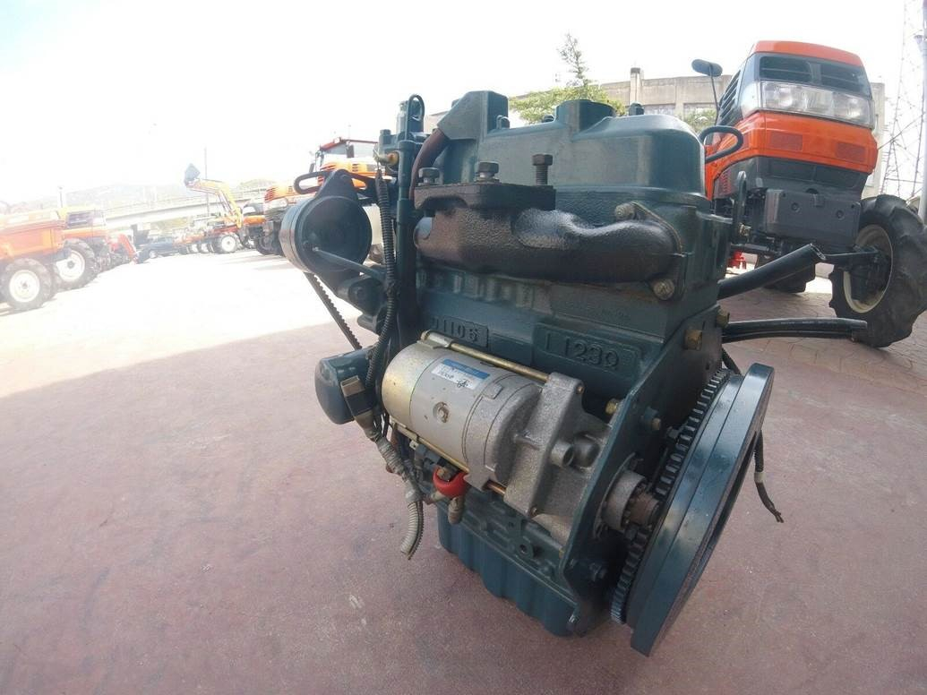

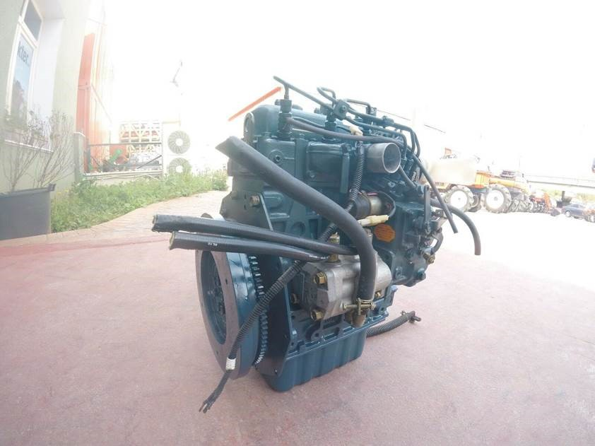

I was just offered a great deal on a Kubota B26 with a blown engine. Hydraulics apparently work just fine.
I am really interested in converting it to use a bunch of lithium battery packs from eBikes I got at an auction. There are 36V and 48V packs (42V to 54V when fully charged). Decent capacity.. 500Wh to 1kWh each.
Has anyone attempted this? I am thinking to remove the engine and find a similar spec 3 phase electric motor up 20 kw. I know electric motors are more torquey that ICE, so that may be overkill?
Thinking to run the motor at 72-96V on ebike batteries in series.
Remove engine but keep the flywheel mechanism and maybe some of the crank shaft to drive a pulley with the electric motor? The flywheel already connects to the electric starter motor so would that be strong enough to handle a 20kw motor via gear drive??
The attached pics show starter motor that drives flywheel.. but that may only handle the HST drive and the PTO.
There is a hydraulic pump on the RHS of the engine with a pump for the loader and backhoe and another for the steering mechanism. Any suggestions on how to handle that?
If anyone has anything that is remotely relevant, please post as much detail as you can. I am sure that there are many more people interested as the price of the tech comes down. What sort of motor / controller / etc etc did you use and how is it working out?

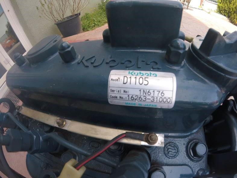

Not entirely sure, but it was run with the oil plug out and the engine is seized by all accounts. I have looked at it briefly and not done a deep dive yet.
The engine on the pictures is just for illustration of what the electric motor would replace, and posted to show the flywheel and how the starter motor drives and turns over the engine.
