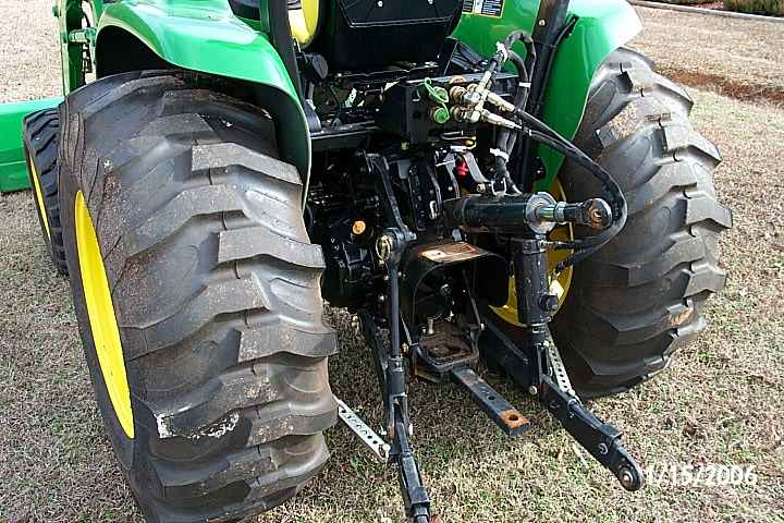

Hi folks, is there anyone out there with this kit intalled on their tractor? Part # LVB25511. I understand that this kit provides for four quick connectors at tractor rear. These connectors can be used to operate tip and tilt by using the joystick. Do I have this right? A picture of this set up would be great.

The kit allows the joy stick to control two functions. The joy stick controls the loader normally. When you switch the rocker switch it controls the rear SCV's. You can hook up what ever you want to the SCV's.

There is a button up front that transfers operation from the front end loader to the rear remotes. I loved my set-up. I have one on my 4310 and on the 4720 I just sold. The cab 4720 will have this set-up also. Here is a picture of the rear SCV's and top-n-tilt.
