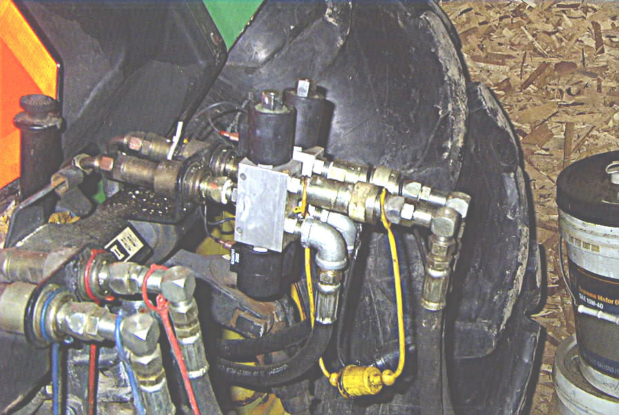

   / Electric Diverter Valve #12
Mark, will try to attach a picture of my diverter installation. I put male fittings on and plugged the diverter into my existing bucket outlets. Then put female disconnects in the 'default circuit' holes of the diverter (these work when diverter is not activated by the button). I plug the factory bucket hoses in these, the top ones in the picture. I plumbed the accessory hoses in the diverter with pipe elbows to save space (these work when the button is pushed and are on the bottom in the picture). If I need to unhook them, I will remove the whole assembly and just plug in the factory bucket hoses. Mounting the valve in the back like this cost me some hyd hose, but it seemed the most versatile and sanitary place. Electrical work was very simple, 1 hot wire, no ground.

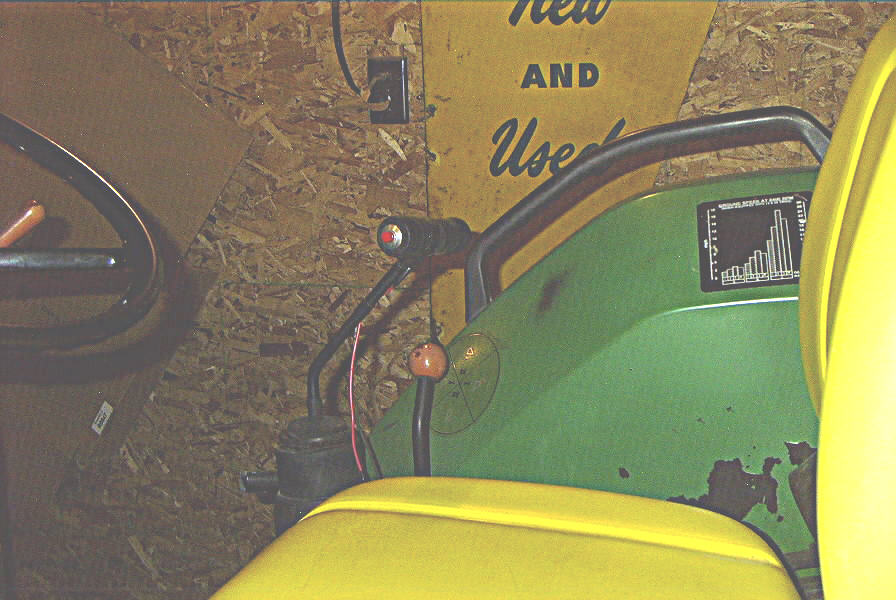

   / Electric Diverter Valve #13
V&M supplied a handle with a switch in the end which was supposed to clamp to your existing hyd lever. I modified it to act as a "T" handle by shortening it and welding 2 nuts to the side to thread to my joystick. It works better than expected. Operate the switch with my left thumb. This modification of the handle took the most time of all in the install, still did it all in a short evening.
