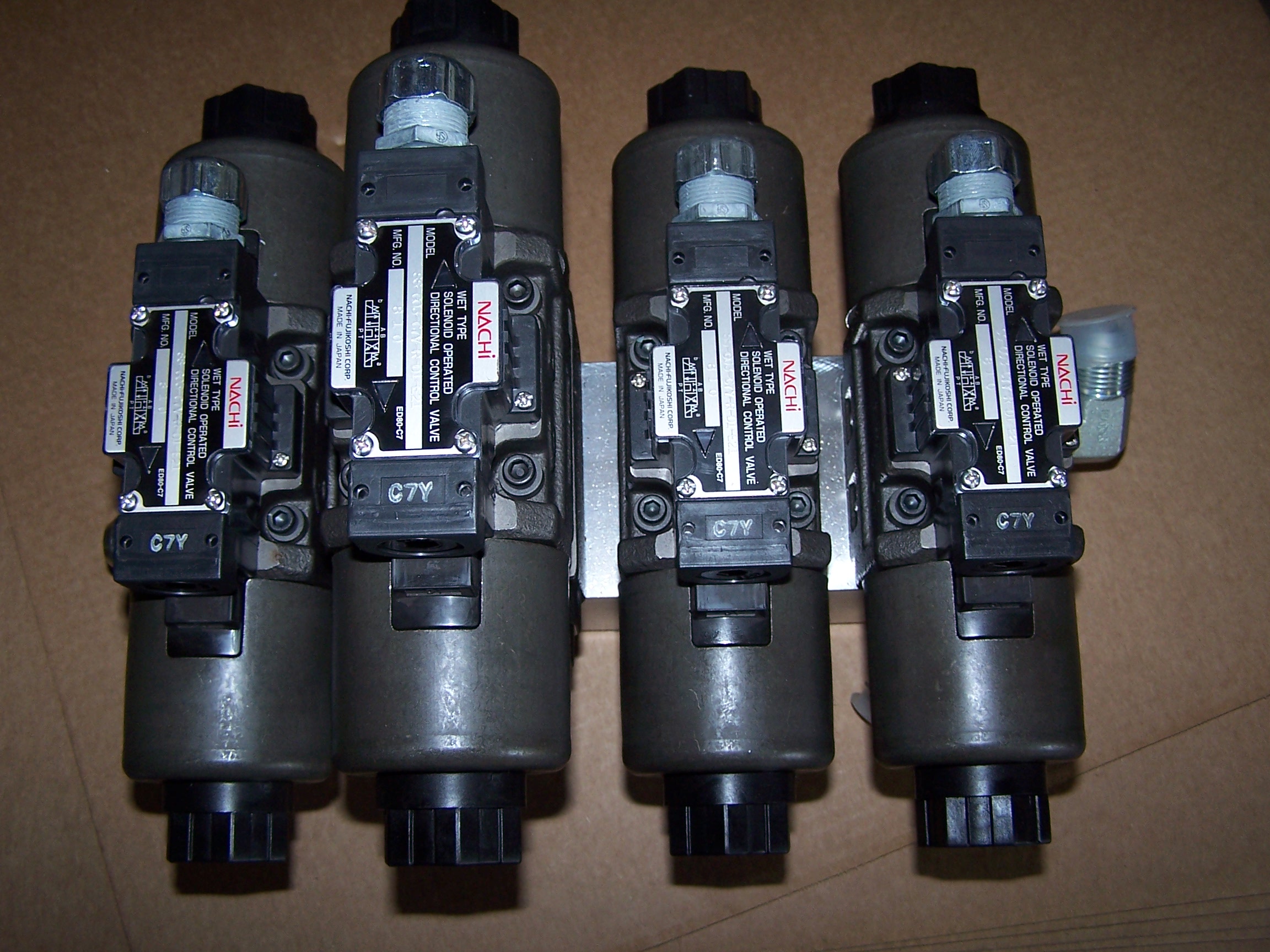

It appears that the consensus is that if I use electric valves I will need to be able to control the oil flow. I also need to shut down the valves when the cylinders extend or retract to their limits.
In the pics you can see that 1 valve sets up higher than the rest. This valve has what is called a Port Meter in-flow. I think that this will allow me to adjust oil flow. I have 2 more of these Port Meter in-flows in my box of goodies. If I am correct I could add the 2 Port Meters to my valve bank. Then I would have 3 valves with fluid control. I am trying to track down the Port Meter distributer to find out more info (So far no luck). Can anyone confirm that I am right about the Port Meters by looking at the pics? I will also use toggles that will spring back to the off position when you release. This will take away the issue of forgetting to turn off when the cylinders are at their limits.

MD3
Can you read the model number on the valve.
   / electric hydraulic valves with toggle switches
#26
MD3
J_J
SS-G03-C7Y-R-D1-E21
The item below the 1 valve is marked. Nachi Modular Valve ( OCY-G03-B-X-J51)
Mike D.
   / electric hydraulic valves with toggle switches #28
J_J
SS-G03-C7Y-R-D1-E21
Mike D.
Nice general valves
P A B ports 5000psi
T port 2285 psi
flow rate= max 24.6 gpm
SS=wet type solenoid
G03= cascade mounted 3 size (larger, 1 size smaller)
C7Y=basically open center and work port closed in neutral, bi directional
R= have indicator light LED
D1=DC 12v 2.6A solenoid
E21= design number mounting bolt 1/4-20

Those look like fairly common dual-solenoid spool valves for double-acting
cyls. You can see the schematic on the body.
You may be able to use a standard D03 manifold and use just one (or
two) of the valves on your tractor. That may give you some more
mounting options.
If you are going to operate something like a bkt grapple on your FEL,
you can use a momentary or a fixed toggle switch, no problem, depending
on your preferred method of control. Since you are diverting flow from
a work port circuit in this case, your system RV protects you just like
in the non-diverted case. Some folks like a momentary switch on top
of the FEL joystick. I use fixed toggles mounted on the control panel.
You will also have the same amount of feathering control since this kind
of installation uses an FEL valve work circuit, diverted to your grapple.
You would use the same joystick.
