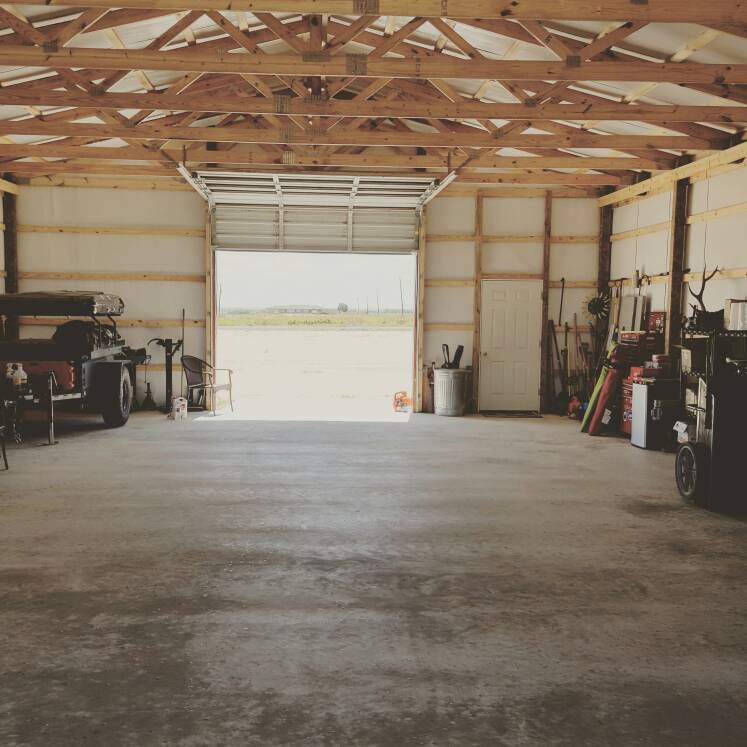

Sorry if this is the wrong area....... I have a 30x50 barn and I am going to have electric run to it. I would like to do it right the first time. Here is my list.
-10 outlets, 5 on each sidewall
-4 more outlets, 2 on each end
-2 more outlets in the ceiling, one for each overhead 12 foot door
- light switch on both ends of the barn for overhead lights
- 2 outside floods, one on each end of the barn, with switches.
-separate panel in the barn
- 220 outlet for welder, etc.
- still researching best overhead lights
Again, I want to do it right up front.....am I missing anything? Thanks

Firstly, is this also a workshop, and how big is your primary service? Second, make each outlet a 4plex on the walls, you can never have too many outlets, and make sure each outlet is on a 20A breaker with 12AWG and T slot receptacles. If you run 12/3 AWG you can split the receptacles at each station. As for lighting, go LED, you will thank me later when you get your first utility bill.
On my shop, 30x60, there are 3 LED floods (Dusk to dawn, 25W, 2060 Lumens), one for the overhead and two on the north side over my storage area and C Can.They are very bright and light up the yard well. What interior finishing is in the barn, ( painted, tin or bare wood) this will change the amount of light fixtures you will require. Are you going to be doing the electrical, or hiring it out, there are significant cost savings if you can do the labour, and then have the electrician do the final hook up and inspection.
ALWAYS follow local codes and observe all safety precautions, ELECTRICITY CAN KILL YOU!

It will be a small workshop, but mostly storage for motorcycle, ATV'S and tractor w/ implements. I am having an electrician do the work, he is starting today....you are right electricity kills and I do not know anything about it. Already doing 4 plex. LED is the way to go, thanks. Interior is wood with insulation. Thanks for all the suggestions....
