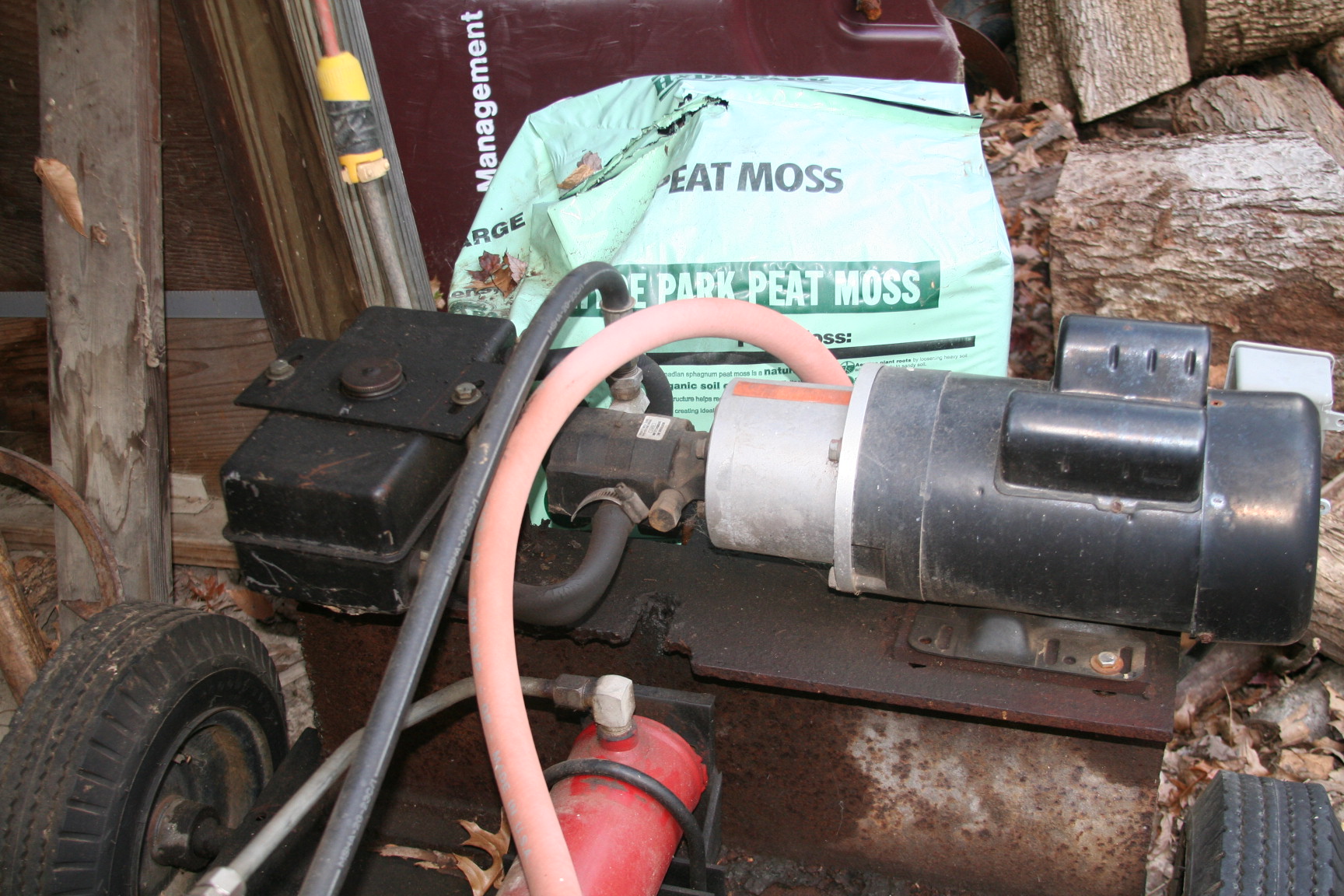

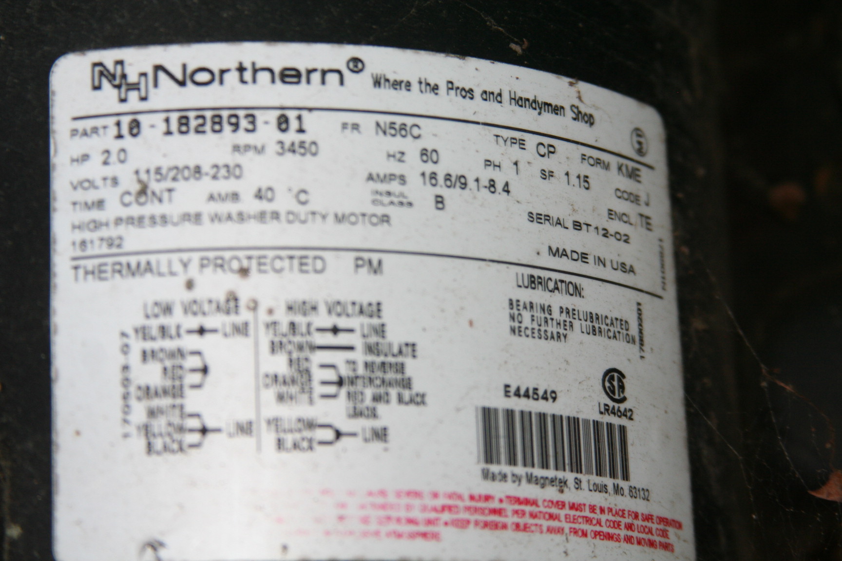

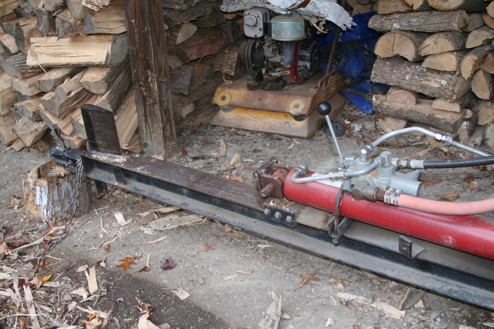

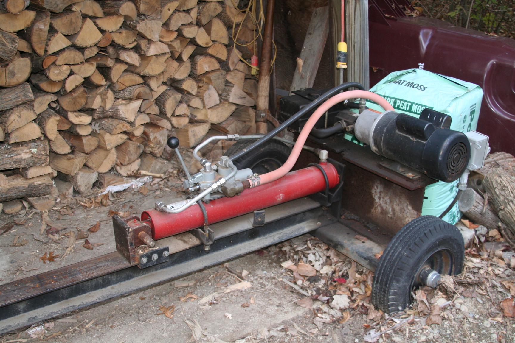

/ Electric Logsplitter #7
pictures

As far as the bearing goes , motors are used like this all the time. Almost every air compressor used a motor belt driving a pump.
At 1725 rpm You would get 1/2 the flow for sure and I don't think the pressure would fully develop either. Efficiency due to bypass slip. This is intuitive , the experts can explain it better.
