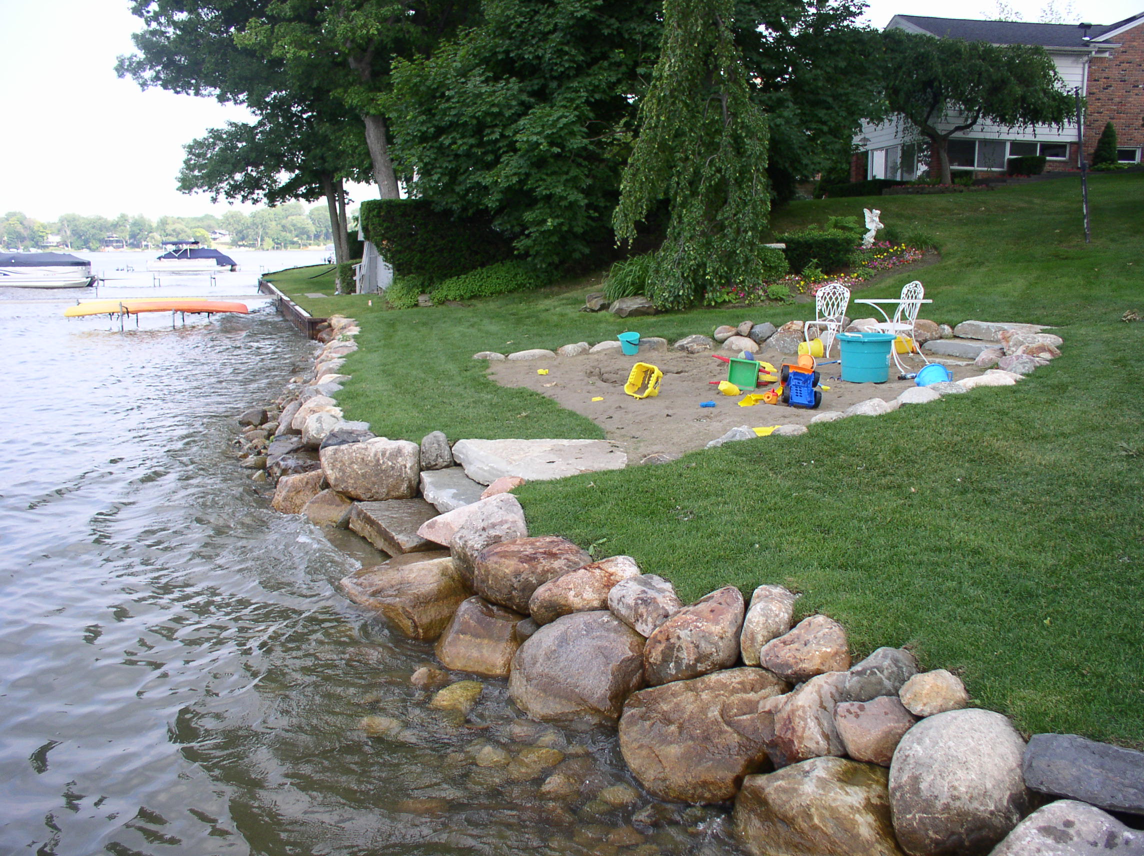

Piston, I appreciate the information you have assembled on this site. Very informative. I too feel as though a grapple for my 2000 JD 4700, with 400CX would greatly speed the process of my project. (buildng seawall with large boulders, then with rock/rip-rap behind these larger boulders, and eventually feathering into the lawn) Right now, I planned to use either my forks, and or the bucket. (both from EverythingAttachment's)
I wanted opinions on using the FEL with grapple, and the speed it would afford to this type of job, as opposed to the forks/bucket method. The size of the rocks are 18"-36" boulders in front, with 3"-12" sized rocks (rip/rap) to fill behind the larger boulders.
I also was interested in the difference between the WR Long vs Everything Attachment's Electric over Hydraulic kits', for a grapple, if there is anyone with experience with both.
Given the installation, (I prefer to mount the valve body with a bracket, instead of welding it in place) is there any reason to consider using hardlines, up to the QC point, at the very front of the loader? {instead of the flexible hydraulic hoses sold (included) with these kits} (between the valve body, and where the grapple would attach to hydraulics) (longer service life, less chaffing, etc)
I have attached a picture of the project I intend to create. The challenge, and advice I was seeking, was to identify best method to get these boulders down a 20% slope, and approx. 100' from where the truck will be able to deliver them.
