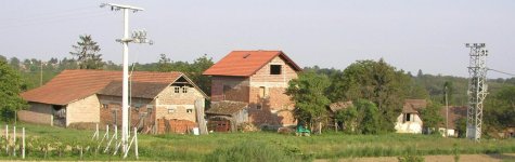

Here we have power lines 3ph 10.ooo volts (phase to phase, no neutral) and transformer in every village (125-250kVA, depends on village), and distribution is run mostly by cables on poles, 230/400V, 50Hz.
All sigle phase consumers are 230V here, all motors above 3hp are 3 phase, and just need 4 wires: L1, L2, L3, PE, and not neutral.
On pic is shown part of 10kV power line with sectioner/isolator on pole, "pole" transformer, and low voltage cables going from transformer to poles. Sorry, haven't better picture

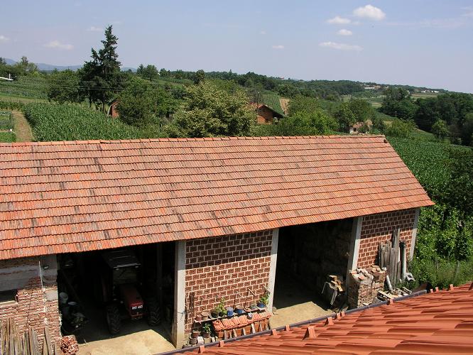

On left side of the pic is our stable for pigs and cows (when we had it) joined with barn (wider building). It is long about 100'. On right side is our house (in rebuilding phase still).
Yes, all buildings are made of brick and concrete. Majority of them are covered with tile (ceramic, and some with cement), and some withother type of cover. Shingle is not so common here. Some people had bad experience, and now is rarely used. Ceramic tile is traditional roof cover here.
On left side, close to front wall, you can see pile of tile from house, and it will be used to cover some new barn additions.
On enclosed picture you can see a sight from house roof to front side of barn.
