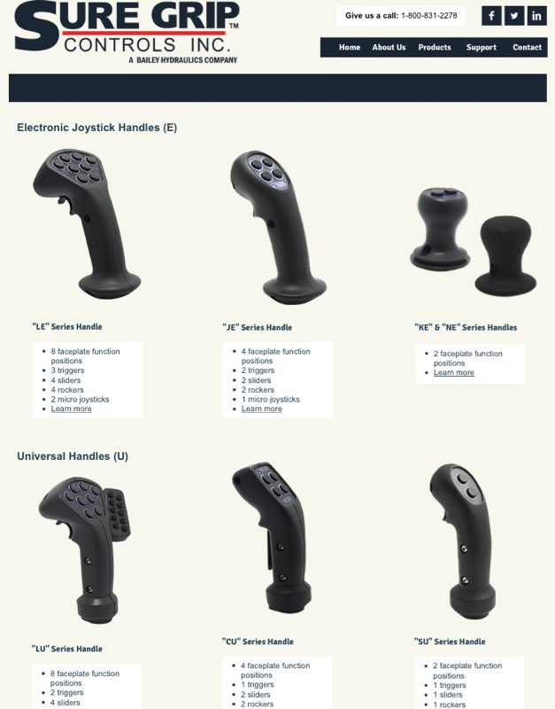

Hello, I am planning on adding a hydraulic thumb onto my JD 70d excavator. I have been unable to find a comfortable add on switch to power the electric selector / solenoid valve. I want to have it on the bucket joystick and be easily reached by thumb or finger without moving hand off stick. Really be nice to unscrew ball on end of handle and replace with handle similar to newer skidsteers. Open to suggestions? Thanks, Craig
/ Electric switch for joystick #2
I have had to improvise such things. Machining, adapting and welding. My number one resource (now) is E-Bay. Even if you can't find what you want, sometimes you can get the name of manufacturers, that you probably wouldn't see with those horrible hijacked and Ad filled Goggle searches.
I see some guy on E-Bay has remanufactured Joysticks for various machines for just over a couple hundred bucks, with switches. For what I have gone through in the past, that would be a bargain.

Thanks for the links, now I have choices and decisions.
/ Electric switch for joystick #6
I plan on doing the same as you to convert my mechanical thumb to hydraulic. I just discovered this yesterday:Cpi Weatherproof Switch, Push Button B7151-516 | Zoro.com
Couple that with this and it can attach to the joystick rod: Cpi Back Switch Housing HS2-52 | Zoro.com
That's kind of pricey but I'm sure it's less than a custom made knob.
Another idea I saw was to get an auto shift knob with a switch built in.
I plan to also use a toggle switch to switch from always on to being controlled by the push button.
