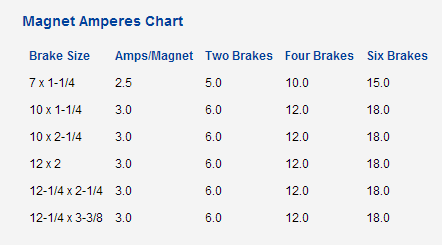

Here's a chart showing the amps draw for the size and number of brake magnets that you have. This can be tested with an ammeter as discussed above. You will need to disconnect one brake and put the ammeter in-line to measure the amps.
Be careful not to exceed your ammeter's rating. Many home-use multimeters support up to 10 amps DC. That would be exceeded with four 10.25" brakes, for example. You can test individual brakes by disconnecting them and then connecting them one at a time.
