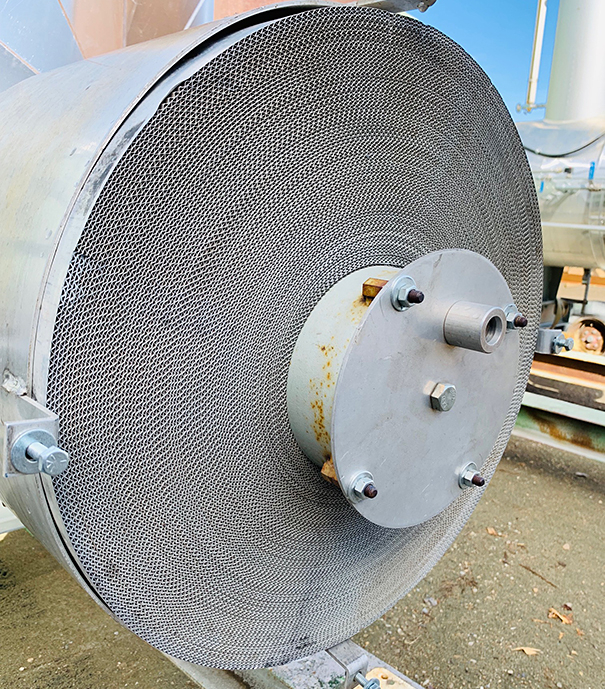

The lower limit for ignition (LFL/LEL) is about 2.1% for propane, and 4% for natural gas. Since natural gas is lighter than air, it tends to rise, and dilute itself, lessening the chance for ignition. Propane vapors being denser, sink, and build up in low points, getting to ignitable concentrations faster for the same amount of gas.
I see more water heaters now with built in wire mesh covers on the flame areas to prevent (reduce?) the ignition of flammable vapors.

Flame arrestors.
