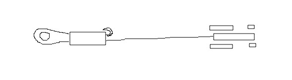

Here's an old diagram I made. May be easier to fasten the chain to the pipe.
Some photos here in the first several rows.
Bruce

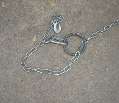

This my solution to grabbing saplings and brush by the base, Could not find a suitable ring at local hardware emporium so I made one...
Dale

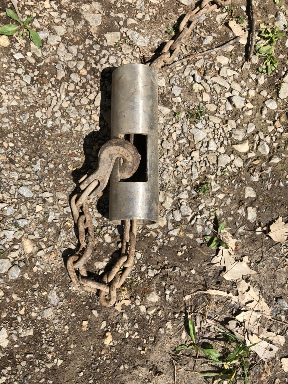

Please tell me more about how you use the short piece of pipe. I'm always looking for better ways to pull out shrubs and bushes from wet areas. Thanks! :)
I cut a slot in the side of the pipe for the hook. This makes it easy to wrap around and connect then disconnect after. The pipe allows the chain to choke the load and uses the pipe edges to bite and help keep from slipping. Usually use pipes at either end of the chain to pullout multiple saplings or clumps at a time.
Easy way to make a grab chain hook into a choke chain. Plus easy to undo.
In the spring you can about shuck the bark off a tree with your bare hands. In the fall it about takes a crowbar. Old timers who cleared land know all to well.

Thanks (y) nice to learn a new trick, that looks very effective, I will be trying that!
