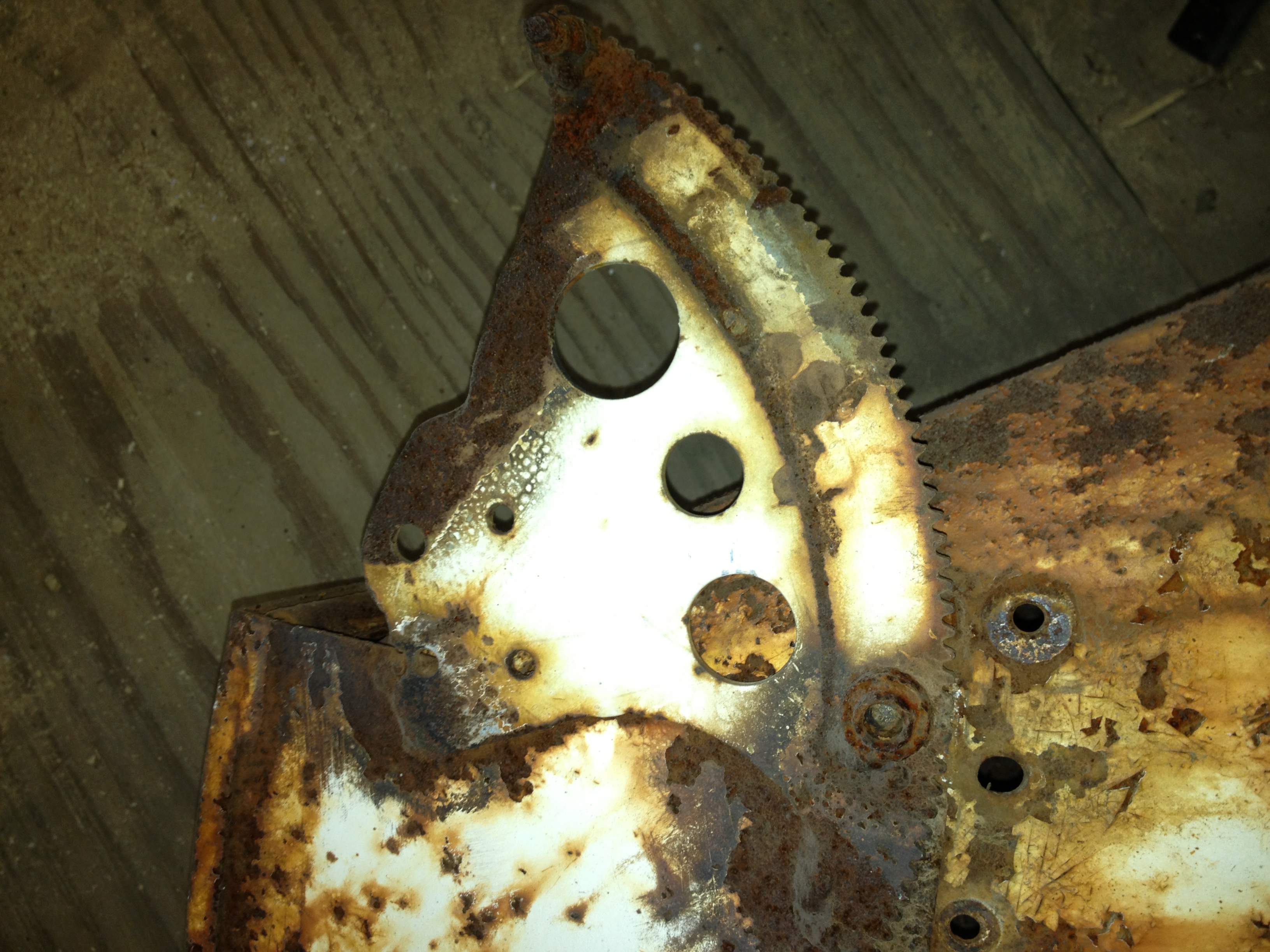

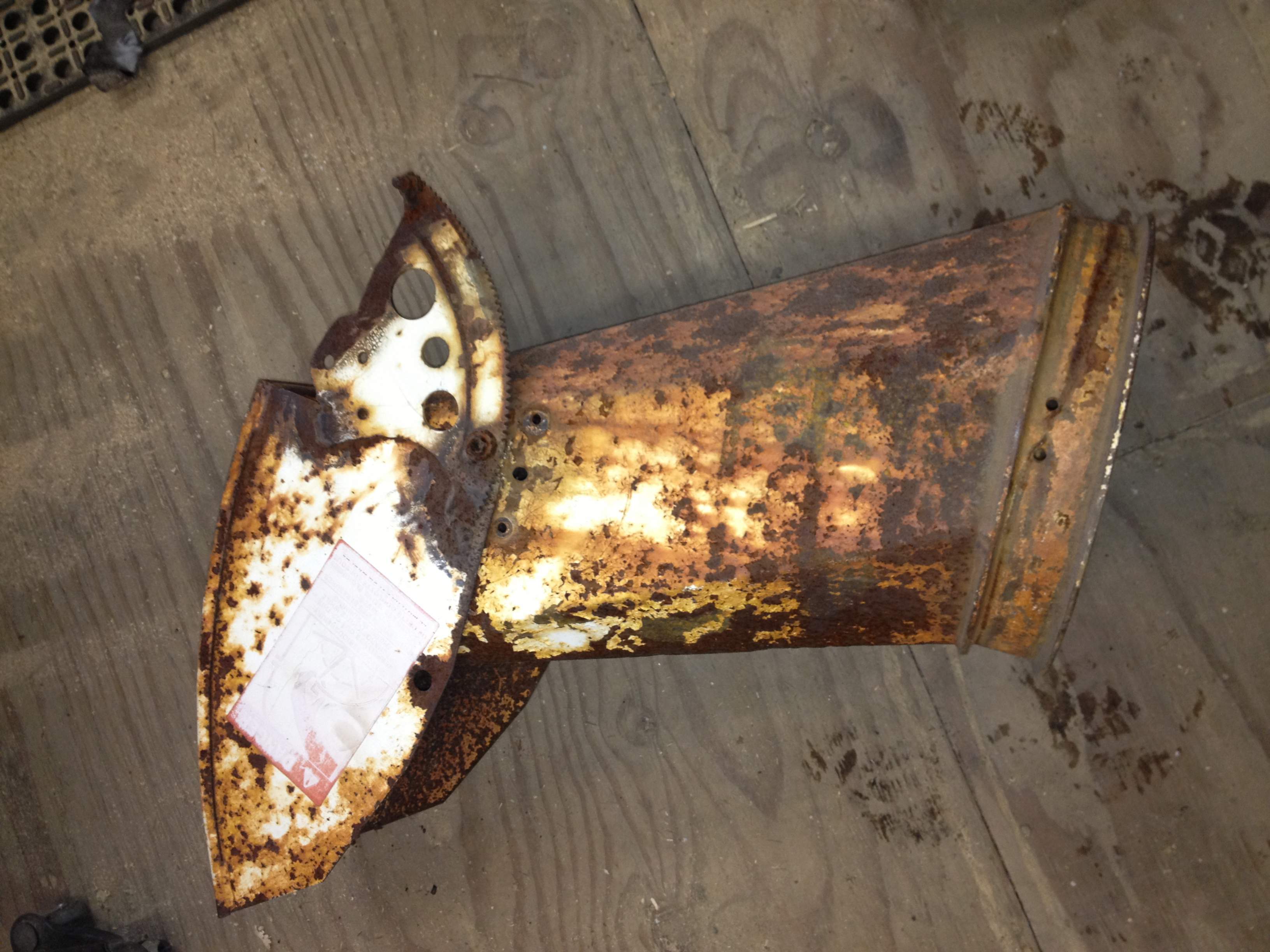

I looked for the window regulator arm but could not find it. Here is a pic of the part I am talking about. window regulator.jpg it is the arced part with the "teeth" on it and I removed it from the rest of the regulator and welded it to the deflector and bolted the motor to the chute.

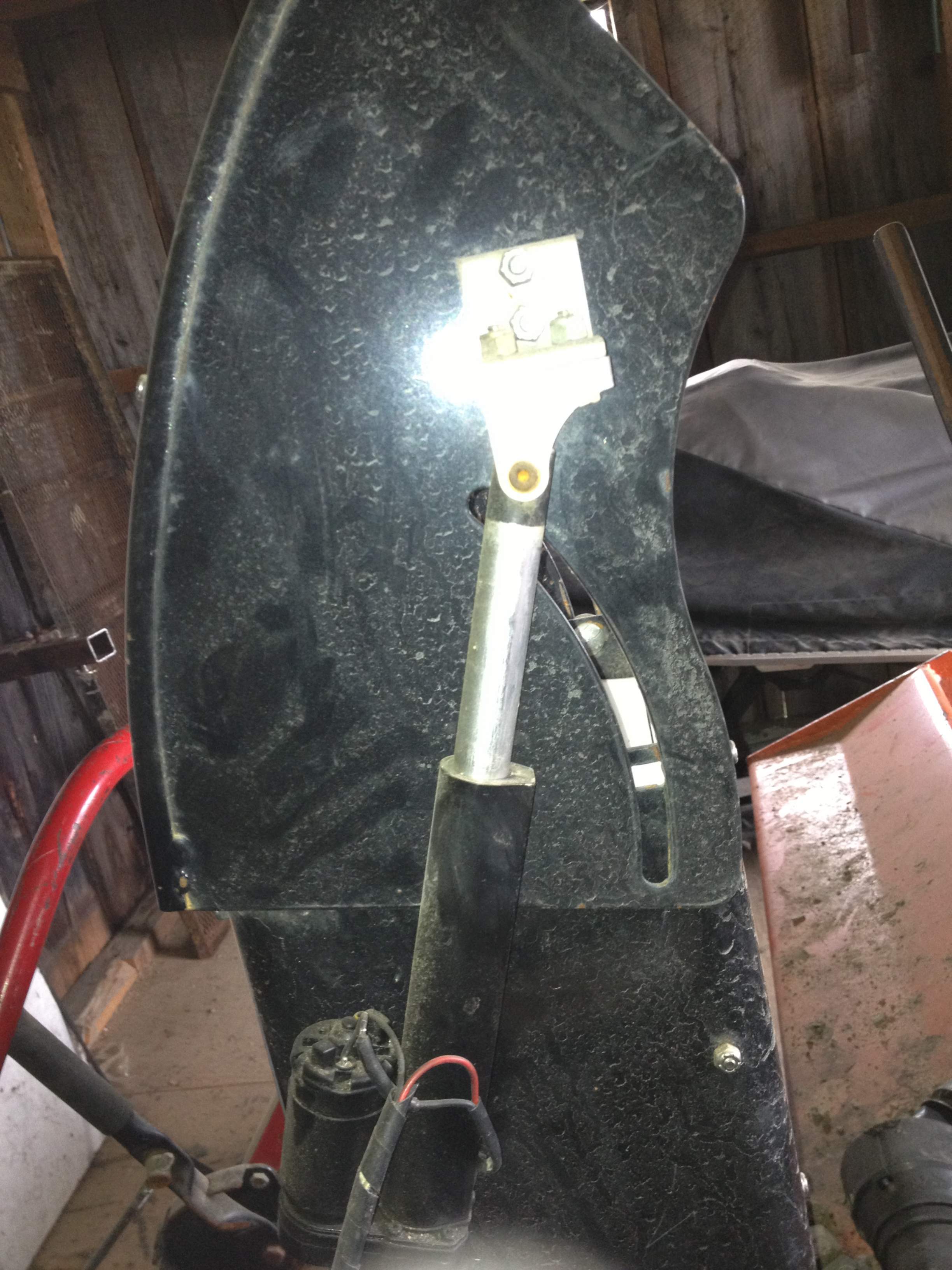

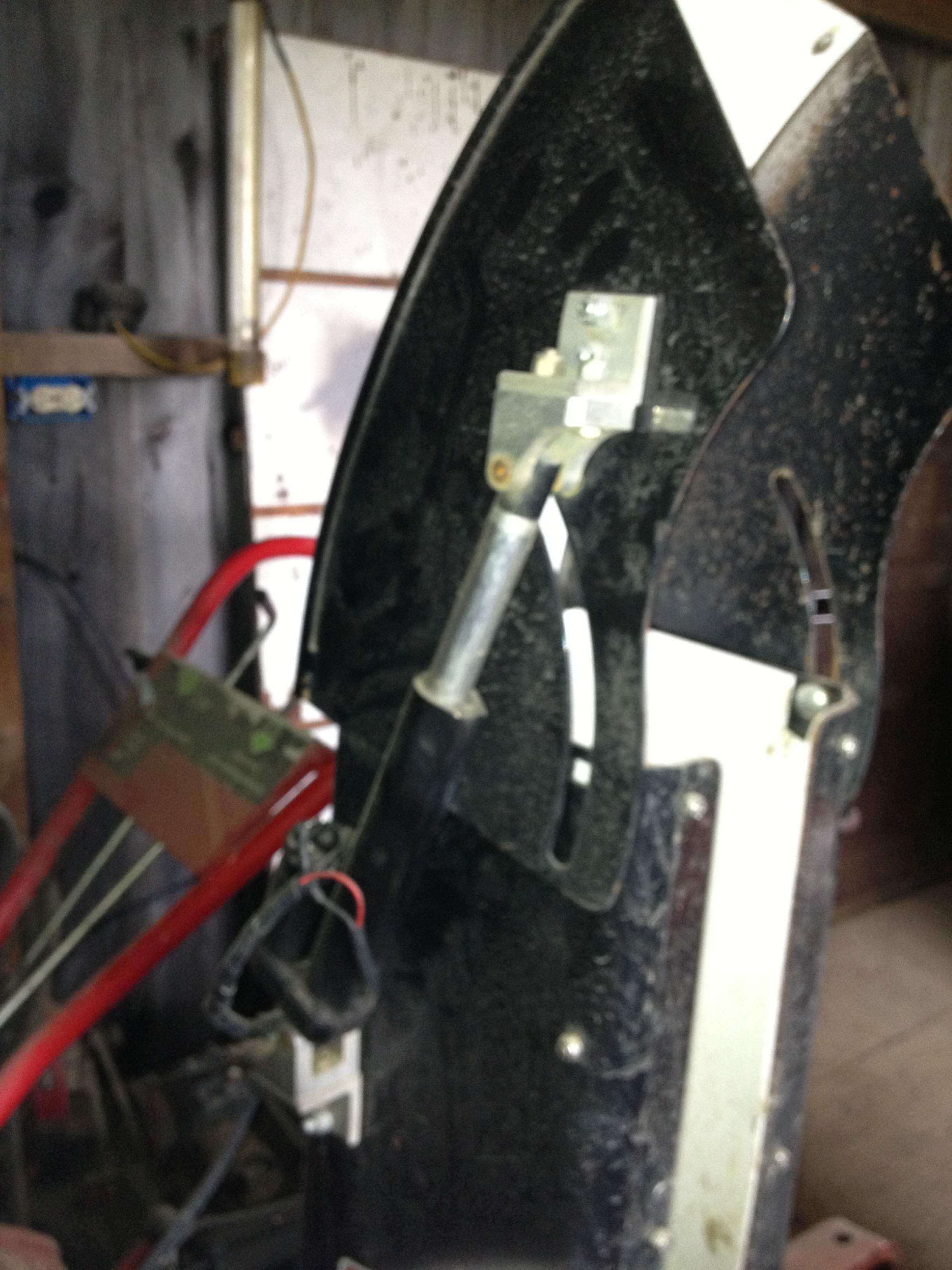

On my newer snowblower I used the linear actuator, here are the pics of that.image.jpgphoto.jpg

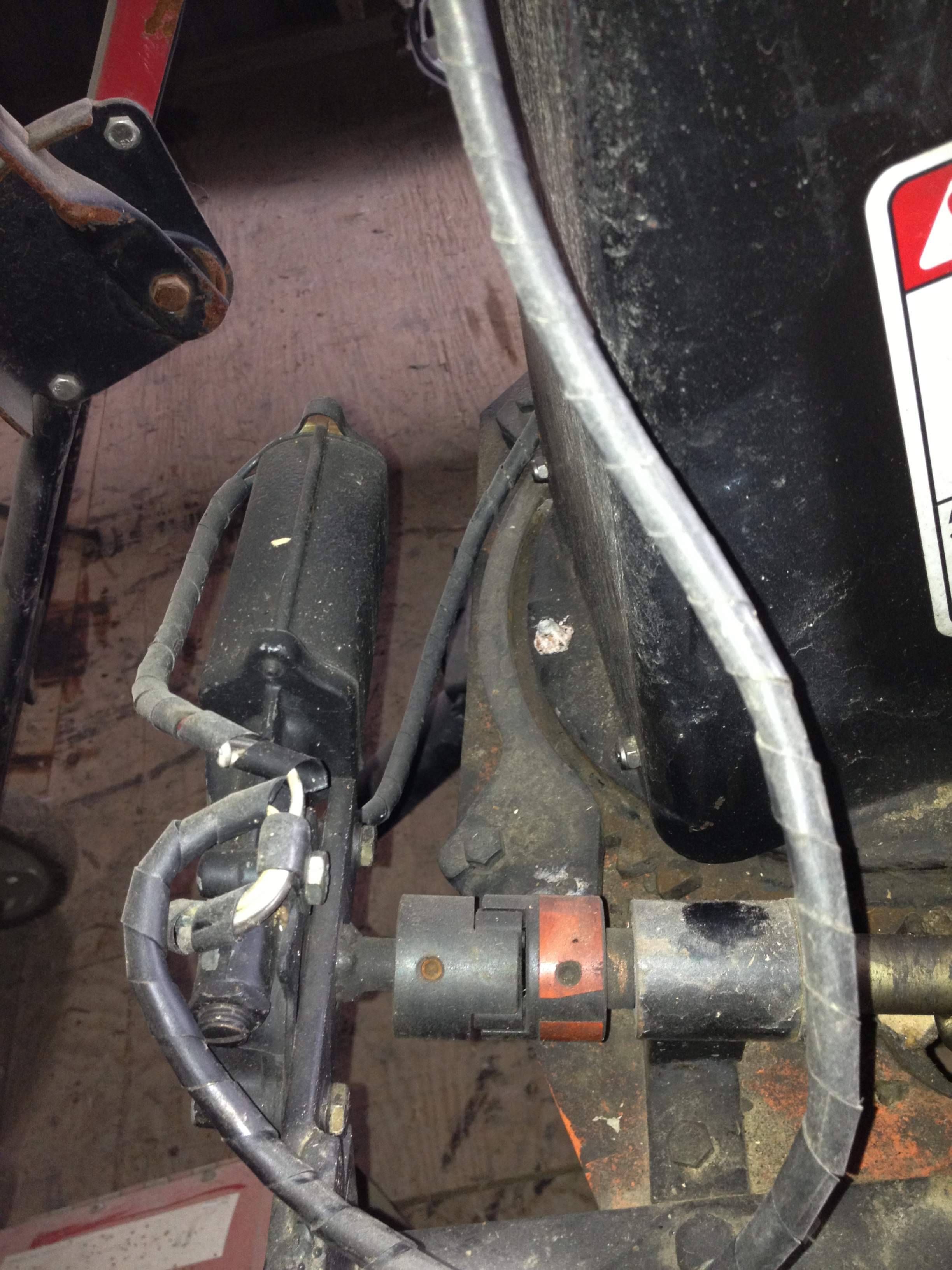

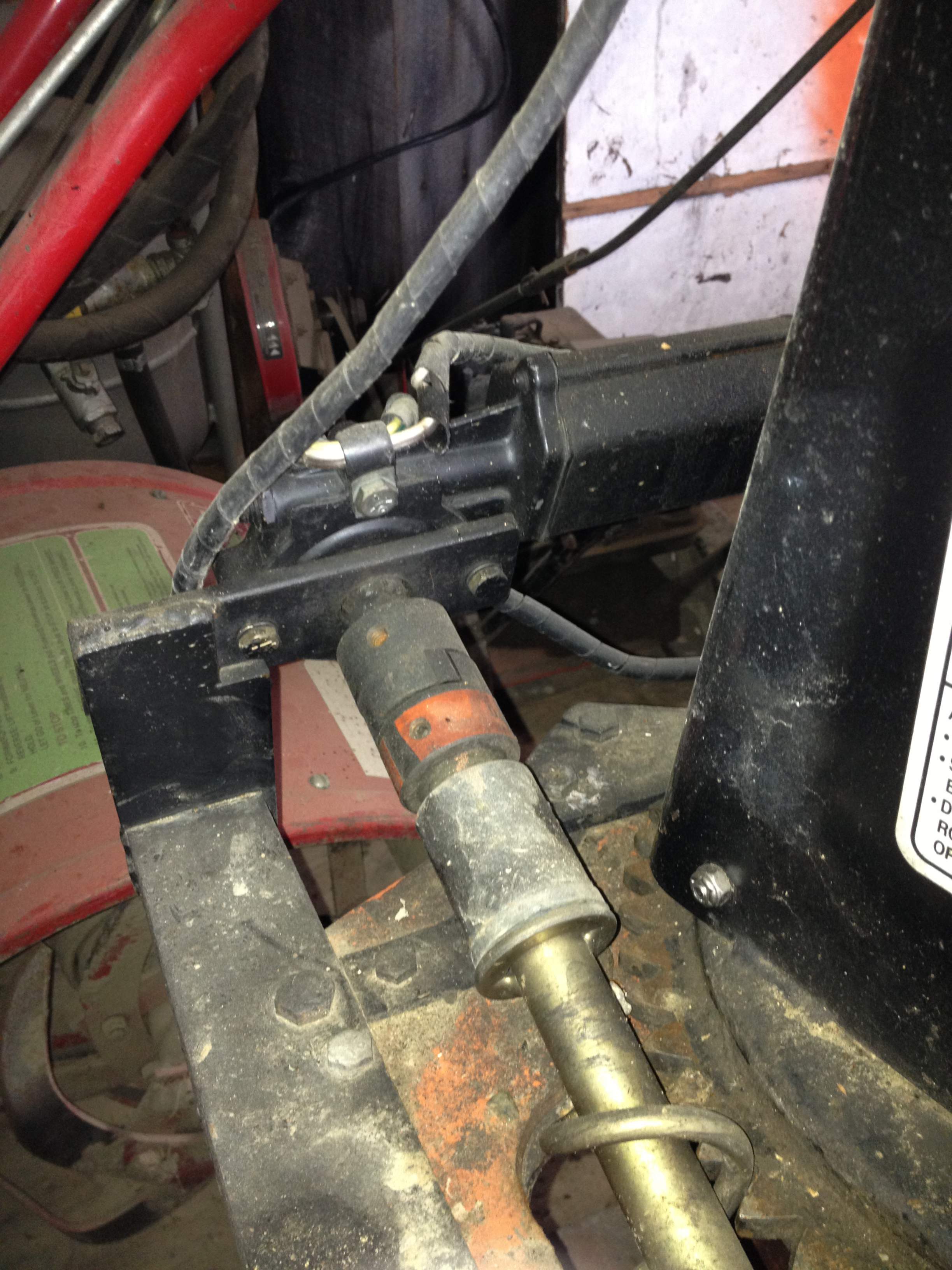

here are the pics of how I used a window motor to rotate my chute image - 3.jpgimage - 4.jpg I put a small piece of round stock in the tube part with the screw on it and attached a love-joy coupling to that and the motor to connect the two.I have had it for 8 years and no problems! I do keep my tractor in a garage so all snow melts off but my old tractor I kept in an unheated garage but swept all snow off after each use.

I went out to the garage yesterday and found my old chute of the snow blower and it had the lift arm part on it so I took some pics for ya. I remember that I had to mount the motor in a trial and error type test. The motor I mounted so that the deflector would not contact it in it's swing travel then held the "tooth bracket" and rotated it to make sure it had enough travel to move the deflector which wasn't too hard. I purchased a front mount for my Kubota B7510 from a dealer that quit selling Kubota he had it in the show room and could not return "whole good" so I got it at a great discount it came with the chute and rotation screw so I converted my older blower to the newer setup and no longer use the old chute. image - 3.jpg image.jpg photo.jpg
