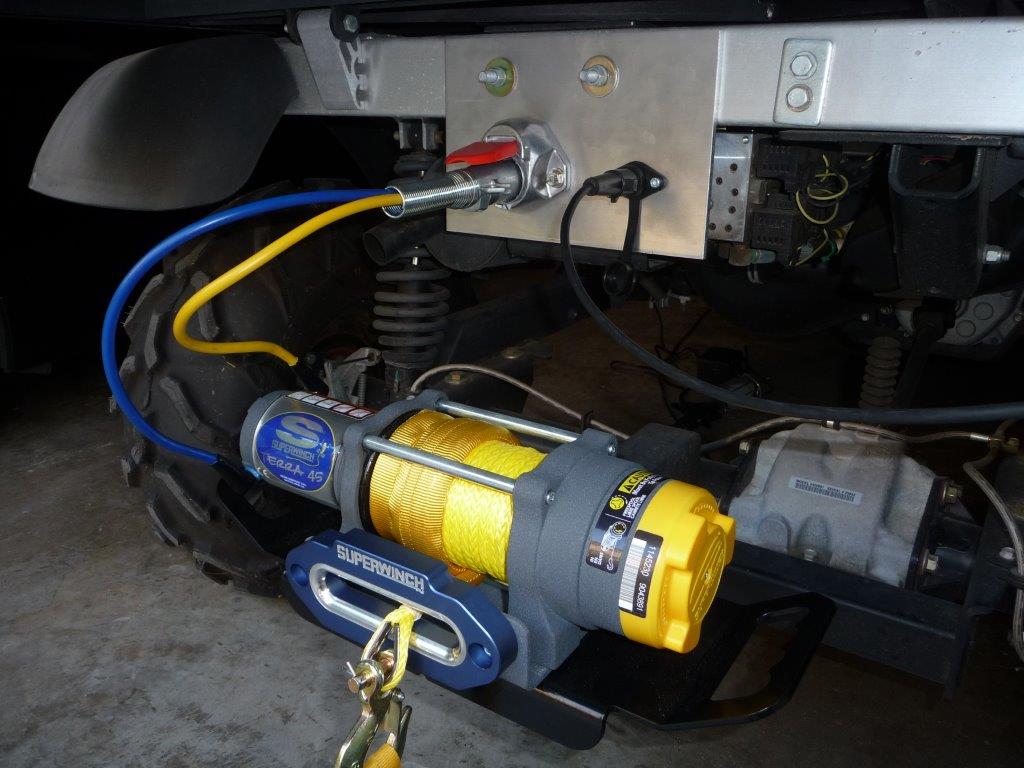

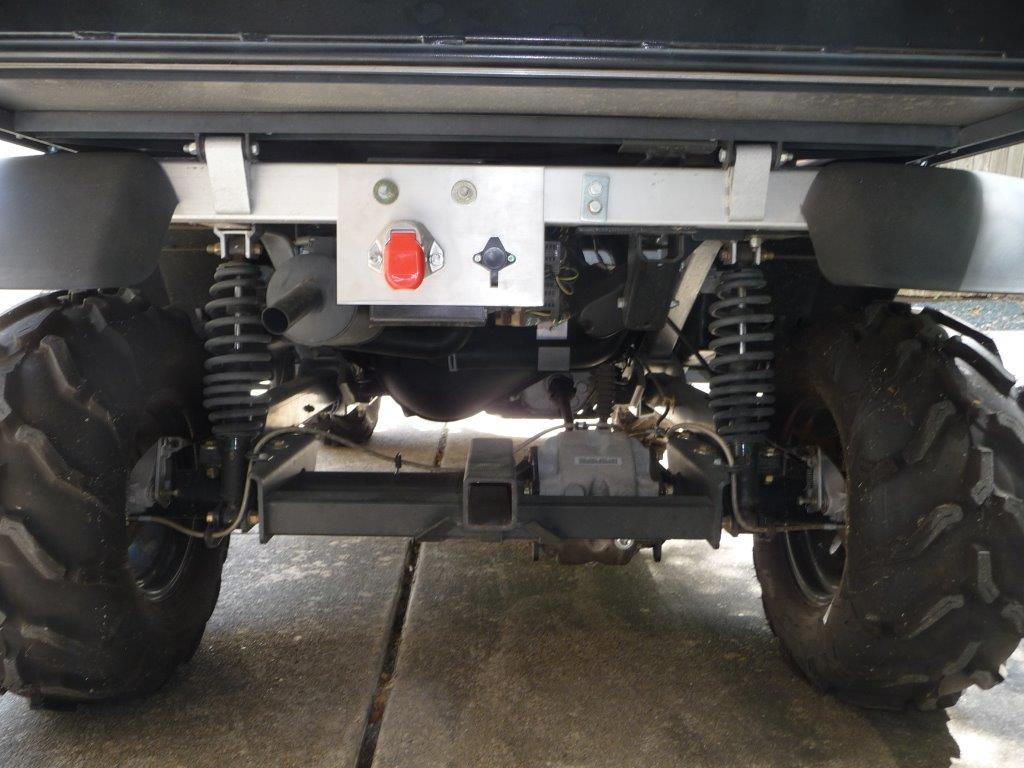

I was reminded the other day how convenient our winch electrical connection is to use. I thought that I'd show the setup in case it might help someone else.
We only occasionally use our light-duty winch, so a receiver mounted unit seemed like a good solution. I wanted a permanent wiring setup where there weren't any loose wires dangling about on the machine and the connectors were protected when not in use (photos from seven years ago before first use).
The power hookup set is called a "tailgate connector". About US$50 on Amazon.com. A lot more than a winch plug, but...
https://tectran.com/dual-pole-plugs...ors-dual-pole-buffalo-plug-bull-nose-sockets/
Chris

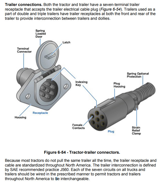

There is some misinformation in this thread, and since I started it I want to keep it accurate.
As Dale noted, the Tectran connector shown in post #1 is rated for 200 amps. It is definitely not "light duty". It's big and beefy and metal, with a spring strain relief for the wires. As far as I can tell the main use for this style of connector is to provide power between a semi-trailer truck and trailer (see attachment). The two-pole version is used to provide power to a powered lift-gate that a delivery truck might use to lower your delivery down to ground level from the trailer box height.
The "winch plug" or "Anderson plug" connector suggested in post #2 is the standard thing used in winch applications. The Amazon link in that post shows a "recommended maximum 120 amps" current. The items linked in post #6 shows a maximum 175 amp rating.
The specs for the Superwinch Terra 45 winch show a maximum of 178 amps draw.
Seven years ago when I installed this I debated using the Tectran unit or a traditional winch plug (Anderson plug), which I knew was the standard used for hooking up winches. I was confident that for my limited short duration usage that either would work. Under the box of the UTV I had space to mount an aluminum plate into which I could surface mount connectors for the electrical and winch control. I don't recall being able to find a winch plug (Anderson plug) at the time that I could surface mount, but I see now that these are available online. Isn't the Internet wonderful. If I was doing this again today I'd still use the Tectran unit. It's a big satisfying metal plug that is easy to grab and metal receptacle that I know won't break.
Chris

OK> so that is a tractor trailer plug that you repurposed for a high current plug. BUT that plug you show is not made for a 2 circuit High current device it is made for 7 lower current circuits. I am trying to understand how you wired it. Did you double and/or triple up on some of the pins? Help me out here.

Ok, I see now... your original post link goes to a two prong high current plug. but your thumbnail in post 8 shows the 7 pin plug.. got it now.. tnx.
That's it, James.
The same style (form factor) of the plug and receptacle is used for many different pole (conductor) configurations. On this page there are listed at least 1, 2 and 7 pole connectors that I believe all have the same "housing".
