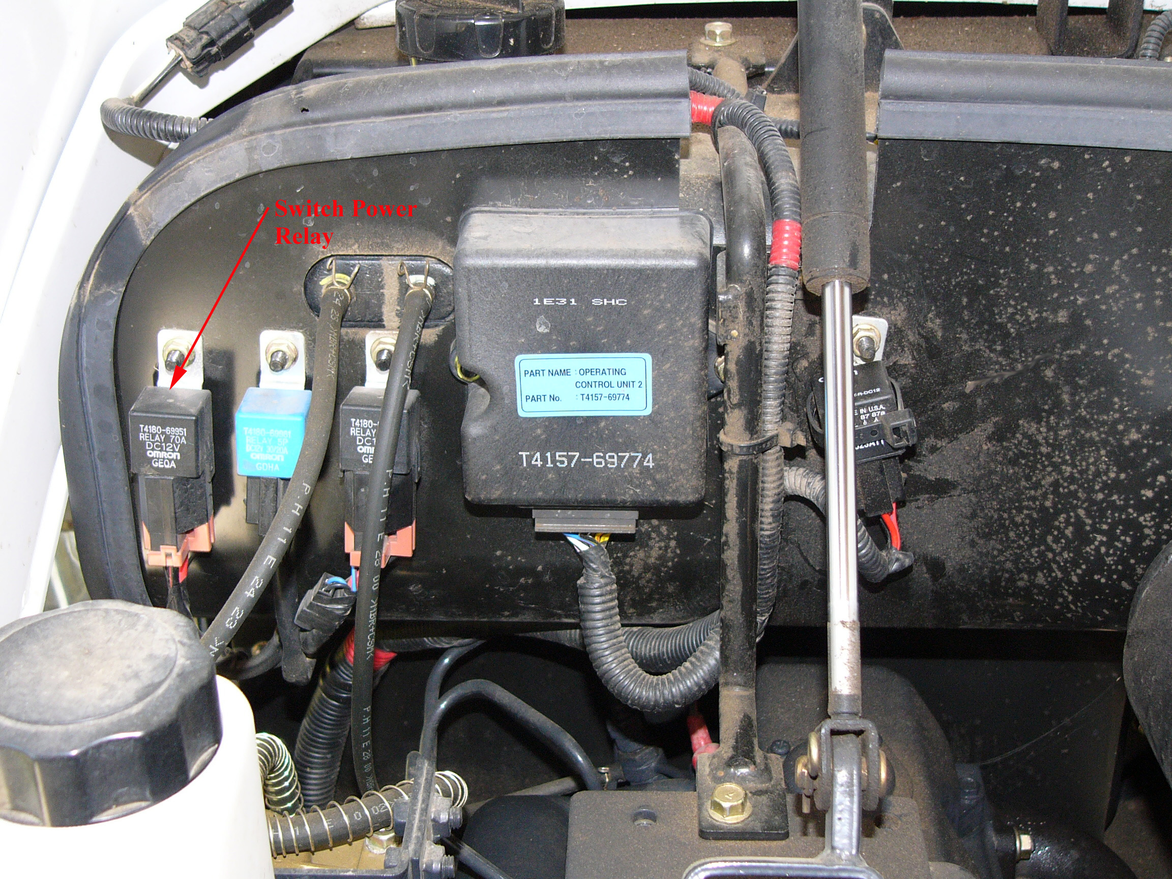

I notice that nobody has responded to your query and don't know if you've already found the problem
but if not, you might try replacing the switched power relay. I had a problem with the same symptoms
a few years ago and replacing the relay solved the problem. At that time, the problem wasn't intermittent.
Now I'm experiencing a similar problem but it's intermittent. Hopefully it's the switched power relay again,
but I haven't tried to fix it yet.
Hank1981 - If you're reading this, you might try the same fix.
