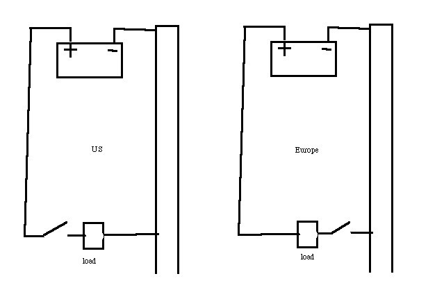

   / Electrical question about the direction of D/C current flow #19
Like this? Any reason one is better than the other? <img src="http://www.tractorbynet.com/forums/files/parts-repairs/385248-electrical-question-about-direction-d-switchedbeforeafter-jpg"/>
Yes, there's a big reason why one is better than the other. When you put the switch after/downstream of the load, how do you turn off the device if any of the wiring between the load and switch shorts to ground and has an alternative path that bypasses the switch to the negative terminal ? Not being able to turn off device can be dangerous
   / Electrical question about the direction of D/C current flow #20
I get what you're saying, but then the converse must also be true. If the switch is on the power side, how do you turn off the load if it shorts to power after the switch? It's the same issue as having the switch on the ground side and the circuit shorting to ground. Regardless of where the switch is, if it is bypassed the circuit will unintentionally run.
There's no actual benefit one way or the other. It's just a psychological comfort, based on what one is used to.
