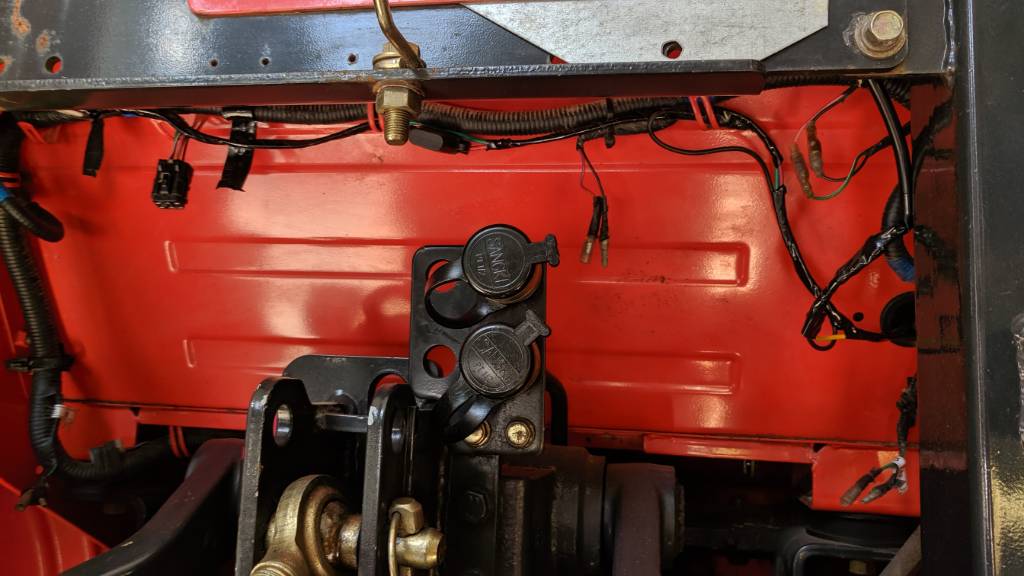

Just purchased a 2019 CK3510se hst and have a question about the electrical wiring. I have the kioti orange canopy also.
I want to add a couple additional work lights (forward and backwards).
I see just behind the drivers seat are two wires that have nothing attached to them. One on the left side (as sitting in seat near left elbow) is a bullet connector(s) (male and female). The other has a kioti connector (kind of like an ampseal 16 connector).
Questions.......
What are these wires originally used for by kioti?
What is the electrical limits of the wires?
Can I use these wires for LED "off road" light bars?
Any suggestions are appreciated also.

You'll have a lot better luck with this question if you could post a few pictures of the wires you're talking about.

I do not have a 2019 CK or a shop manual electrical diagram and hopefully someone with those will provide an accurate answer, but here is what I have discovered.
I have three connectors at the rear of my 2016 DK (see photos)...
3pin on left- ground, 12v hot, 12v on ignition (I am using this for a rear work light and switch).
Black in middle - for trailer lights, gnd, running lights, left turn, right turn, 12v.
2 on right - dead. (One may be gnd). I may have to add a fuse or maybe a switch in a blank position on the dash to make these connectors work.

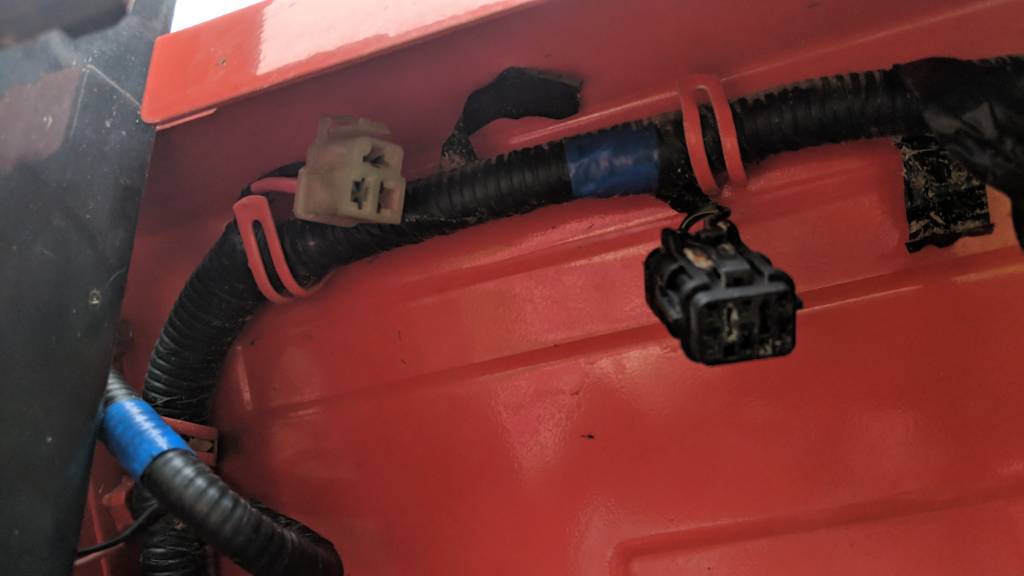

PEJ5 . . . Your photos are the same as my connectors I am asking about. The black connector is the one near the right elbow (behind the seat in the wiring harness). The two bullet connectors are the ones near the left elbow. I am sure they were used for the cab model for something. Just would like to know what so I can 'maybe' use them for lighting. Thanks all for your comments.

Here is the pin out for the black trailer connector (see photo below). They are only 18 gauge wires so they would not pass much current but should drive an LED work light. Connect the work light to positions 1 and 3 with an inline fuse (3 or 5 amps) and switch.
As I mentioned I also have a 3 pin connector with heavy gauge wires and that is what I connected to for my work light.
Finally, I have three sets of unused bullet connectors shown in the second photo - top right of centre, lower right and lower left. Does anyone has a service manual with an electrical diagram showing what these are to be used for? Not to steal from your question but someone must have a diagram that would help.

RadarRick. I just checked the two bullet connectors and they provided 12volts when the ignition is on so that would to supply a work light. From memory I thought they did not provide anything, but I was wrong. First time for everything.

I have a DK4210SE and it has a 7pin trailer connector at the rear as well as the white plastic plug and 3 pairs of bullet connectors. One pair of the bullet connectors are key power switched for a rear utility light. The other 2 pair of bullet connectors are for front utility lights. On mine these are wired to a connector in the steering column so you can just install a switch in the spare location. I had to also install a relay in the fuse panel for the front lights which has been a bit of a chore finding a relay that will fit.
I would also like to get a wiring diagram as the factory wiring for the switch had two wires going to the relay and I would like to know why.
