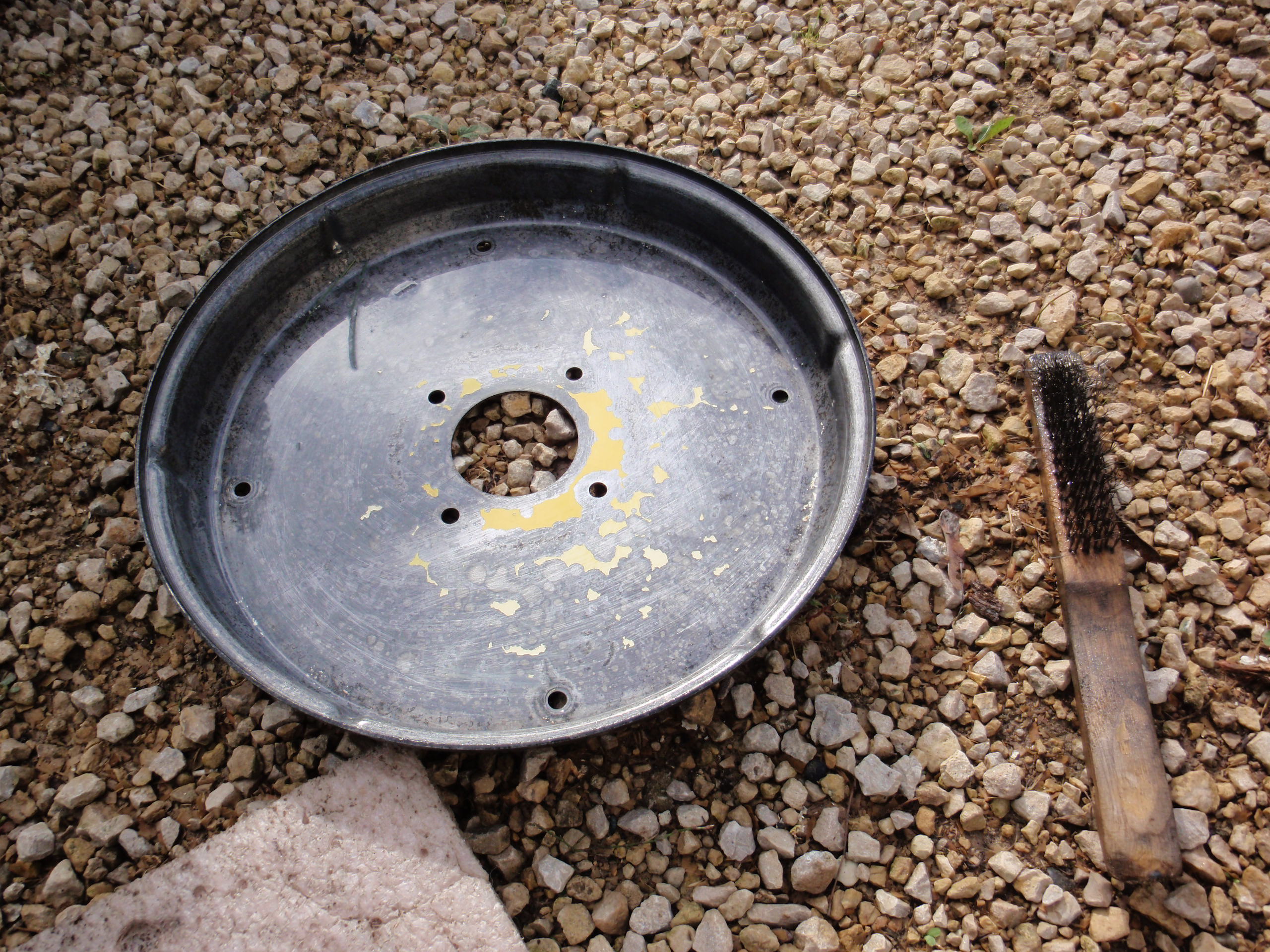

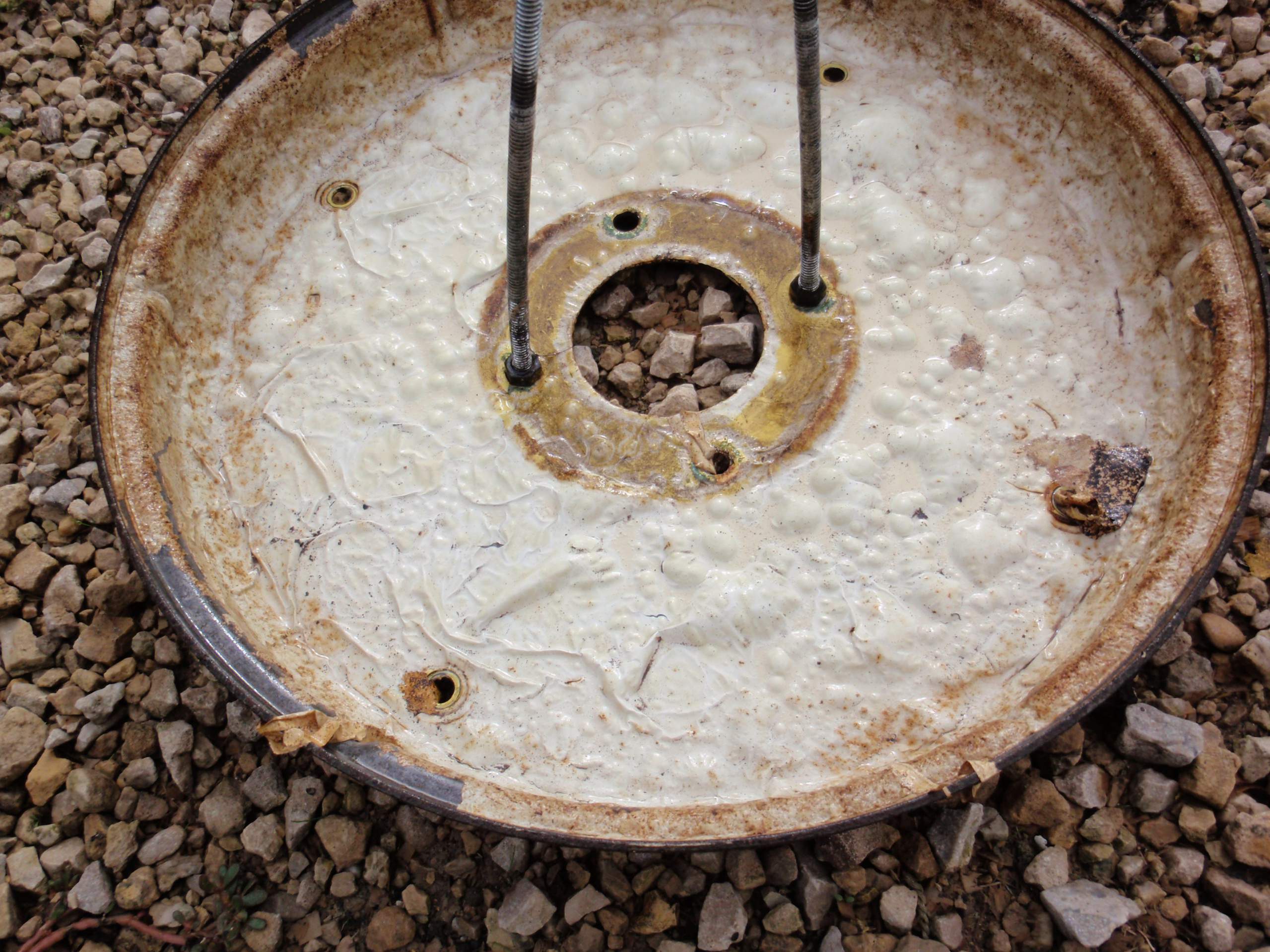

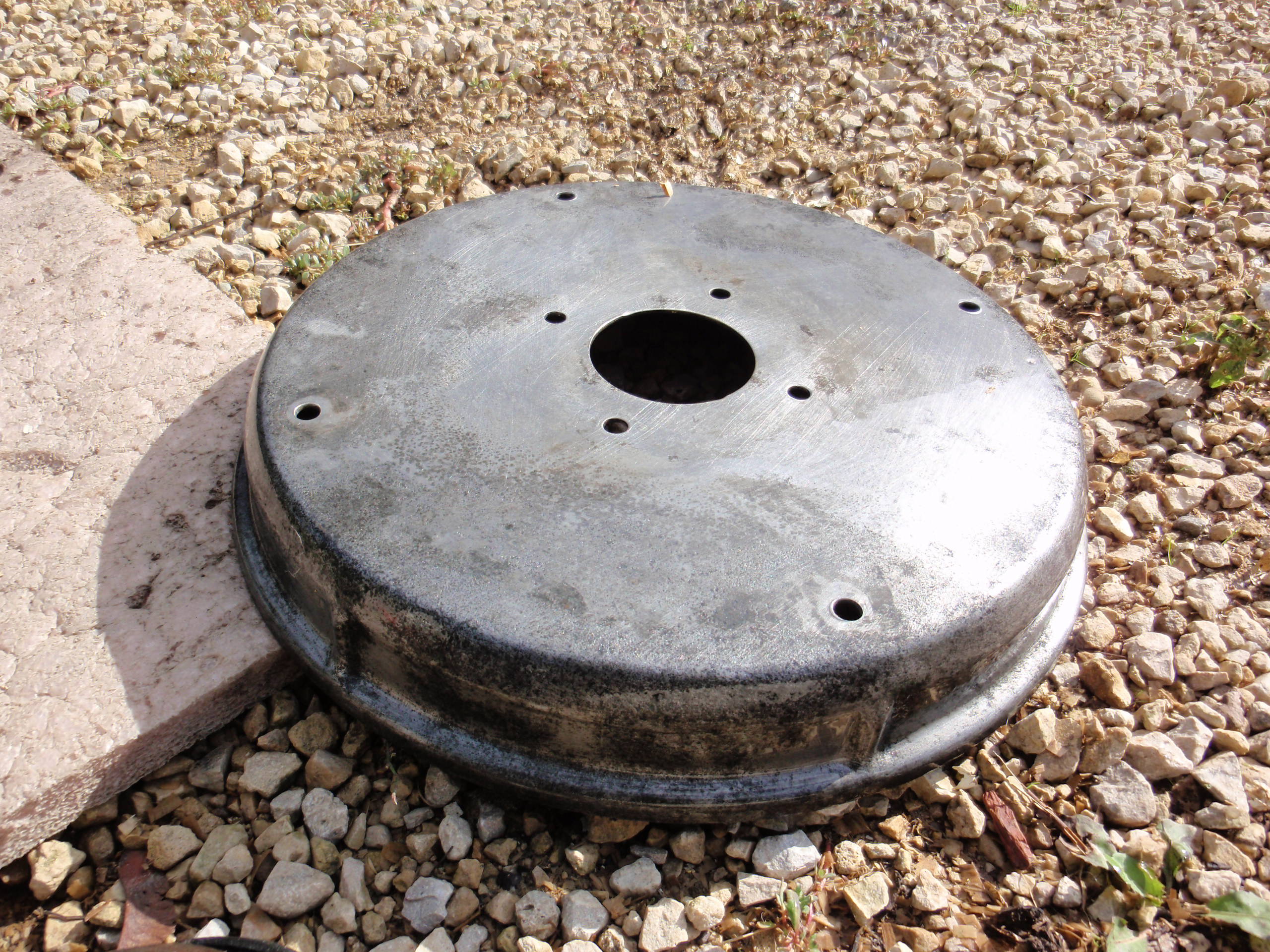

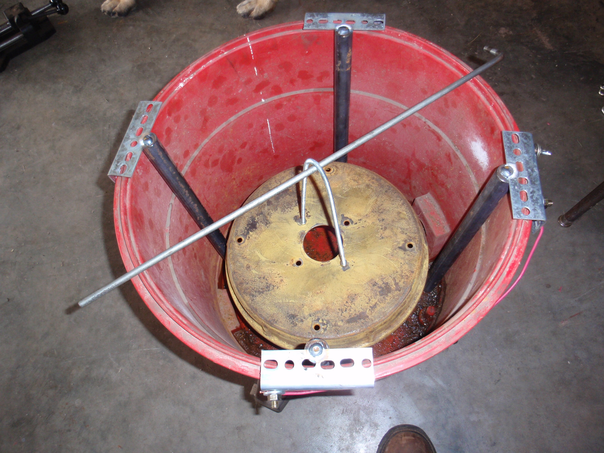

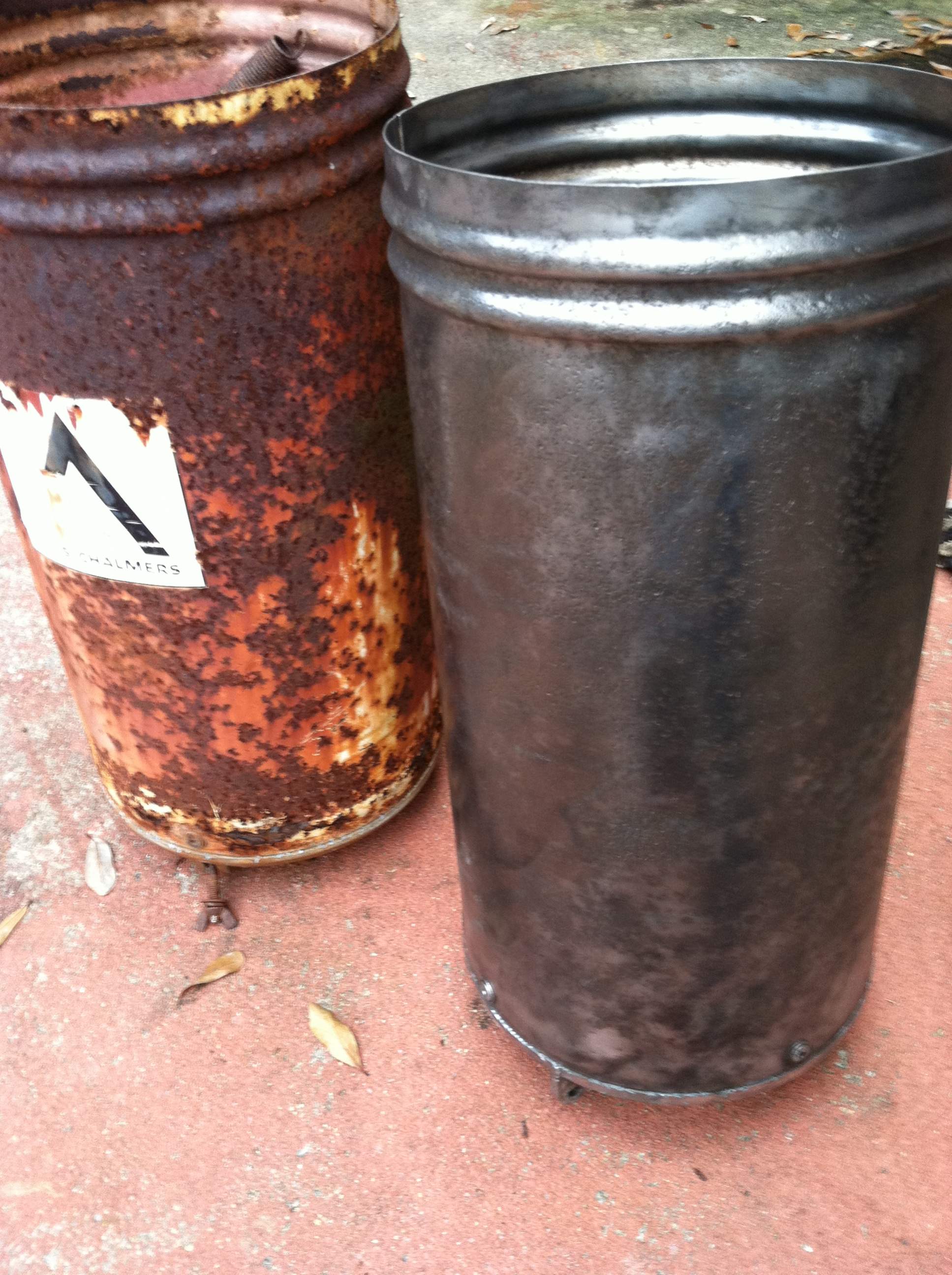

It's an amazing process. No need to use clean water as stated. Process is "line of sight" so must use multiple electrodes on all sides including the inside. Item cannot touch the container, electrodes, or sediment. I used a battery charger (2/10/50 amp) and used the middle setting. Let it sit overnight, remove, brush with a stiff bristle brush, and repeat if necessary. You can tell it is working by the thousands of tiny bubbles rising to the surface. And sodium carbonate is what to use, not bicarbonate.

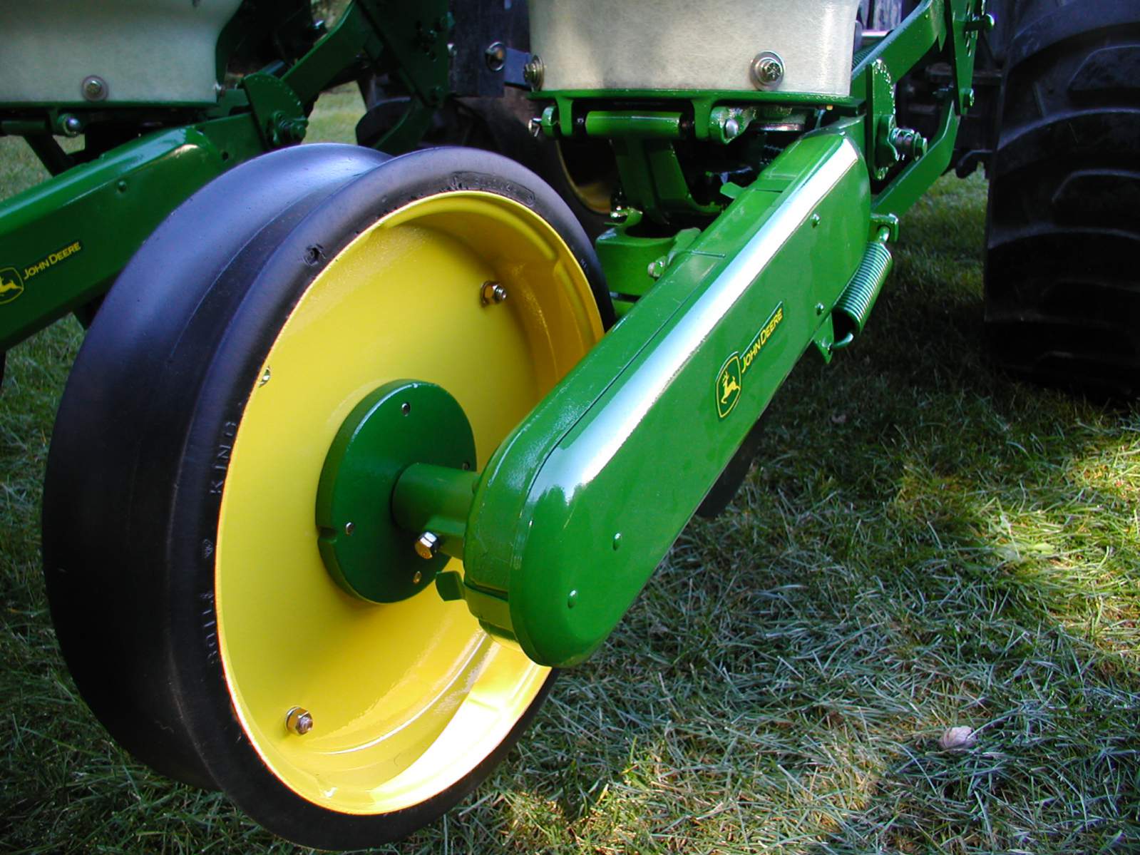

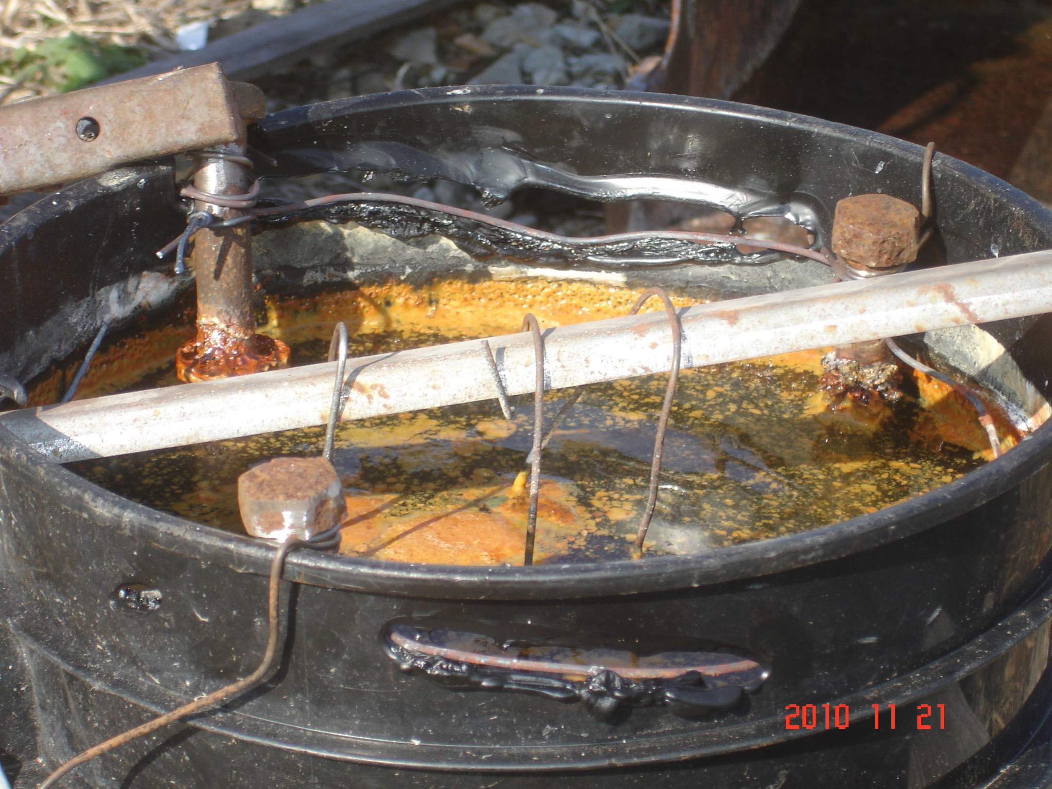

All info I have read and researched from multiple places calls for sodium carbonate. I can't speak for borax, but have used the sodium carbonate and know it works. I bought it online in a 5 lb. quantity. It's used in some cooking techniques ( pretzels, I think), also available from what I have read at swimming pool chemical stores, and in the form of "washing powder" from Arm and hammer, but I never found that product locally. All sources emphasize not to use standard baking soda (sodium bicarbonate). I googled it and found it easily and it is cheap! I agree that other chemical solutions that are conductive may also work, but I can attest to the effectiveness of Na carbonate. There's lots of info on this technique if you google "electrolytic rust removal."
It is an amazing process and is so simple . Rig a plastic drum or trash can like the one in a previous post. I used rebar connected with copper wire as my sacrificial electrodes. The rust and old paint can be just wiped off with almost no effort. The before/after pix I posted of those old hoppers, although soaked overnight for 2 days, took me less than 5 minutes of easy brushing get looking like that. And it doesn't harm chrome (unless undermined by rust). Best of all, it costs only pennies, and produces no chemical waste, just rusty water.

I agree you need way more surface area on the inside. You want lots of electrodes, spaced evenly, on all sides. And let it work overnight, then remove, brush and rinse the item, and use a long handle wire brush (like a grill cleaning brush) to quickly clean off the electrodes somewhat just to refresh them. Then repeat. My pictures of the seed hoppers took two overnight soakings to get that clean. Sounds like you need to improve your tub and make sure all the connections are good, and that there is more surface area of electrodes, and that they are more closely spaced. And perhaps some battery chargers may work better than others. I know some don't put out continuous current if they have internal "brains" that may be shutting off current when they sense weird flow. Mine is just a simple Schumaker manual one without an auto shut off feature. The key is the bubbles. If it's not bubbling, it's not working. (but bubbles are tiny, but profuse)
