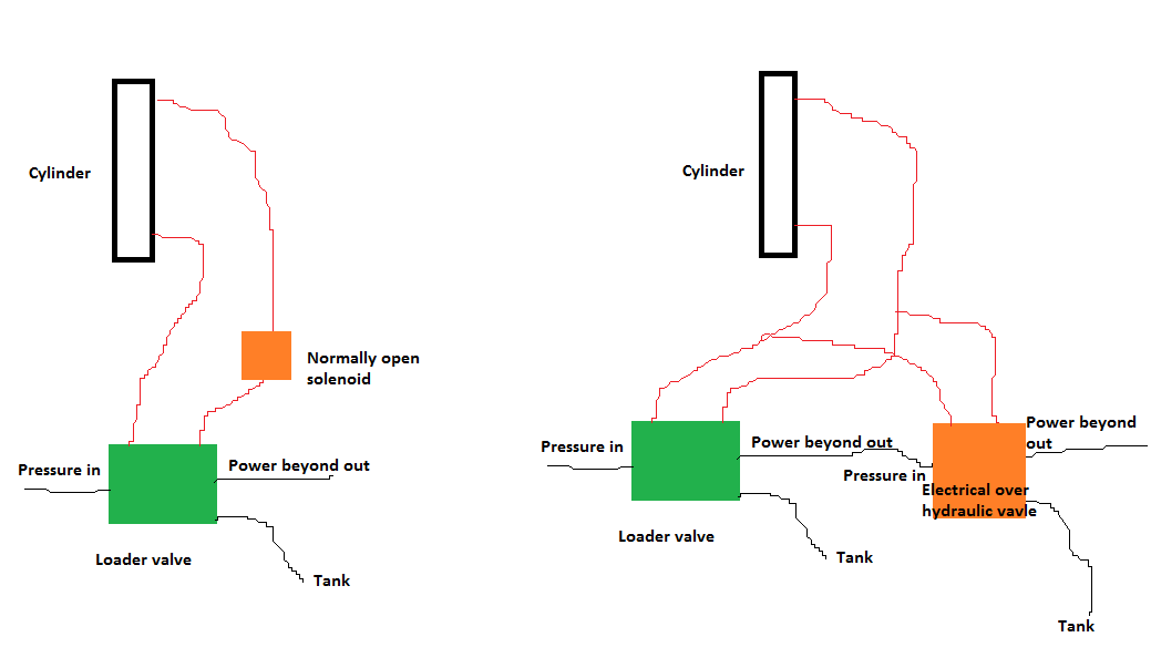

Your electronic FEL level indicator has me thinking. It shows level only when the bucket is on the ground, correct?
I would like to know when the bucket is level at any height. This would be handy with my QA forks. I wonder if there is a way, electronically, to show when the bucket or forks are level at any height? Electronic level indicator with display.
Got me thinking...
Mercury switch at a well protected spot on the bucket carrier with well protected wires running to a well protected light. ... Or just use a surface on the bucket as a visual reference. Totally rugged and will inherently accomodate all situations including uneven ground instances via parallel processing capabilities conveniently available in the brain.

Anybody know why self-leveling isn't common on CUTs? I'm assuming extra weight (and expense) for the extra hardware & geometry required for it & resulting decrease in lift capacity? Or extra electronics for the Kubota system on the smaller Grands.

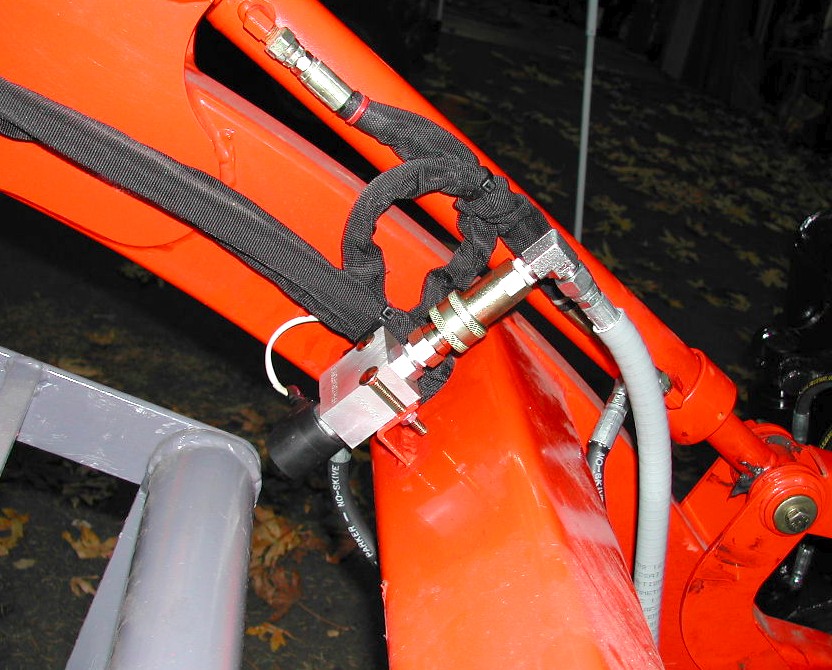

The electronic fel indicator works just like the factory rod with the bend in it. When your in the bend at any height or the green light is on at any height the bucket is level with the ground when the bucket touches the ground.
It is not like a self leveler mechanism that has arms and levers to keep the bucket level while your raising the arms.
It does however let you find level at any hight. When the green light is on with the bucket high over head it's dead level on the ground.

I think he has it so if the bucket is level at any height. I am looking for an inclinometer with a remote sensor that would work. Something like the attached but more tractory. Both x and y would give you roll too. The sensor would mount to the back of the SSQA frame, then just a cable to the operator station.
Tom I would be very surprised if that would work. I posted this earlier in the thread.
This is why I don't think it would work.
I think the problem you're going to find with the remote sender tilt setup is, your still going to need some sort of mechanical device to fix level even though you're not level with the ground. Just like the bend in a stock rod type indicator, once your in that bend it stays that way until you curl the bucket.
With a free floating tilt sensor on your bucket you won't be able to finally set level until your bucket is on the ground right in front of your work.
For example after dumping the bucket I set the bucket level again while I'm on the move with the Fel arms still coming down. I think with a electronic tilt sensor riding across the yard to pickup another load that light will be blinking in and out of level the whole way. Soon you'll say I had enough of these Disco lights in the cab. There has to be some sort of mechanical device that keeps it locked level with the plane of the tractor. Therefore the rod.
I don't know if you have an IPhone , but there is a tilt sensor App. Try it in your hands and see how sensitive it is, then walk around and hold it on zero. There is a damping on it which makes it even worse, makes it slow, so you have to wait for it to reach zero, then if you past zero you have to wait again to go back to zero. Since you can't see the meter you're working that curl back and forth hoping you'll stop at the right spot. Imagine that strapped to your bucket hooked to a light in your cab.
Plus on the sensor your looking for, you won't have the caution red arrow light to let know your coming up on level. Like the factory rod ,you can see your coming up to the bend.
On my rod, zero is fixed, that is the short groove. The longer milled grooves in the rod are for the red lights, that lets you know your coming up to level.
That is the reason for two arrows and one green if you past green you have to know which way to curl the bucket. So you need three lights. Not sure if a remote sensor will have that capability.

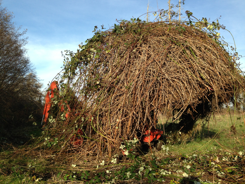

I often push trees and tree cuttings- over, under, past obstructions, pile them etc. It is a non structured activity. Many situations develop, some dangerous or potentially so that focus your attention and actions moment by moment as needed [you hope]. Its only so long til significant wood "touches" something thats out of position to be monitored or is not the prudent priority in the cicumstance. If that thing cant sustaian the blow or move its damaged or broken. You can call it doing something wrong, but the sensitizing issue is in offering yourself as a servant to fragility. Hoses are absolutely necessary, I wouldnt have them if they werent. Without redesign scrupulous routing is the only option, Still, they can move without damage and are pretty tuf when they have to take it. Iv had one fail after damage -- it made it hundreds of hrs past the life of the "level" indicator. I replaced it because there was no way to function without it. I used a better hose.
larry
/ Electronic FEL level indicator
#75
Thats a very good answer Larry, and I understand now the way you put it. I hear you, many times on my B3030 pushing brush, things happen real fast, like bending my factory step with a branch when I'm making sure I don't slide over the banking . Branches scuffing the paint off the curl pistons snapping back at the tractor. All happening even though your careful, your eyes are somewhere else important at the time and bang there goes something. Well, said.
