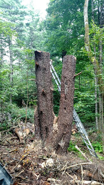

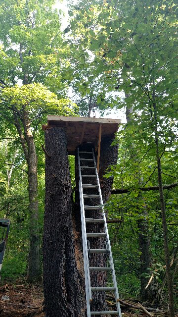

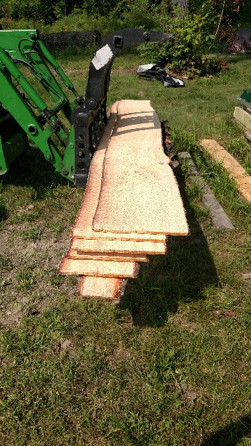

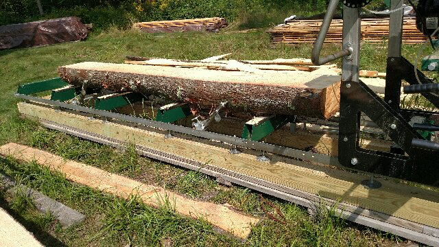

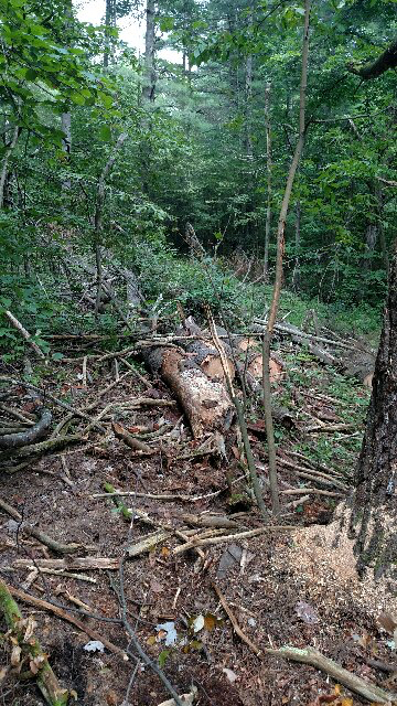

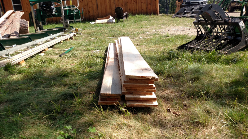

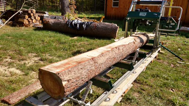

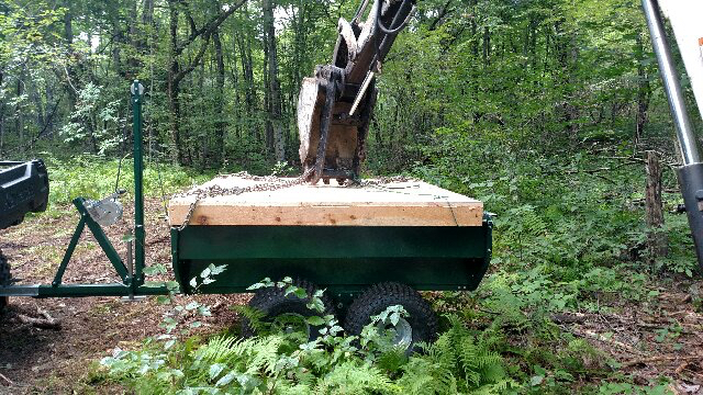

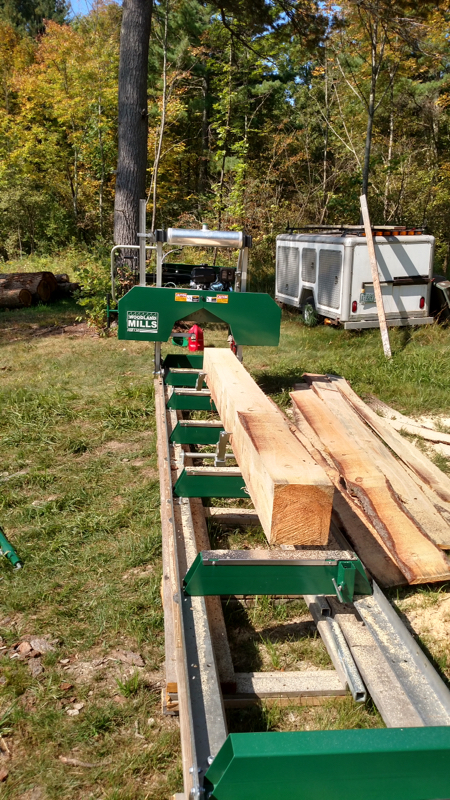

So, A large white pine had 3 of its 4 trunks snapped off during a severe storm last year. They snapped at about 30' high. It is 10 feet from a tree stand that I like to use for deer hunting. I came up with an idea to cut the remaining trunks down to 15' and use the base for a hunting blind. Because of this severe storm which took down 50+ trees, I became an amateur logger and sawyer. I have been milling lumber for the past year and will be building it out of the trunks that fell out of this tree. The remaining trunk that withstood the storm was 100'+. Just got started this past weekend on the prep and build. I get up to the property once every other week. So, it will be a slow go. Time for pics. Milling some of the floor boards and siding. I am going to go with a live edge siding look. image-1287627848.jpg image-3289242797.jpg image-3338765512.jpg image-2110368536.jpg image-1214564295.jpg The site after a little clean up. Still have some more to do. image-4291981526.jpg image-3040307604.jpg Getting the base up onto the 4 trunks. image-1924413149.jpg image-2790915020.jpg The base is attached utilizing Simpson hurricane straps and flat strapping used to connect floors in new construction. The blind will be 6'x6'x6' high with a ridge roof 8' high.

Maybe it's different up there but down here in the South in less than 2 years the only thing that would be left of that pine stub would be the heart or as we call it Fat Lighter and all your work on that nice platform would be for nothing as the rest would have rotted away.
   / Elevated hunting blind project.
Here they will last a long time. The base of that tree is 6' across. But down the road I can always add posts from the ground to the platform.

Hmmm - - don't realize how truly big those two remaining stumps are until you see the ladder leaning up against them.

Looks like a fun project that I'm looking forward to following. Do you have any fear of heights? Putting the roof on would terrify me
"Fat lighter"? Huh, how 'bout that! I learned something new today!! Fatwood - Wikipedia
I thought you were talking about a Djeep or a Zippo compared to a Bic.
The platform covering the "stumps" should help a lot. But eventually insects and the peckers boring for them will compound. I suspect it will take awhile, maybe a decade or so.
There are actually 4 stumps between 18-24". It was quite a tree.
I was a roofer from the age of 17 till about 5 yrs ago when I closed down the company. So, I better not be. Lol.
