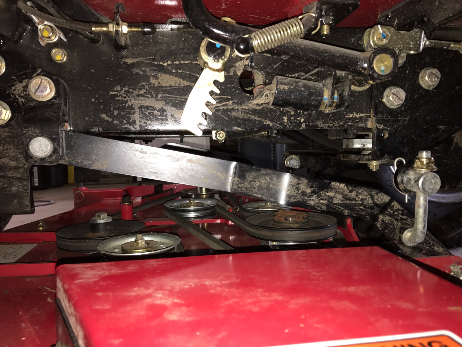

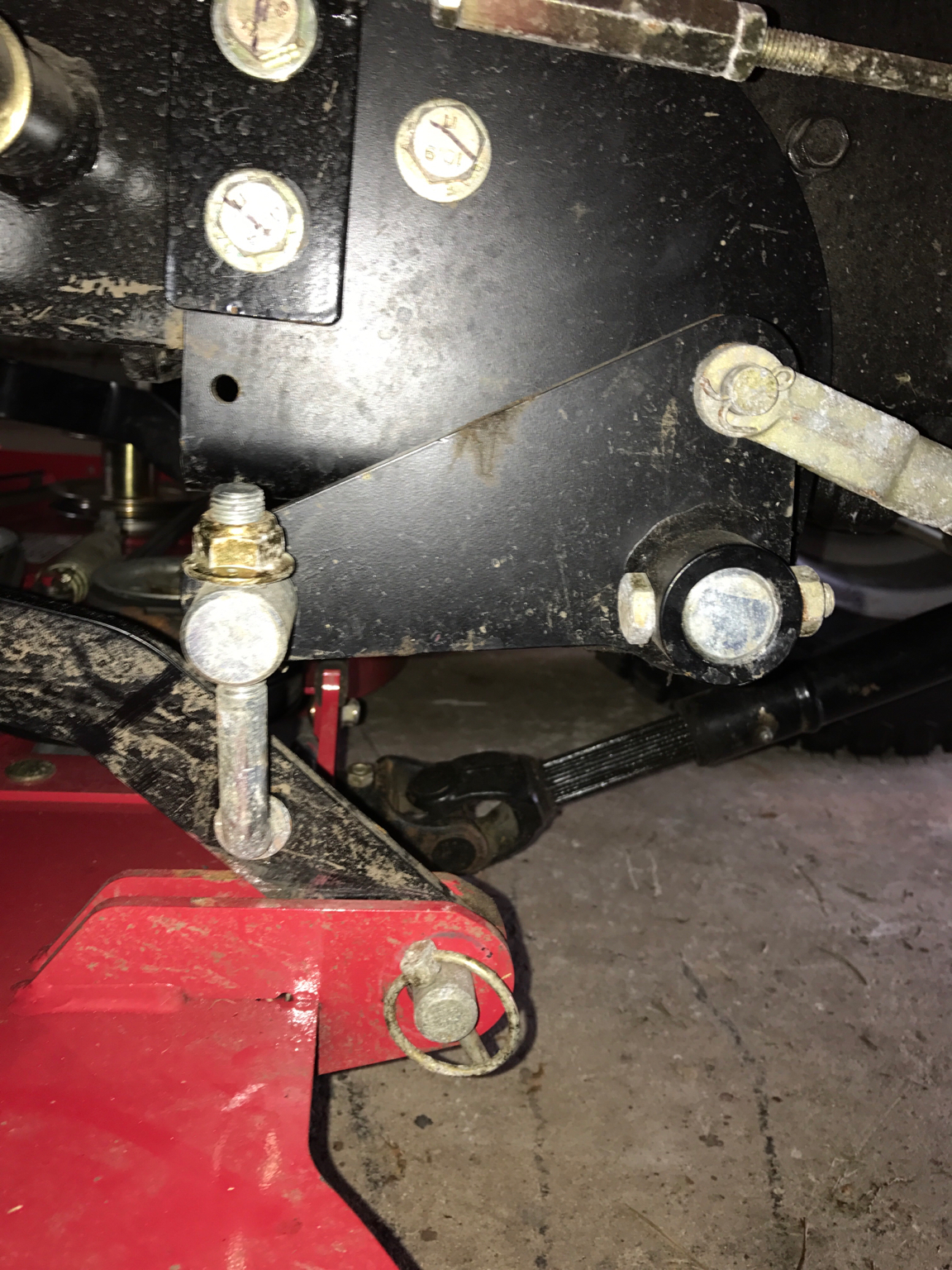

Ok I installed my mower deck on my Emax 25 today. Put the height adjustment knob to install. Lower your three point hitch all the way down and shut tractor off. I had to use a pry bar for a little leverage to move this bracket down to install the pin. IMG_5896.JPG Then put the pin in the front of the black bar on mower deck. IMG_5898.JPG Move to other side and repeat. Then attach the front carriage to the deck then to the tractor. And finally I find it easiest to lay on the ground behind the tractor to install the mid pto shaft. I hope this helps you. If you have any questions give me a shout.
