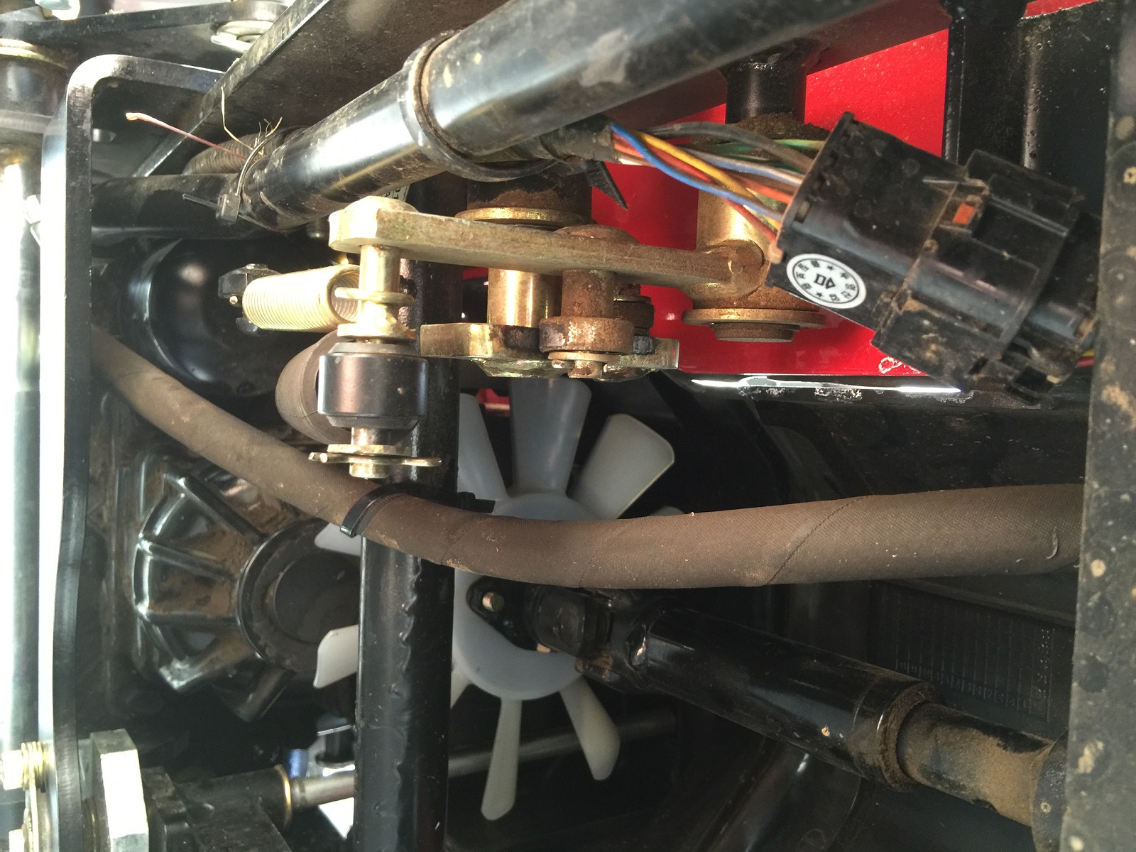

I posted something about this before. My tractor pops the PTO 7.5amp fuse. I sent it to the dealer and they didn't find anything. Just replaced the fuse. Used it for around 3weeks but now without turning the PTO on the fuse pops. I avoid using the brake since from what I can see on the diagram they are connected? Any idea what I should be looking for. Any help would be appreciated.

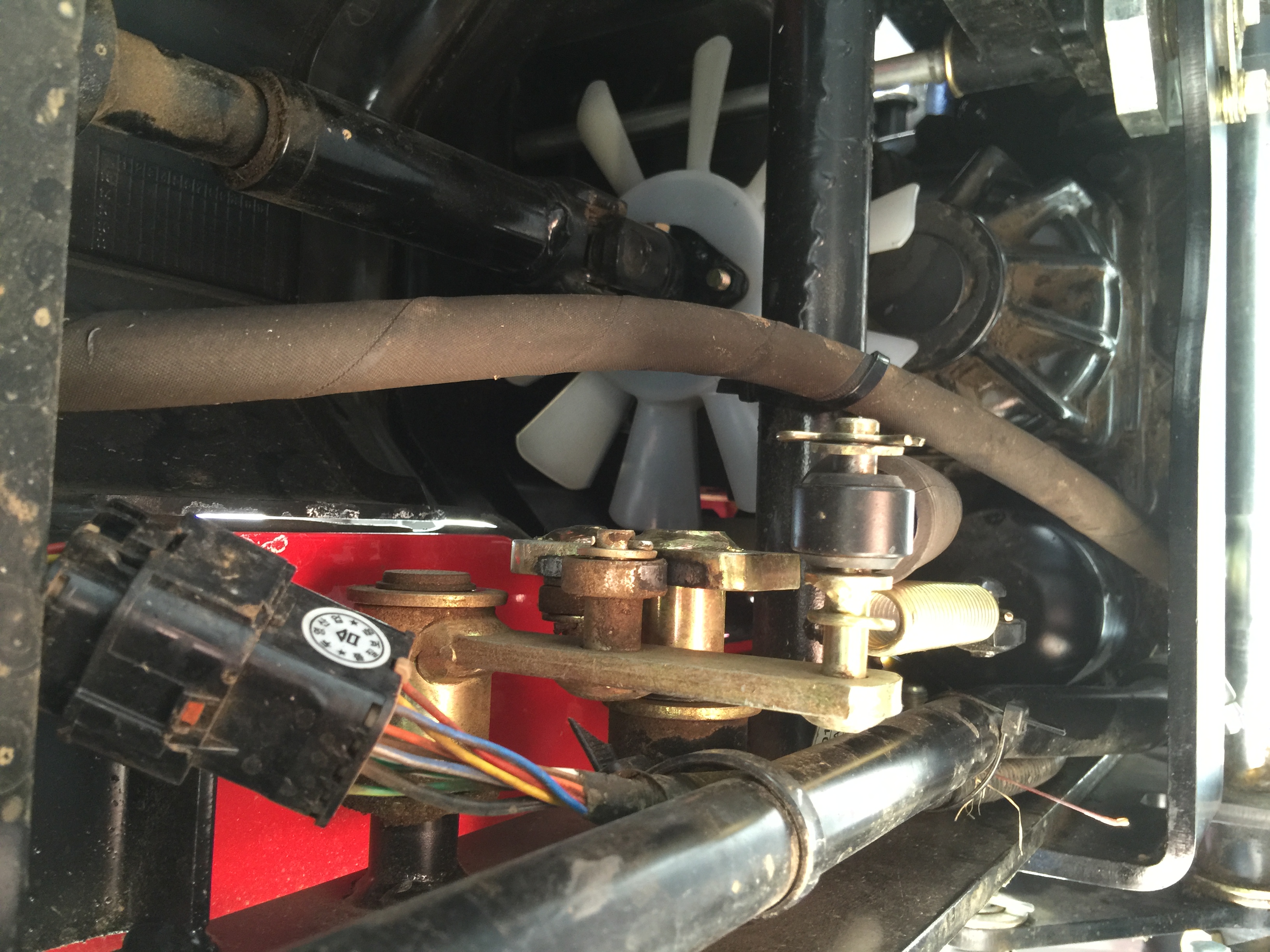

Here is the update. Where the front harness connects to the rear harness just before the plug, there is no wire loom. From the shaking of the machine in general it wore through the wiring at the frame and caused the short. When the key is turned on or off there is a split second when power is applied to the dash and all the components. Didn't realise this at first but it does. There needs to be some insulation at the plugs,harness when it rubs the frame. Check your tractors before it wears through. Thanks for the help guys. I appreciated it

Question for you gtmahindra: Was it the wiring above the harness plug(s) {which would be above the area shown in this picture) that was wore though?
