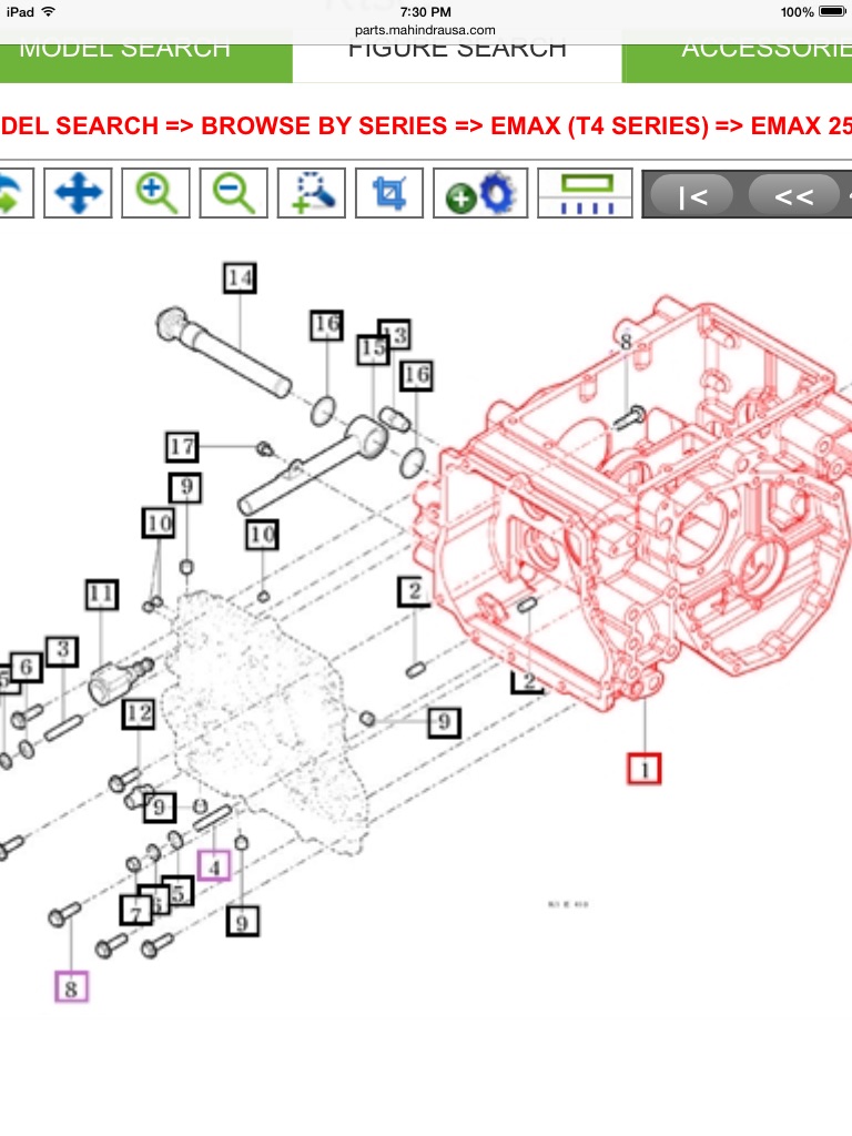

They suggest you replace the suction strainer which is pretty expensive and it can clearly just be cleaned as it's just a screen, furthermore they left out the location and procedure in the manual as well. I had to search through the transmission parts diagrams online just to locate the thing. In case the filters are ordered and in the mail, bought a couple to justify the shipping cost.
