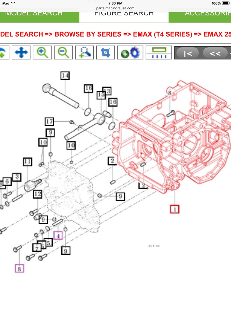

I've got an emax 22 hst. I haven't yet figured out where the suction strainer is located, or what is required to get it out ?. Can you describe the location and how to get it off?

In the rear transmission part schematic its part number 14
http://parts.mahindrausa.com/dealerview/illustrationview.aspx
Removal is simple, just unscrew it, I believe it's around a 1" bolt head. Just clean it and reinstall, I did find a bit of shavings on it from break in btw, of course I've found the same on many motorcycles post break in.

Suction strainer is on right side just below the 3-point lift valve. Follow the supply line from the pump up front.Remove the hose clamp from the connector hose. Remove the tube line mounting bolt. 12mm I think. Then remove banjo bolt from the tube line. Watch for the o-rings on ether side.

The link you provided takes me to a Mahindra online parts lookup but requires a login/password. Is this for dealers only as it doesn't allow me to register for an account? Any chance you could take a screen shot of the page and post it?

image.jpgPart 14
